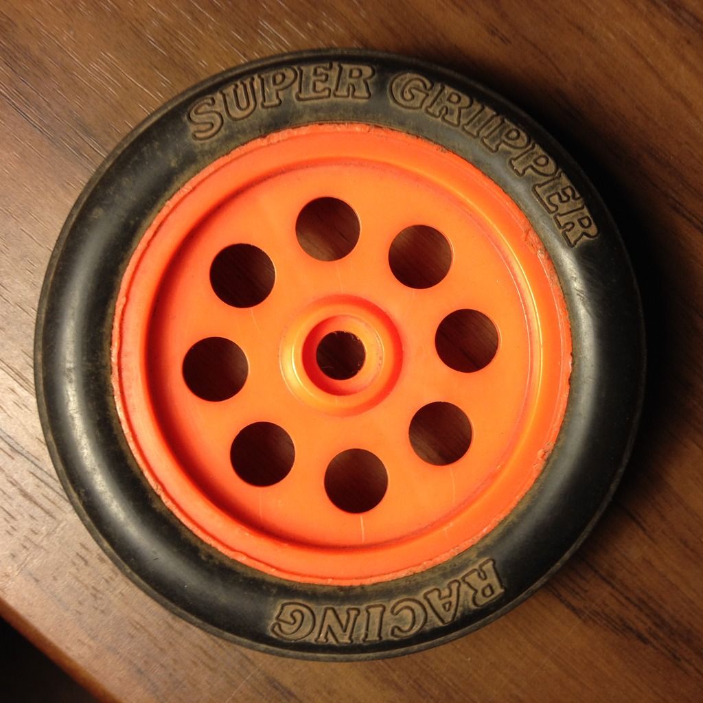

What is the best source for glycerine otc in the US?

100% pure silicon oil is the answer for reviving/preserving, darkening tyres. As far as I can remember.
There was a massive thread (many pages, even scientific debate) about this issue here some years ago, and from memory this was the most safe option for treating tyres, as it cannot hurt the tyre material. I have used it in the past and had no issue.
So just look for some silicon oil - eg R/C damper oil. Make sure it is 100% pure silicon, and of a fine/thin grade.
If you want to pick up glycerine, you can get a quart for ~$13 off Amazon. You can also pick it up in most pharmacies (often behind the counter), but it can be quite pricey for the amount you need to submerge a few tires.
FWIW, I have tried glycerine on some old Hotshot tires with little effect. I assume it's because those are a very hard/plastic-like rubber. Softer rubber may absorb it better. Also, glycerine will evaporate over time...
Good luck either way!
Has anyone tried automotive tyre shine spray ? It would make a mess if sprayed directly at the much smaller tyre but it could be sprayed into a shallow container and painted on. Not sure if it will harm old Tamiya rubber though ! I tried Meguiar's Hot Shine Tire Spray on an old set of Super Hornet (edit: Fox tires on Super Hornet wheels, lol) this way and this was the result after cleaning and applying the spray with an old modelling paint brush then wiping off the excess: (There is no damage as far as I can tell)

I wasn't looking to shine them, just soften them and get them black again.
I think I will try some of leather conditioner I have for my 328, maybe that will get some oils back in the tire.
I will post some before and after pics of the results.
