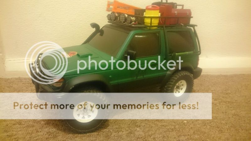

Those are the ones both myself and XV run on our Pajero's, they work well with very little rubbing only on full lock / under full compression. I've since bought some 1.55s but these rub even more :( will have to decide if it's worth it for the looks.
Nice, add another TC'er running them on his CC-01! So I guess they make the Kongs in both 98mm and 90mm then, eh?
Bummer about the 1.55s Which ones did you get?
These ones -
But I'm going to have to get the dremel out on the arches, something which is not as much of an issue on lexan shells. Can't wait for an.opportunity to take it out now!
