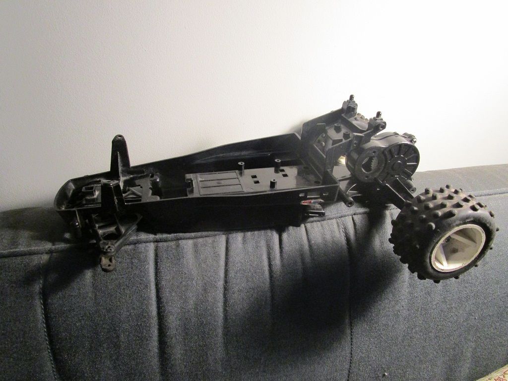

Okay, I just started this project here. It's a cheap (and hopefully QUICK) runner car I'm building from a bathtub chassis I have had for years and to date I refused to throw. It's got one front shock tower (left) broken, and a crack on a rear mounting point. Other than that it is just worn and old.
BUT I can make it run again.
Well, I've decided to replace the front shock towers for a one-piece aluminum piece, inspired obviously by the aluminum ones that CRP used to make for the Hornet back in the day.
Here's some pictures of the chassis. Not sure what these tires are.

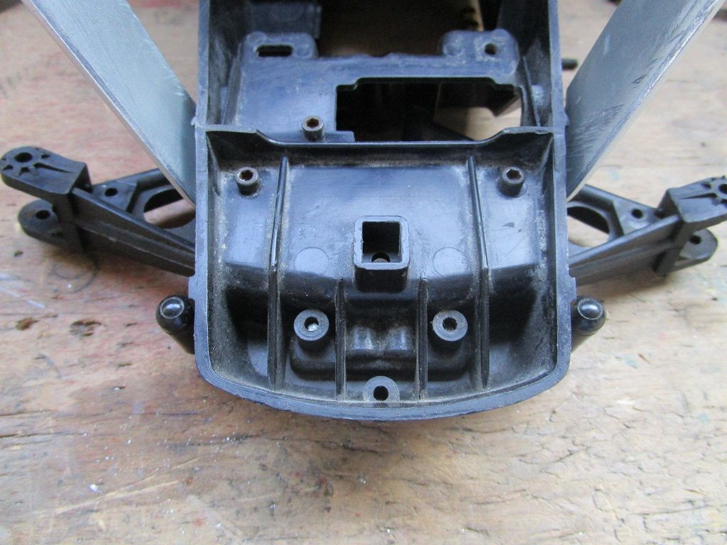

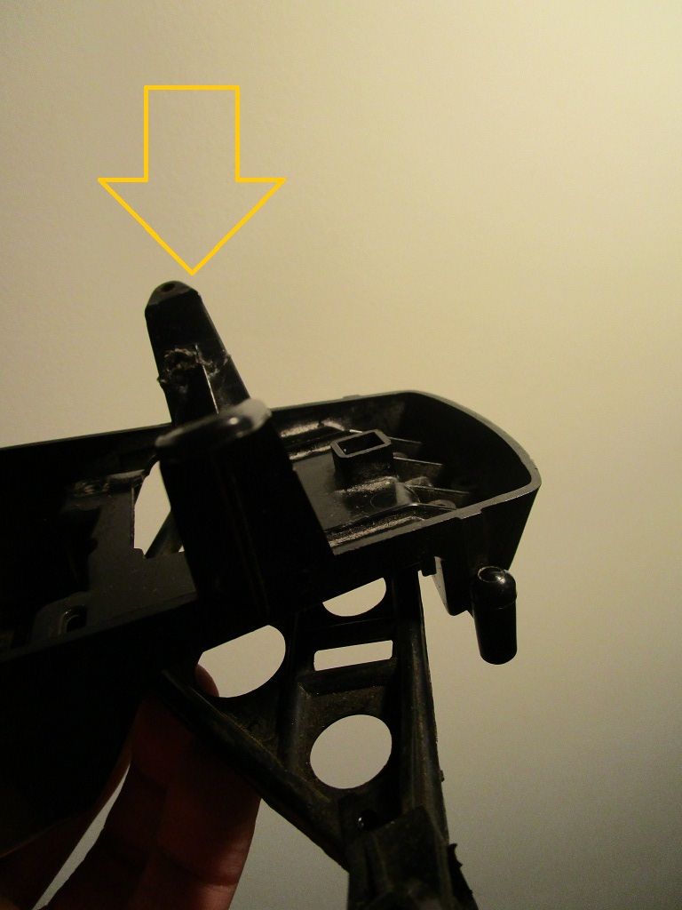

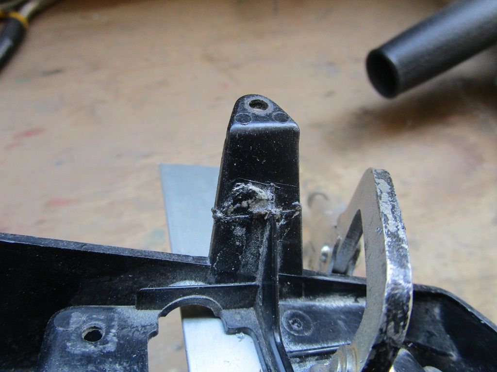

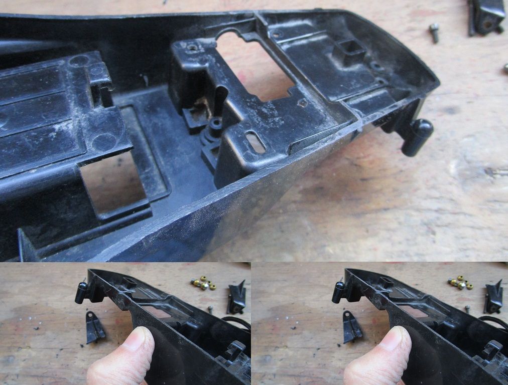

And the issues. Here's the broken shock tower. Note the Rockbuster suspension arms. It's the only thing I had to make this thing go.
IMG_4806_zpsf8wdtimz.jpg?t=1450306165

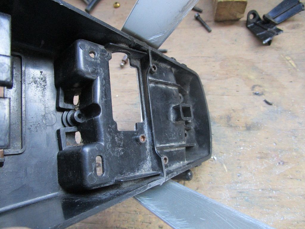

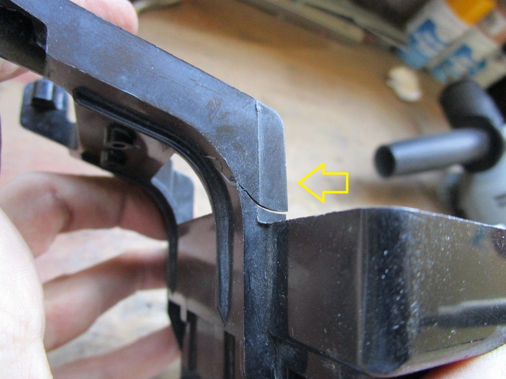

The cracked rear bit. I'm not sure how to fix this yet. I think the front issue would be a bit more "demanding".

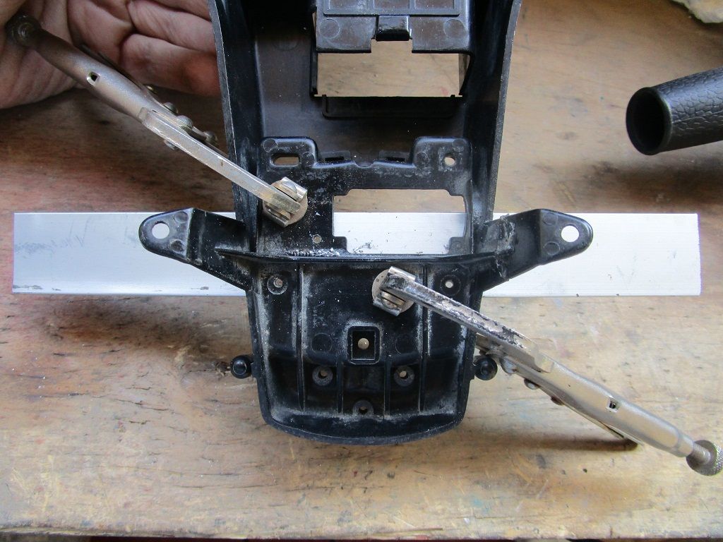

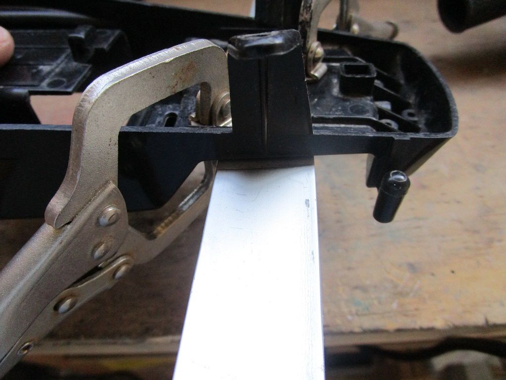

Here's the clean cut, alright.

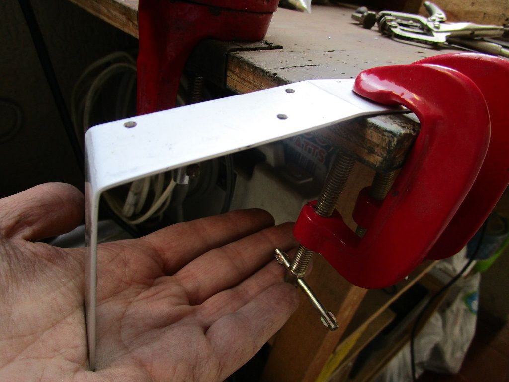

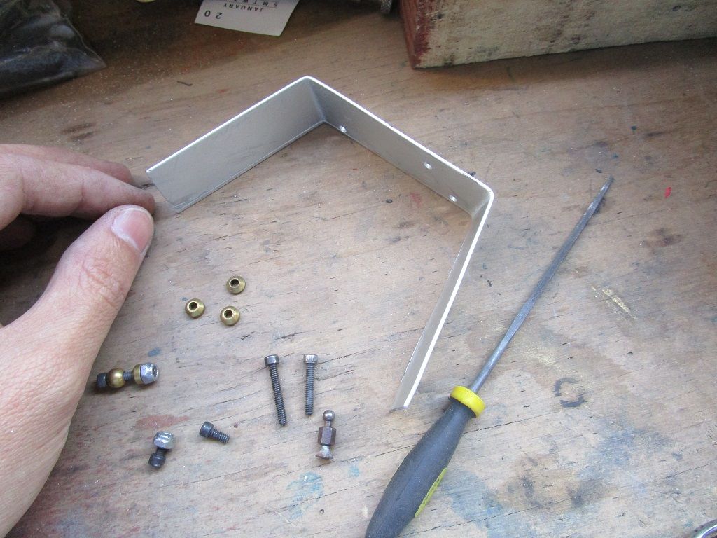

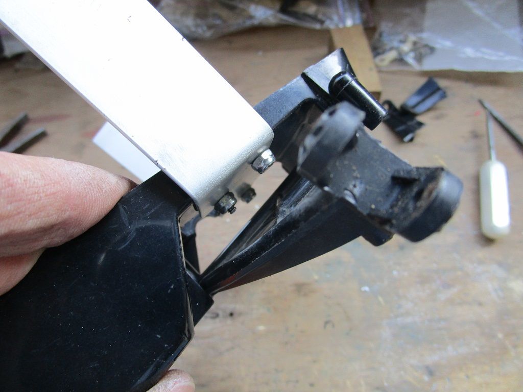

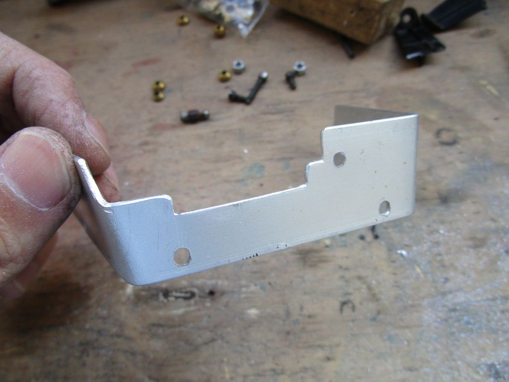

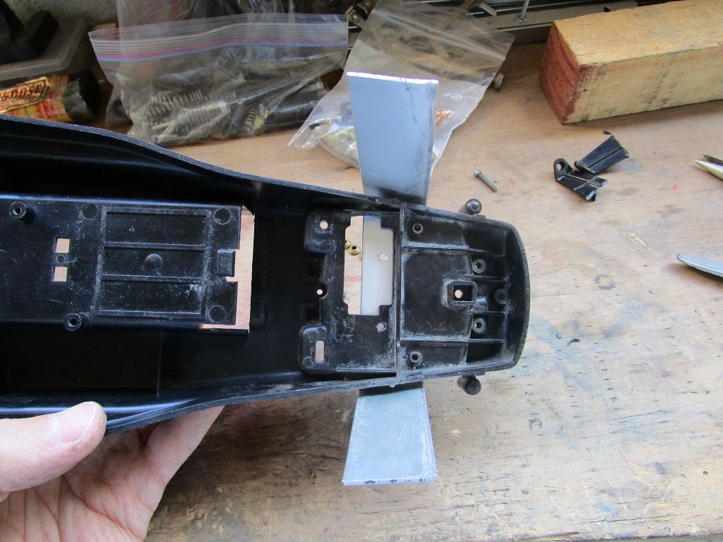

And here's what I did to the aluminum piece I got. After doing some measurements and cutting, I had to place it where I wanted it to go. Then I drilled three holes, bent the aluminum piece cleanly, and finally bolt it onto the chassis. Now I have to figure out what shocks I'm going to use. Of course, once I get it all shaped and ready I'll paint it all black. I think it's going to look fine in the end.
Okay, here's the custom aluminum shock tower properly bent and really to be installed.

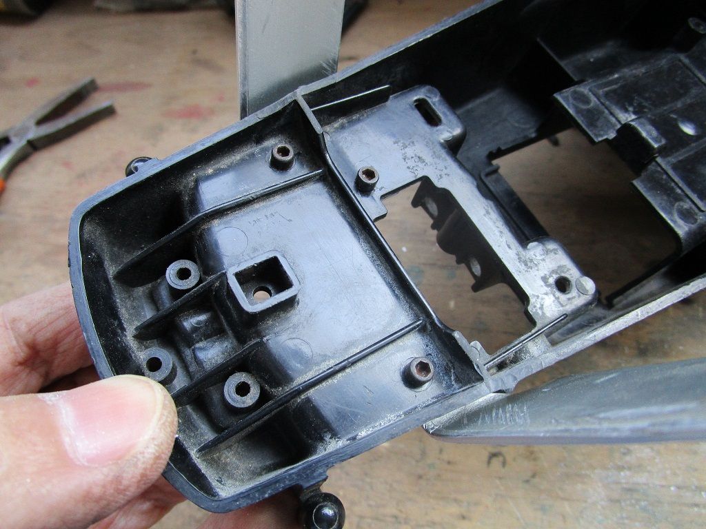

Okay, here's the custom part mounted and some minor mods:
Some detail to make it fit alright.
These are the Rockbuster arms.
RC10 locknuts. It's the only thing I had sitting around in here to use.
Shape fits alright the bathtub chassis.

That is exactly how the old CRP front shock kit for the Grasshopper/Hornet was installed, cut off the stock towers and bolt an aluminum bit on. (edit: never mind, you said that already. I should read, and not just look at the pictures...) Looks like a good start! Always love a "recycled" build.
Thats awesome!! For the rear mount try roughing up the surface and filling it with epoxy, should hold for a while. Let me know if you need anything else for this project, got lots of Hornet/Grasshopper bits.

Anyway, here's the finished shock tower. Now waiting for the enamel to dry so I can mount it on my buggy. I like it, I think by doing this one I learnt a lot and next time I need one of these it's going to be much easier for me to make one.
