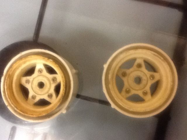

Hi there Craig,
Thanks for wanting to help! :)
Anyway, the GH2 uses one-piece wheels. The ones you can see in the pictures here belong to the original GH and they're three-piece wheels.
Have a good one! ;)

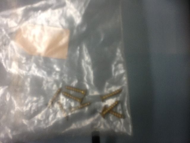

Sorry, should have explained that better. I've got some rear grasshopper wheels with the bolts in. Plus I've a bag of small screws. Although looking at them not sure if they are the right ones. Your welcome to the screws and wheels if you want them. Won't be using them myself.

The self tapping are definitely the wrong ones for the wheels. The ones for the wheels are 8 or 10mm machine screws with matching bolts.
