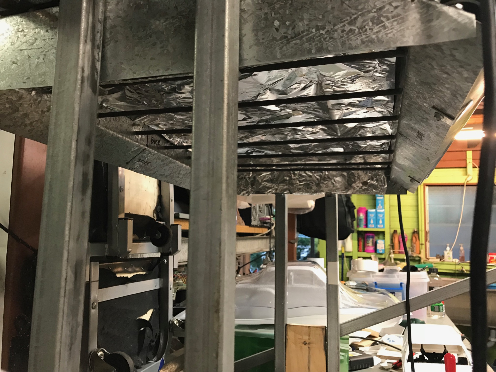

small update, I was having lots of heating control problems, getting either too much or not enough heat. Plus the heat was even, heating too much on the left hand side. After looking into how I made the heater box, I realised it wasn't wide enough and there wasn't enough heat getting to either the front or back of the frame.
So I rebuilt the heating box, making the outside of the box greater than the frame. I was initially going to buy longer elements, but ended up using the existing ones and just flaring out the base of the heater box. I made the gap between the elements and the top smaller too, plus adding in some reflective aluminium to try and bounce down a bit more heat.
My first test was using 2 mm thick HIPS, I'd been having lots of issues with HIPS before. Not perfect, but better than what I'd been getting lately. Good to see no webbing.

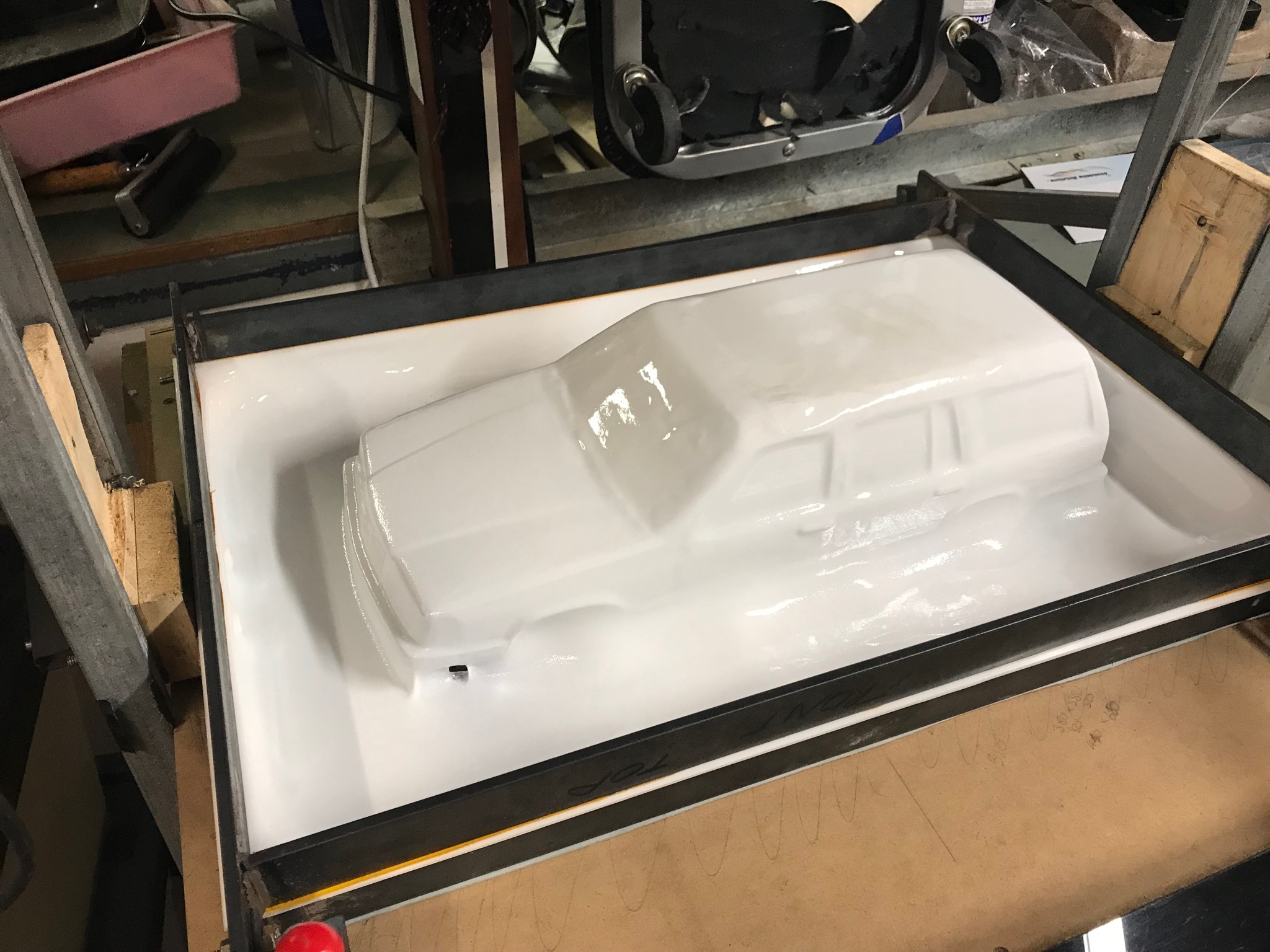

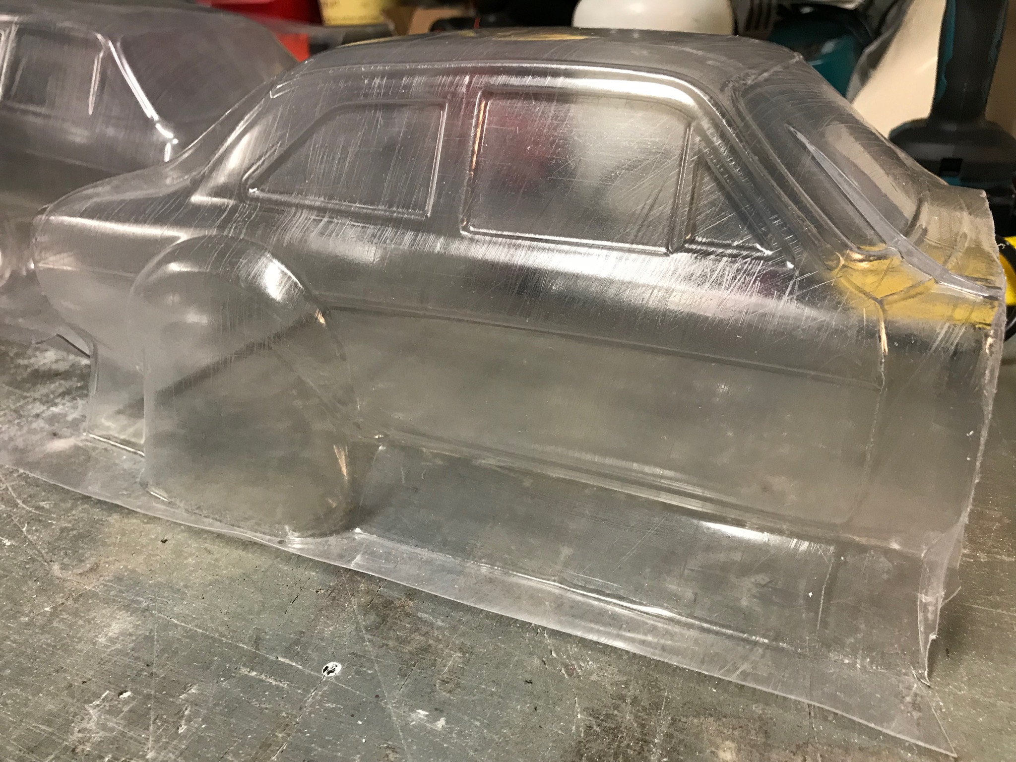

So I decided to give my Volvo body a go. Its not ready, and its pretty rough, but with a body I can do a test fit. Too much undercutting of the body meant the plastic blew out before it would completely form. But it shaped the body, contouring over all the bits I need to sand and smooth out :unsure: It would probably make a good banger body though.
The basics line up ok, and the width is good, just have to make the wheel arches bigger.
So I then gave some 1.5 mm Lexan a go. I ended up overheating it and it stretched too much. A bit hard to tell, but it was still heating on the left side much more than the right side. It was very noticeable when the plastic was sagging.  The thermostat in the two sides must be slightly different, so getting both to heat the same would be almost impossible. Here I also let it sag too much, and it wrinkled on the top of car as I pulled the plastic down.
So my solution to the uneven heating was to re-wire the elements so they alternate and both span the entire width of the heater box. Here you can see it with one set on. This should also give me a lot more heat control.

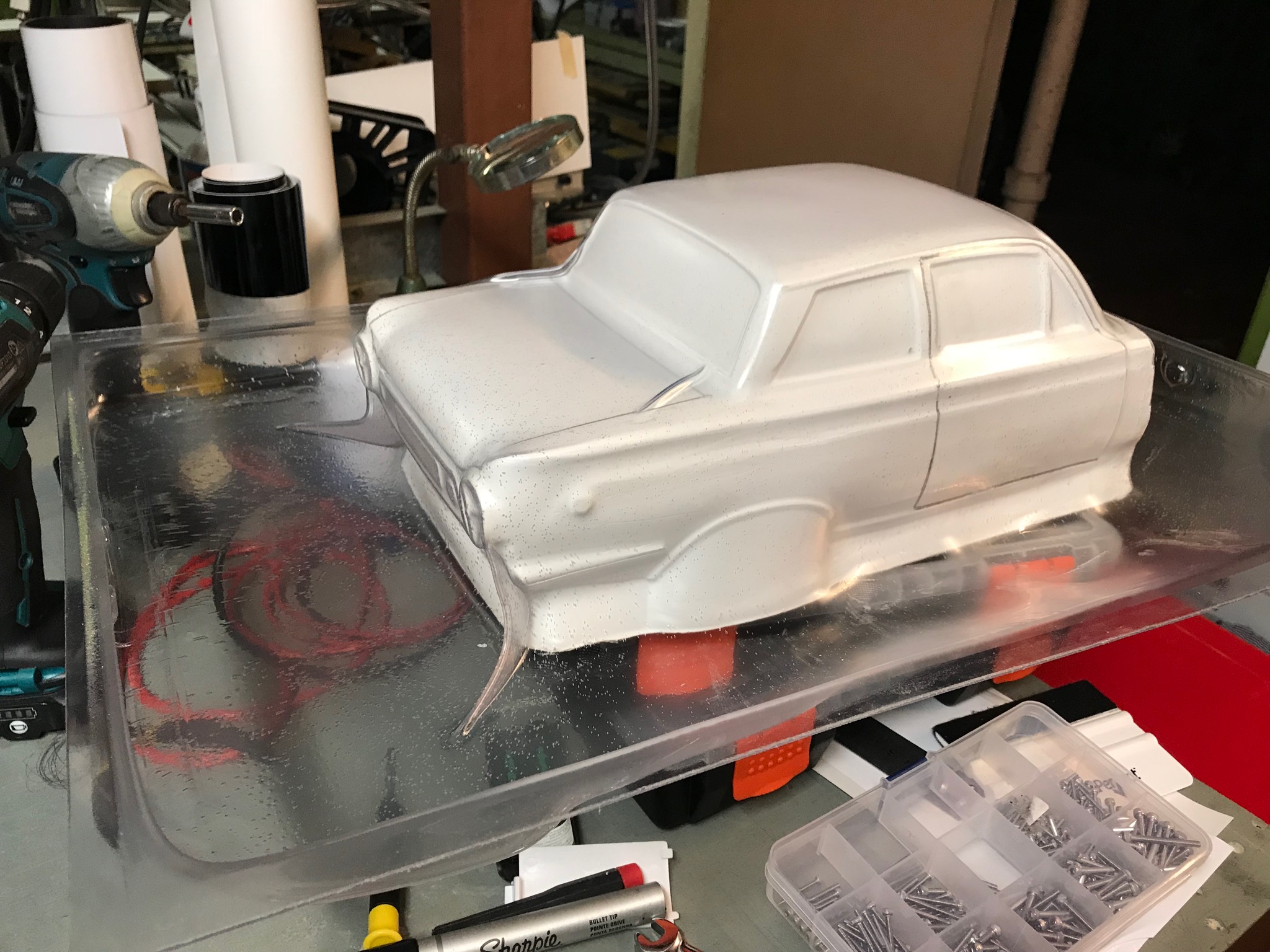

ok, time to get back into some vac forming :D

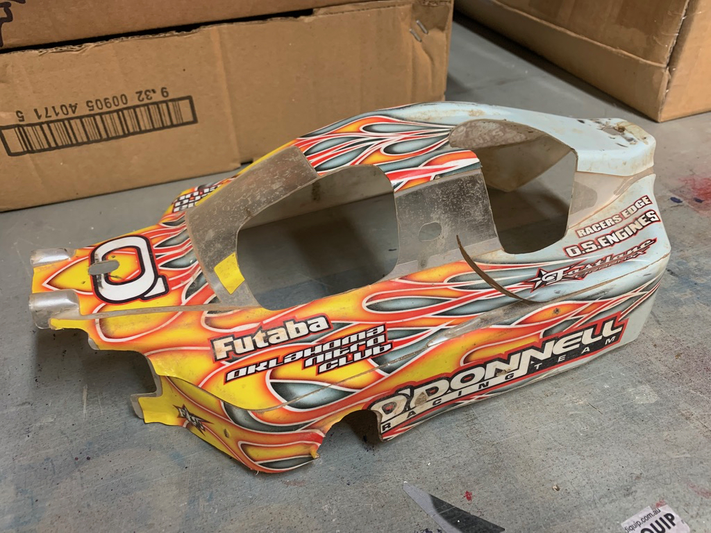

So I'm going  start with some bodies for @Martell , I need more practice at forming bodies and I thinking they might be a little easier to try than the Ford bodies. The do have lots of holes though, so that's going to be a challenge.

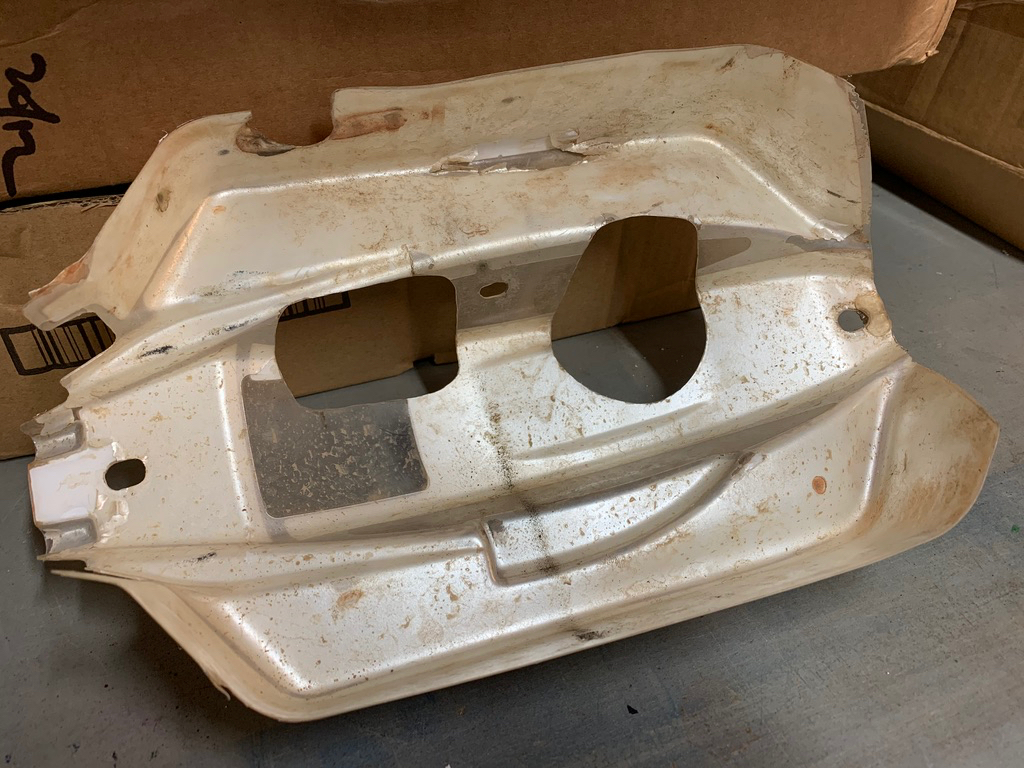

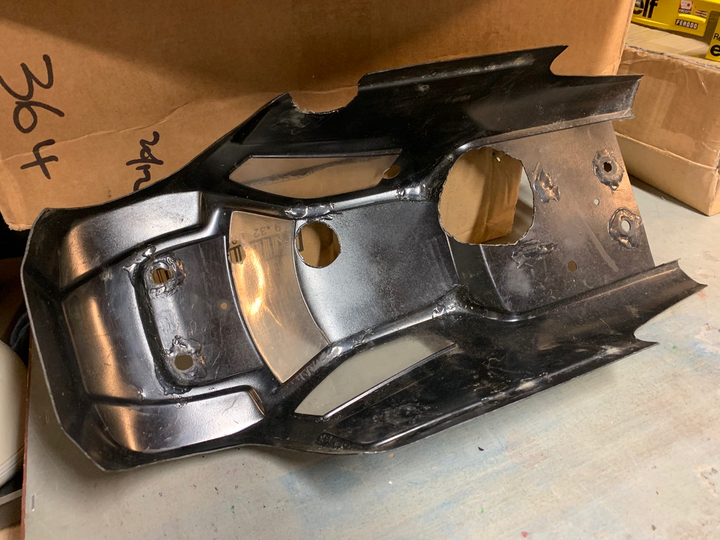

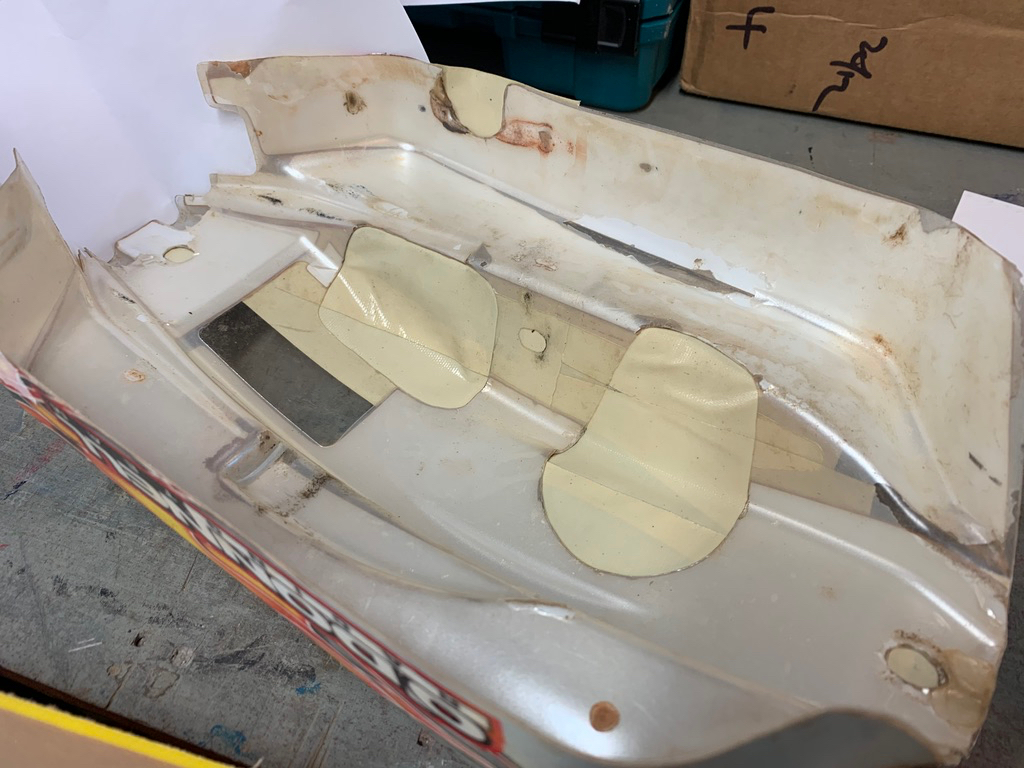

So the bodies, apparently old Proline ones. This one actually feels thicker than a normal vac formed car.
The inside will pose some challenges I wasn't expecting. All the bits of glue used to strengthen the post holes will have to be filled in once a cast is taken.
The Second body, this one fells kinda soft and more flexible, I'm wondering if its a different plastic to polycarbonate. Again lots of big holes to cover.
So both bodies where given a good wash. I'm probably going to try casting these a couple of times as well and what to use methods that don't damage the body.

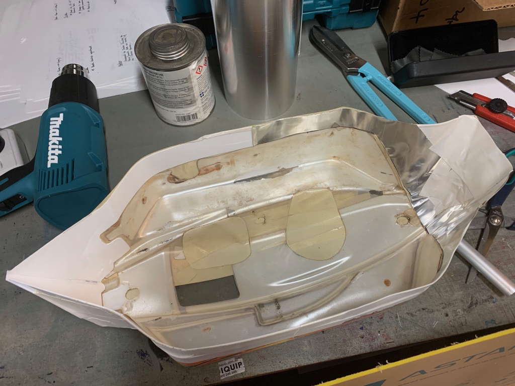

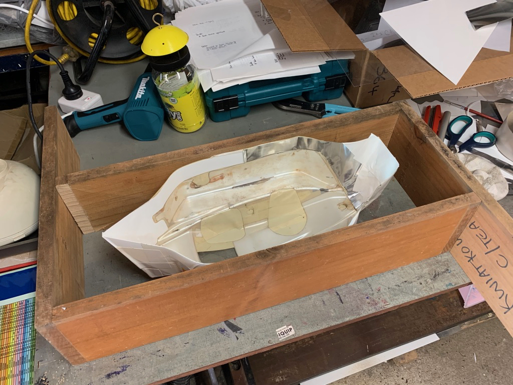

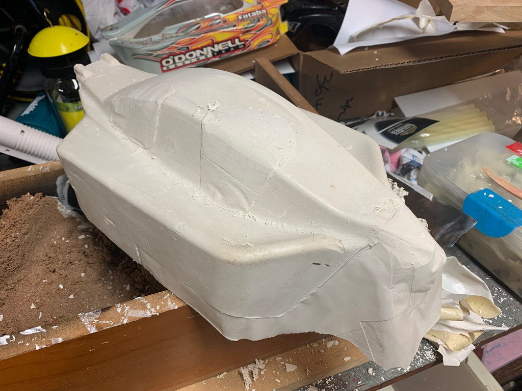

ok, so starting with the Futaba shell, attempt one will mainly use cloth binding tape to cover holes, with some plastic or metal cut to extend the base at least another 10 mm.

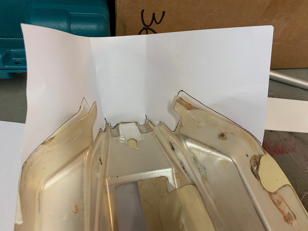

This is an easy way to get the basic shape of the body without try to cut in a piece to fit the curves of the windows.
For the ends, I'll need to make a stronger edge, so that means cutting plastic card to fit in along the edge of the body. I just used paper and traced the edge, and transferred that to card.
Completed both ends. For the rear I ended up using roofing aluminium as it's easier to shape.
So now I can attempt to cast the body. There are a couple of ways of doing this, @firefoxussr mentioned the rotocasting method and this would use the least amount of plaster and given a reasonably thin shell. Thats good for adding in vent holes afterwards and I will give that method a go at some point.

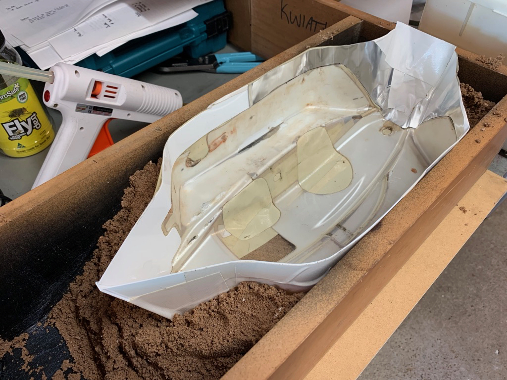

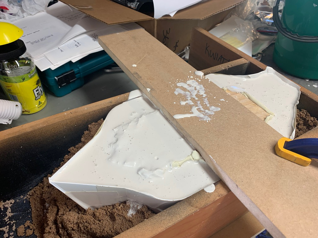

For this particular case, my concern is that the body or bits I've added on could flex, so I'm going to make a box that is padded with sand to hold it firm.

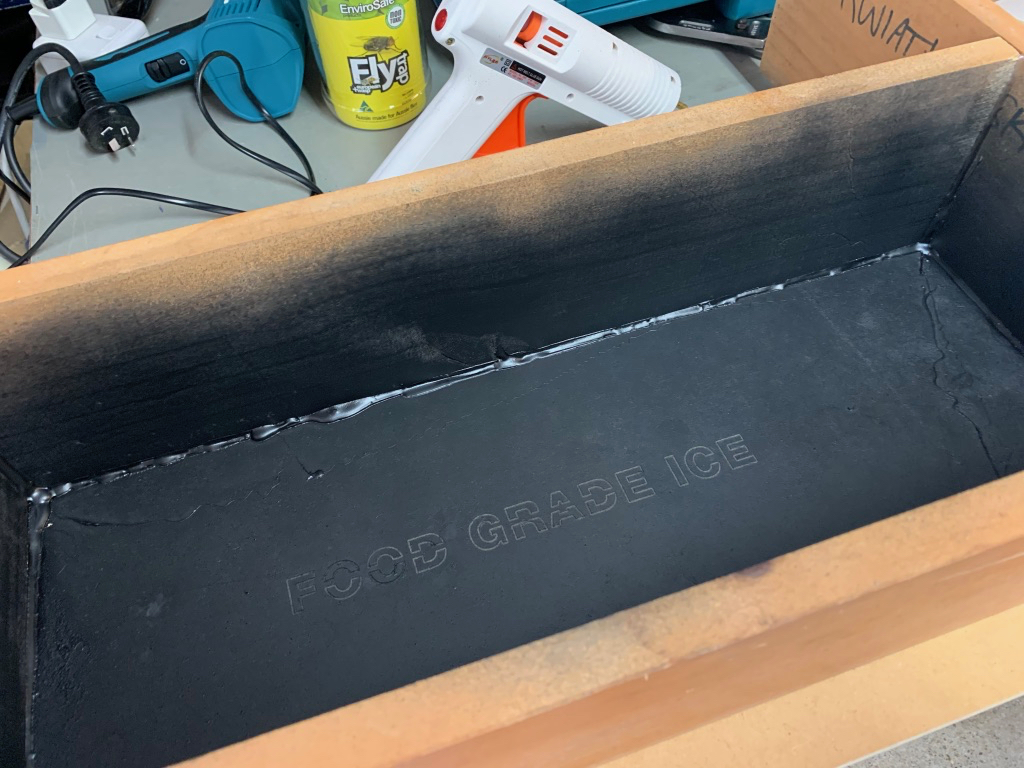

now hot glued together onto a base of MDF. As MDF is not great with moisture, so it's been painted to seal it.
the underneath of the shell is then supported with wet sand, it's just a course playground sand with some added water to make it sticky.

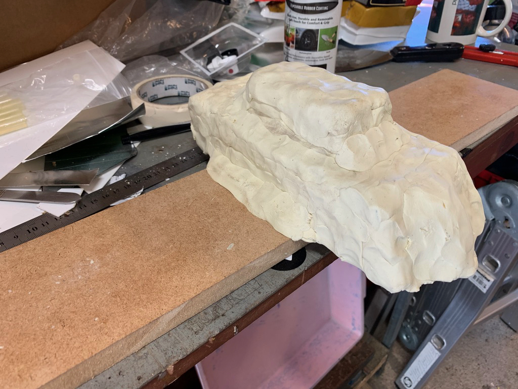

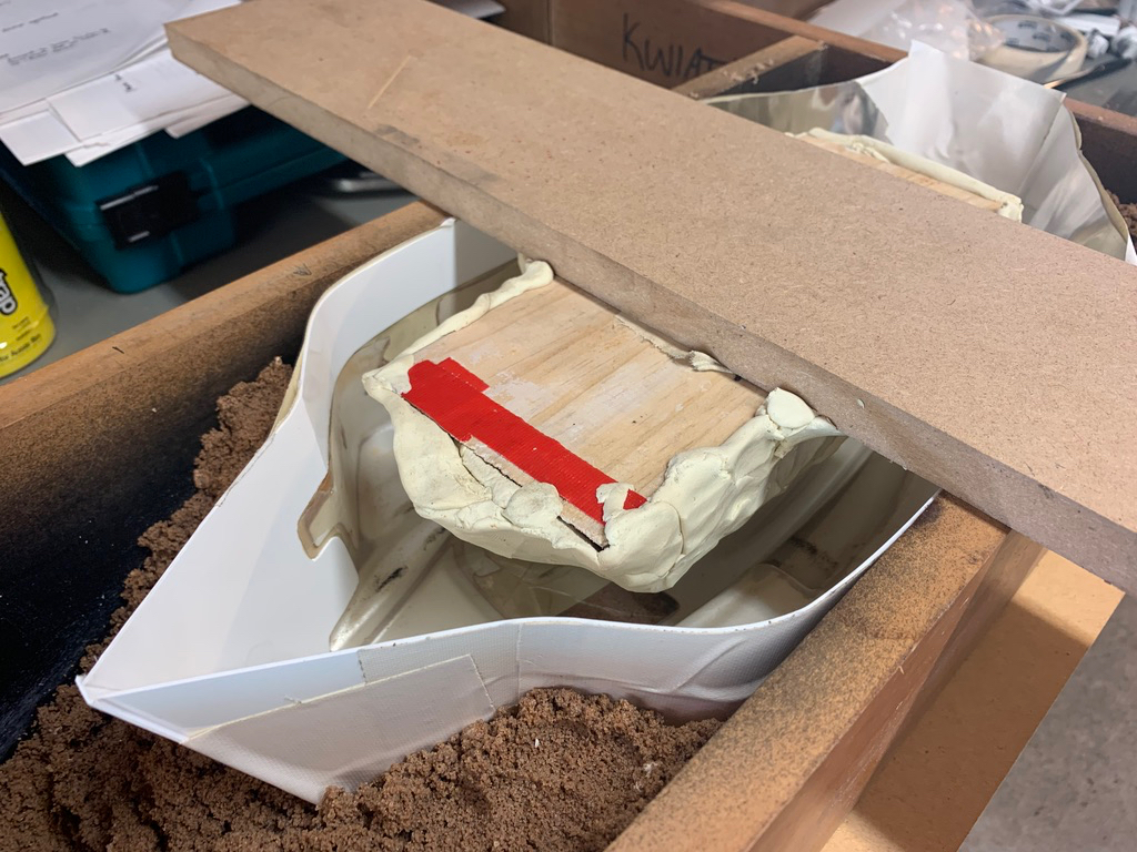

Before I can cast, I want to reduce the volume of plaster needed. So time for some wood and plasticine. The plasticine helps seperate out the wood from the cast and to help shape it a little.

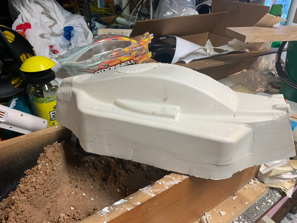

and now ready to pour.
For this attempt I am using plaster of paris, its pretty common and fairly cheap.

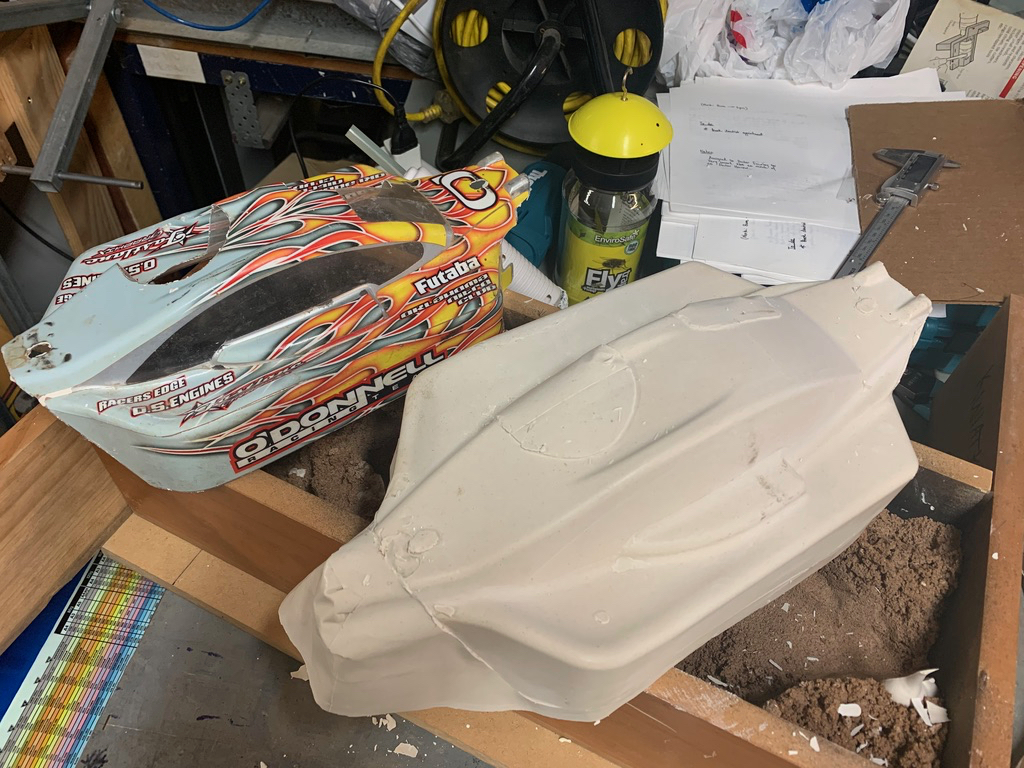

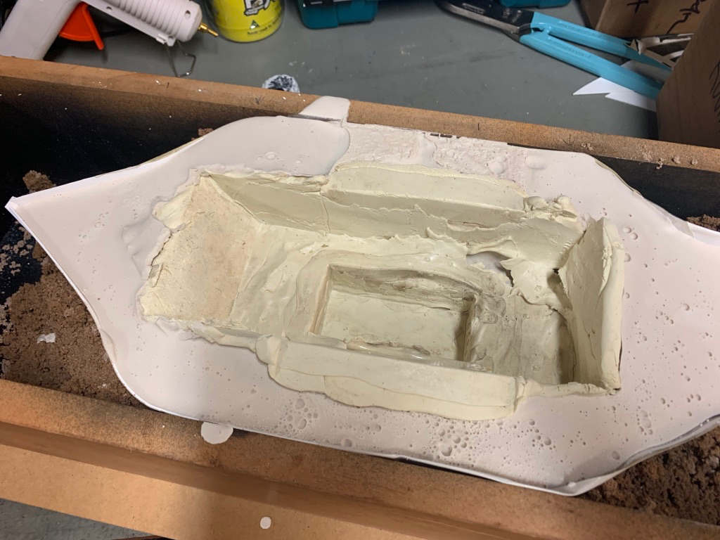

about 2 hours later it's set enough that I can start taking it out.

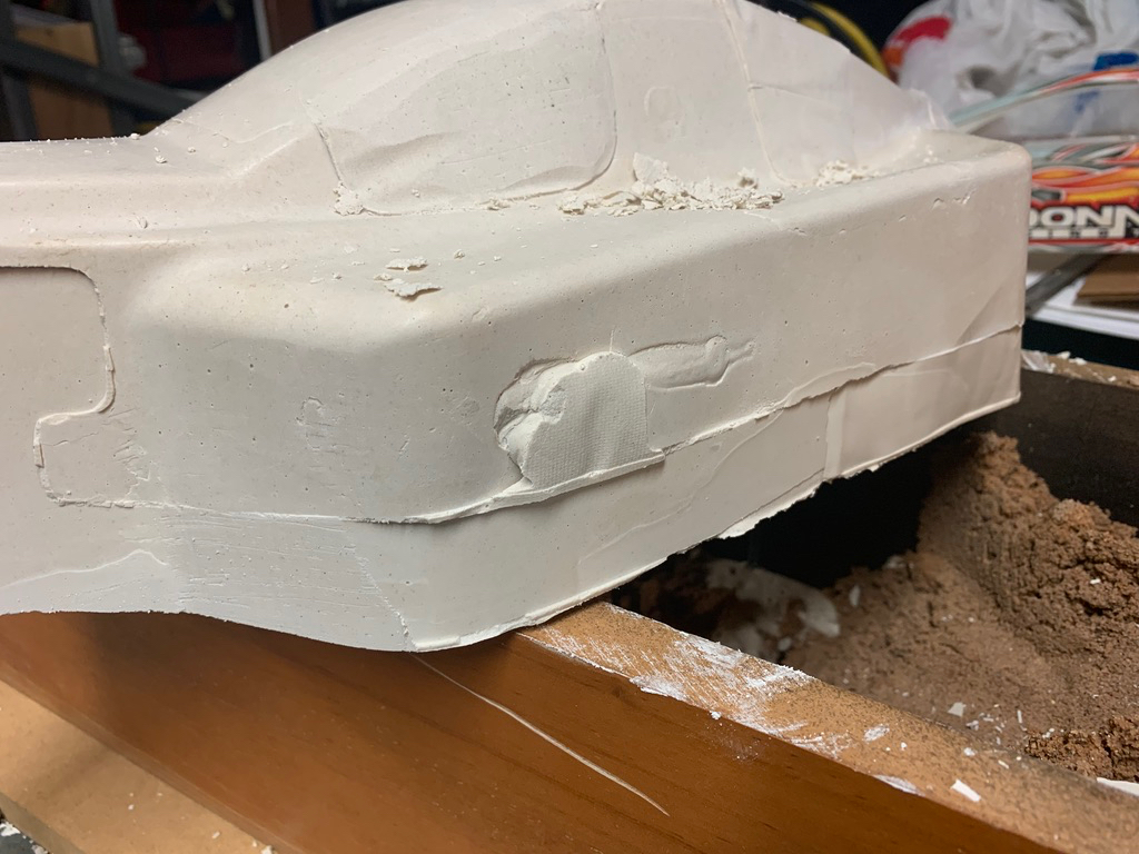

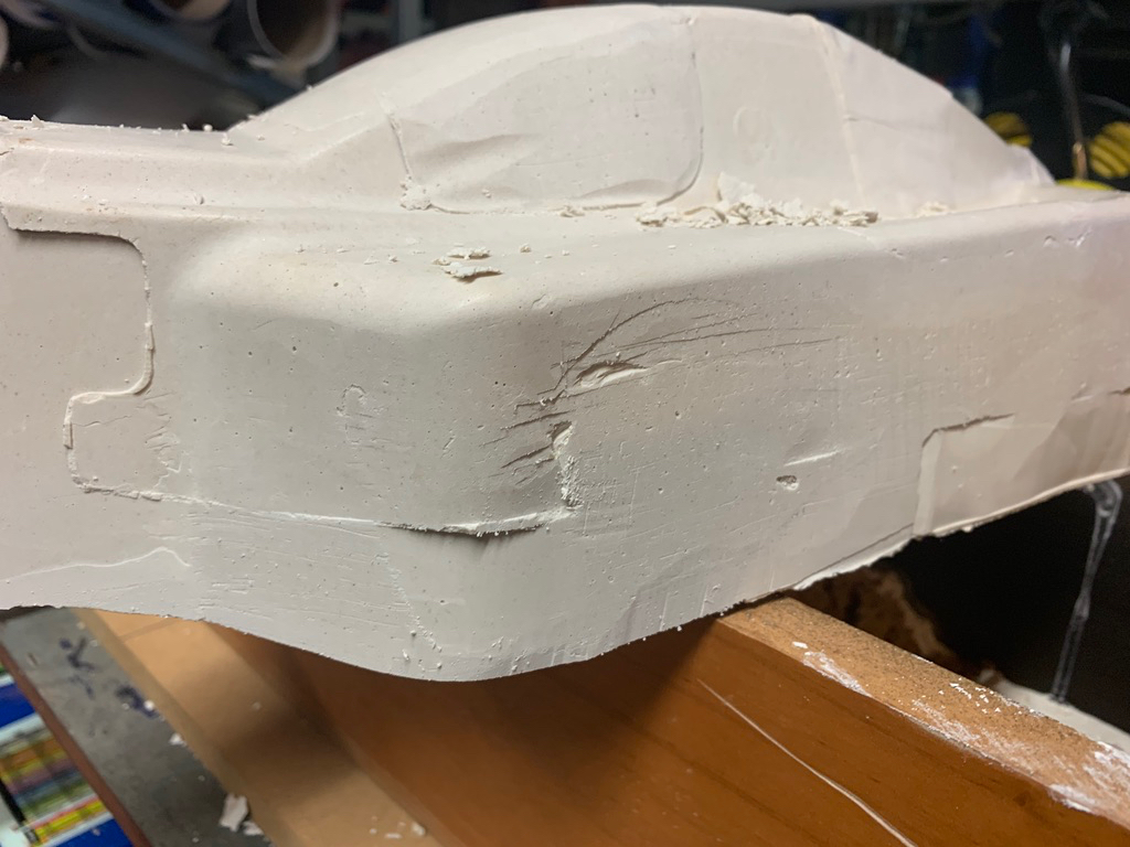

So not too bad, but where the holes are covered up, that will need to be dealt with. I forgot to mention before, when I made up the ends, I did it so they taper away, this is to make vac forming easier.
now to get onto cleaning up the body. While its still setting I used a knife blade to scrape as much of the lumps smooth.
Before
After
This is where I had to stop. So I've still got the top patches to deal with, but I will wait until its set properly and then have a go at sanding smooth. Where there are holes, I'll try either adding more plaster or some clays that I have bought to try.

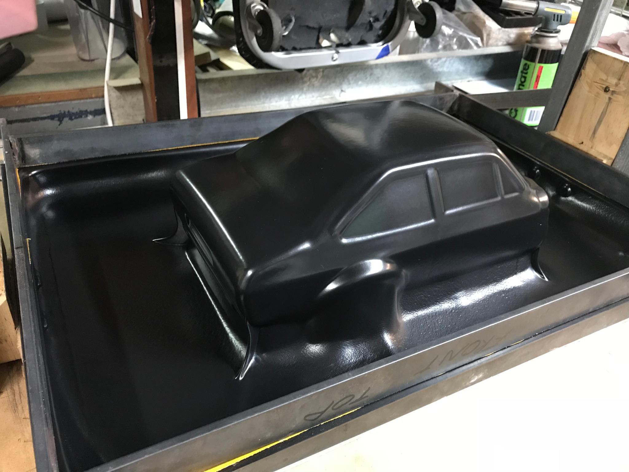

so I need to finish off @Martell s bodies, that I started a year ago :mellow: I was hoping to get to this over Christmas, but that didn't happen. Anyway, an opportunity arose this week with a mate and what better way to get a task done that to pass it off to someone else :D

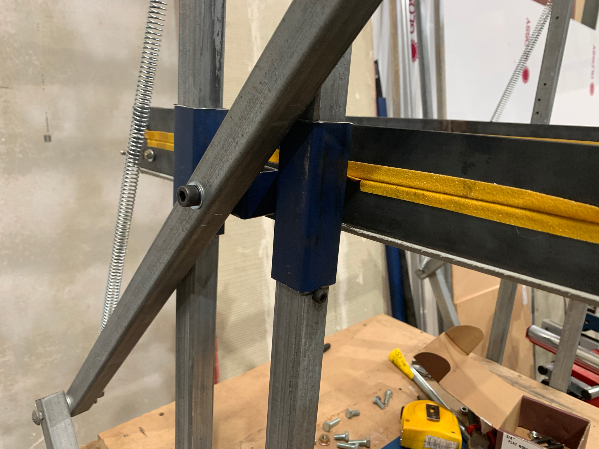

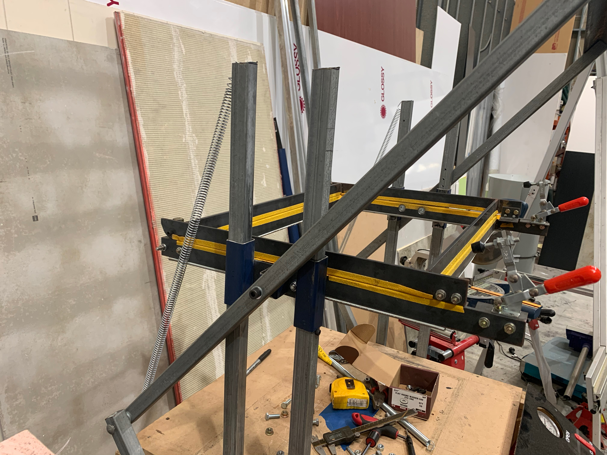

So with the vac former I'd made, I had a couple of issues. I wasn't getting a good seal when forming and the connection from the frame that holds the plastic to the lever system wasn't the best. It had been made of wood which wasn't ideal, so time to bring some metal fabrication in and redesign. The other issue I had was the ball value levers where a bit clunky, and I'd planned on upgrading to solenoids and toggle switches.
So this is the updated joint to the lever system. Much more solid now.

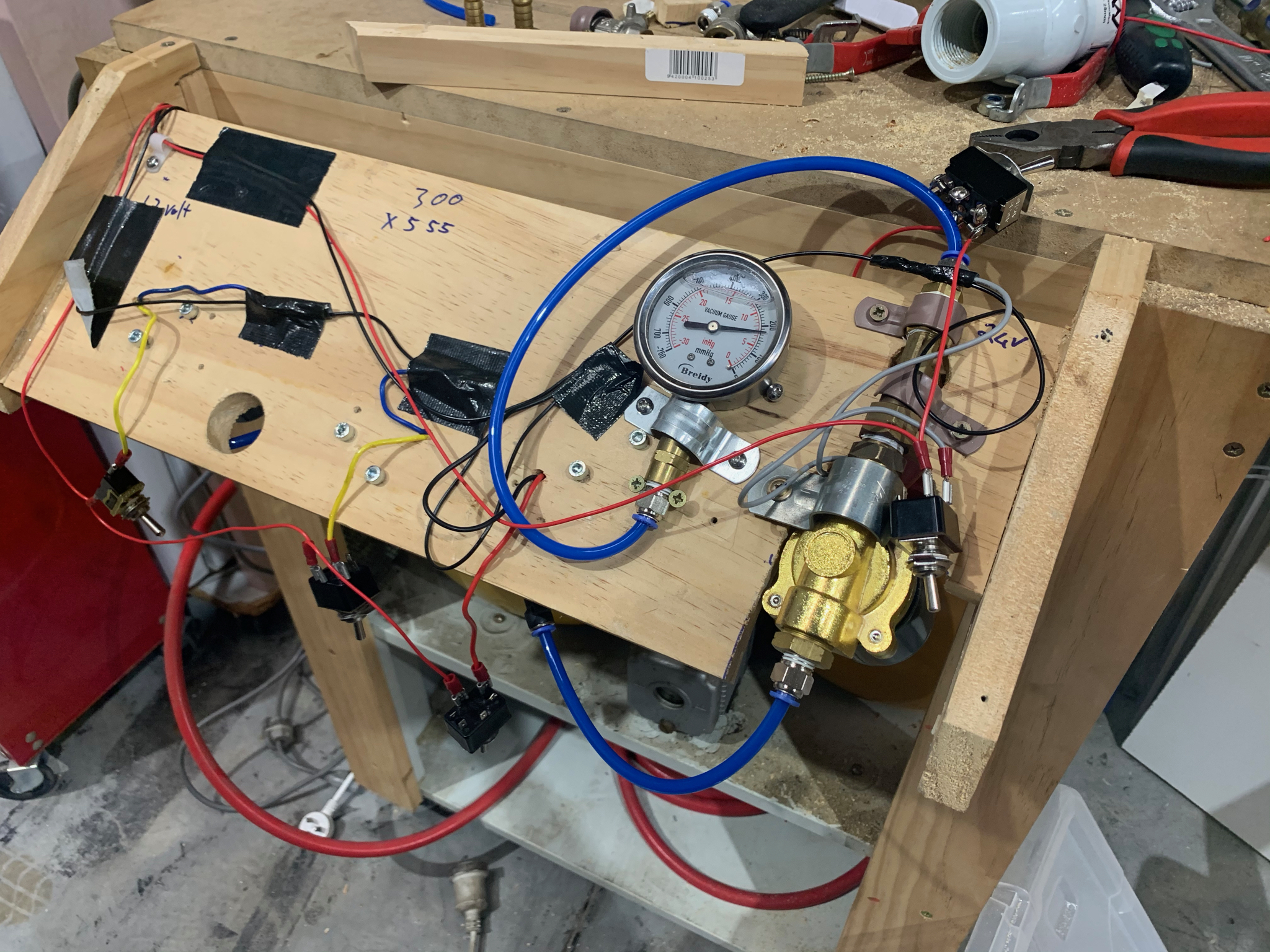

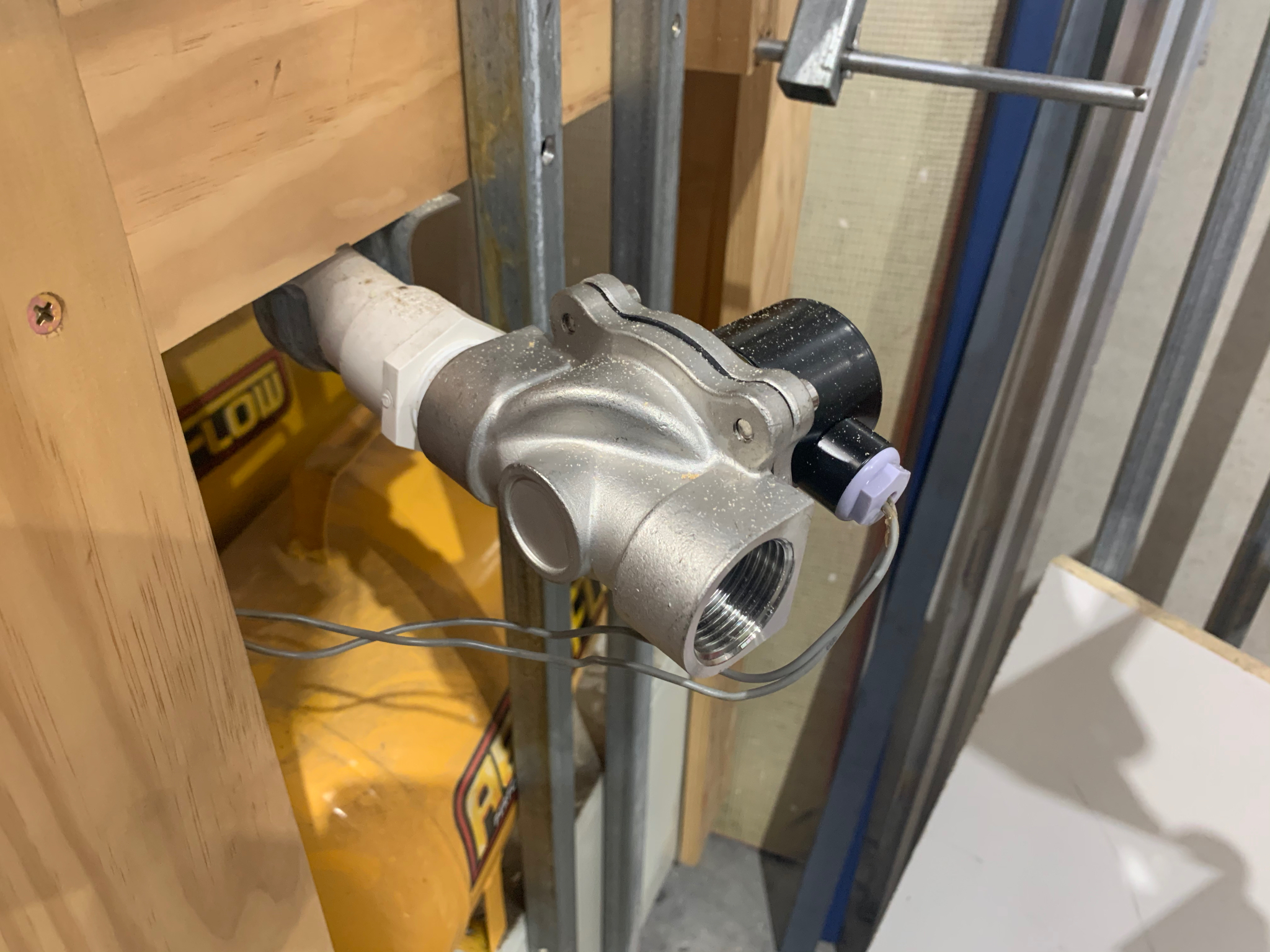

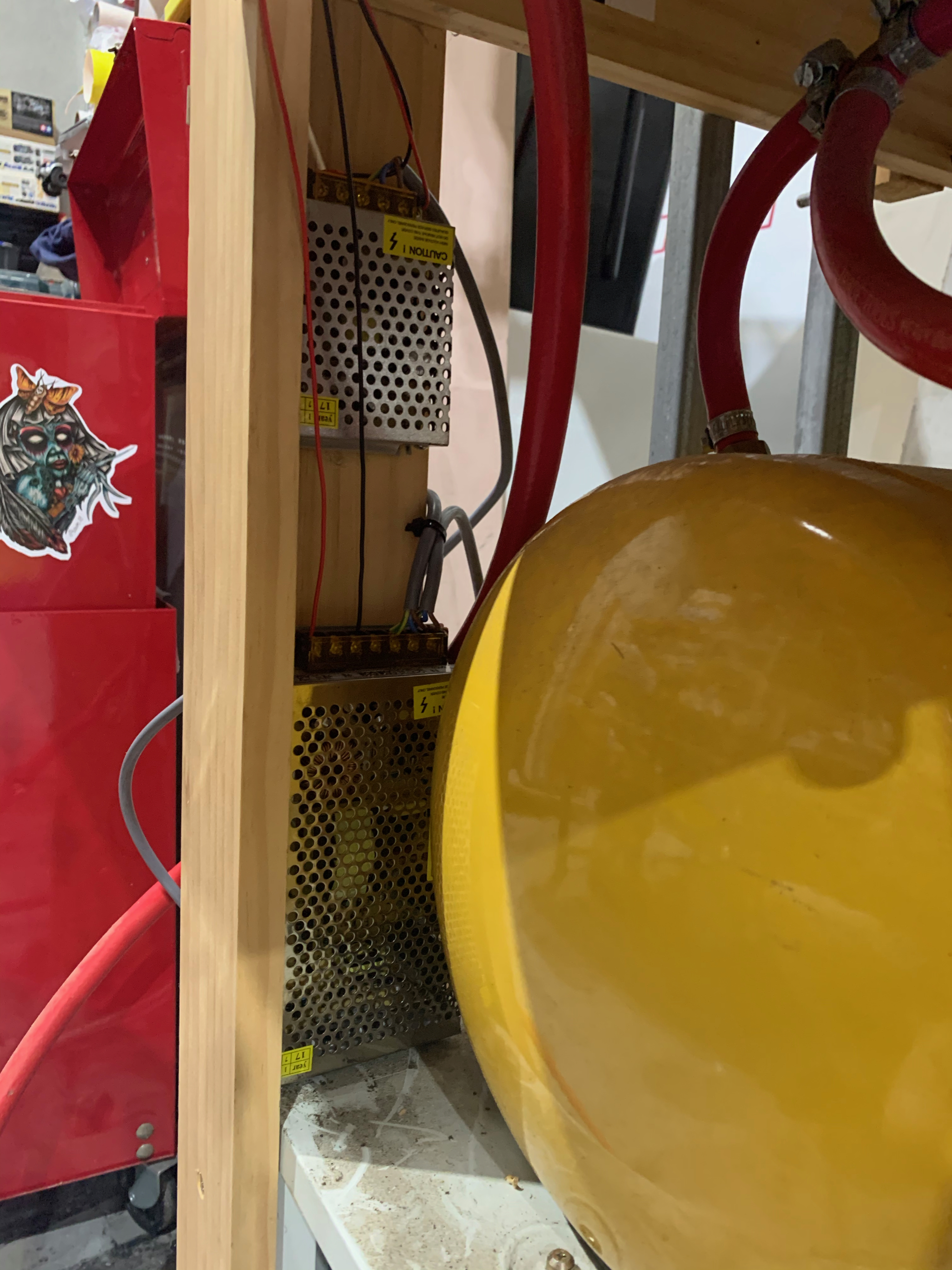

The other big upgrade was installing solenoids to give better control over timing etc. Today we work out the electrics and got most of it in place.
Where I could, I went for the biggest ones I could get. So its a mix of 12V and 24V solenoids. This is the one that connects to the vacuum cleaner.
And the power supplies are tucked away underneath.

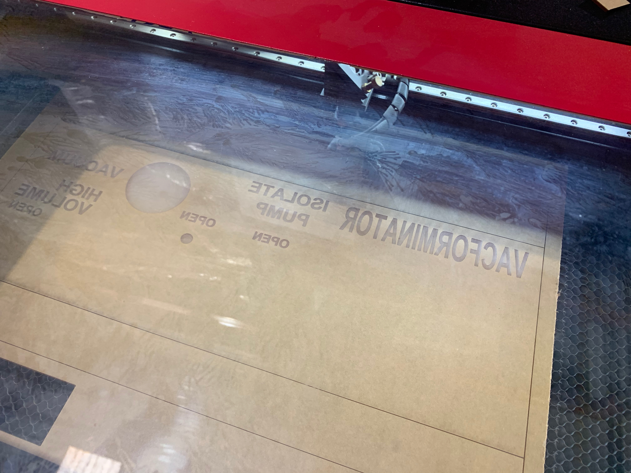

and laser cutting a new control panel. Cut in clear, reverse etch the labels and then it will be backed with black vinyl. What didn't help is I accidentally etch some of the holes that will end up being cut out.
Next weeks goal is to finish of the control panel and then remake the base so there are no leaks.

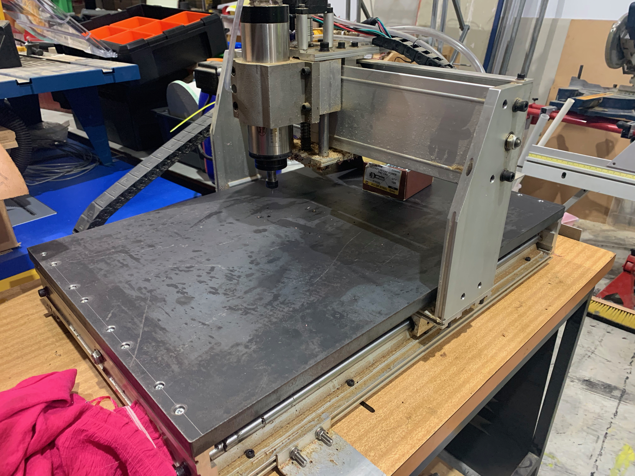

The other project I was able to start on was upgrading my CNC machine. I'd initially done a poor job of wiring up the controller box, it worked, it was just messy. I've now almost completely rewired the controller box and can now add in a homing plate and limit switches. I'll also add in a better vacuum dust collection system. I'd tried machining aluminium in a while ago, but there was some flex in the base. I have solved that with a 20 mm steel plate, that baby isn't going anywhere! That will make the base a lot stiffer. I still need to reduce the flex where the spindle is located, but this will do for the time being. While all these machines are for work, it is my aim to be able to vac form car bodies and machine in some way my own rims. My first project for the milling machine will be doing some Audi BTCC rims.

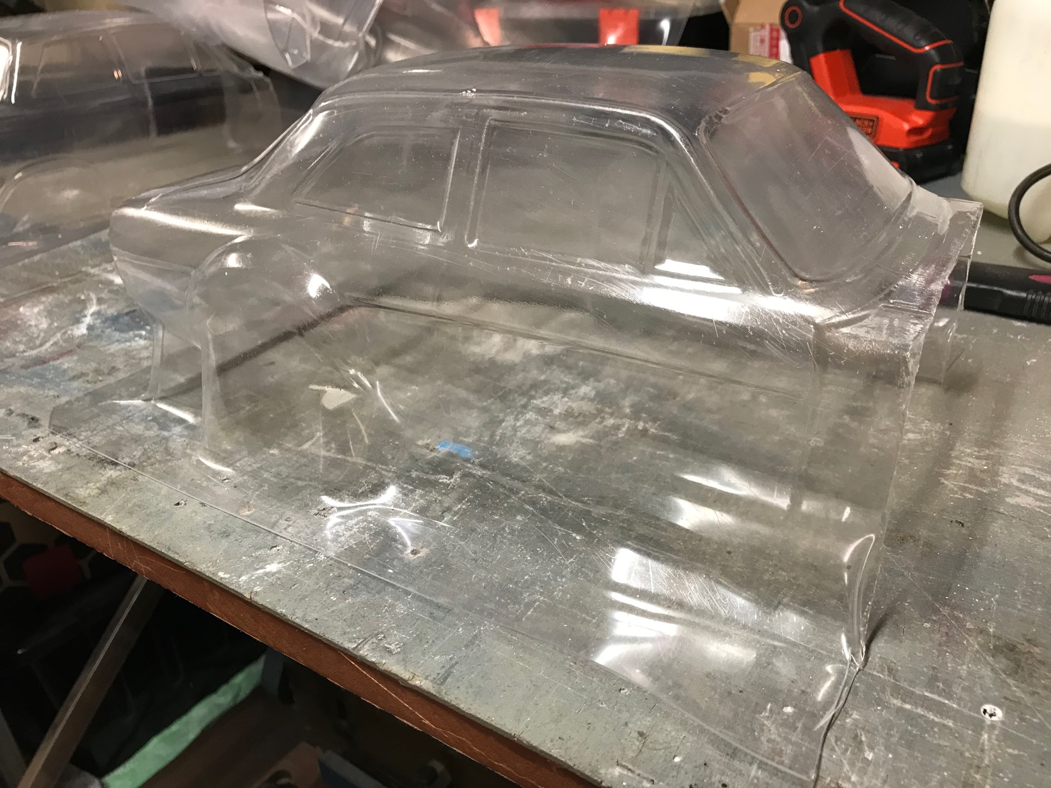

Glad to see you're still at it, mate... only taken me about a million years, but I'm just about finished my first of your shells....
Just the head and tail lights to do, plus some minor details.... and trim the rear body mounts. Still, progress!
