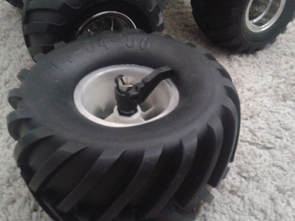

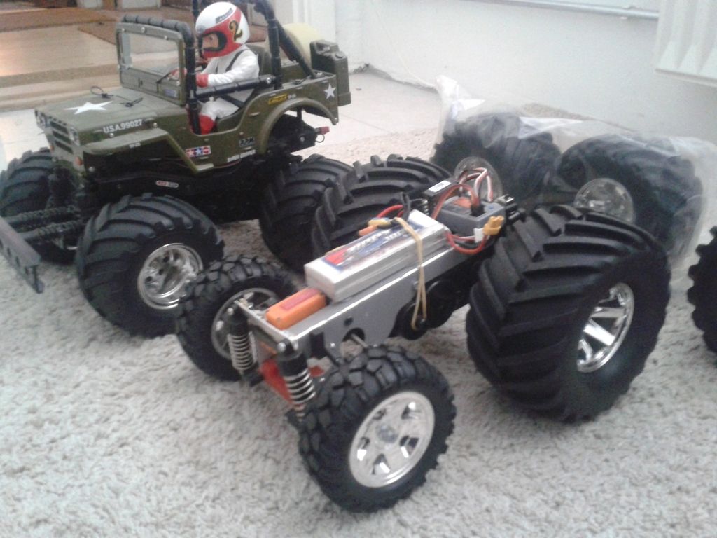

I have received the wheels, but as TWINSET points out, the usual #50736 TL-01B uprights doesn't work straight out of the box with these big wheels. I found that the TA-05 parts can do the job with a simple 2.5mm washer (picture), but Bazai hobby is VERY slow and somewhat unresponsive in getting my parts shipped, so the snow is long gone before my project starts rolling.
Meanwhile, I'v tried out the wheel on another frankenchassis, and it came out a little tractor like. Runs great, although it certainly doesn't suffer from oversteer - unless you run it backwards :)
I also decided against my original idea with steering front and contra steering rear wheels, and will go for steering (100%) front wheels, steering (50%) middle wheels, and fixed rear wheels like the Alvis Stalwart. I think this will handle better at any speed above crawl...
These days, I rub all my vehicles brushless, but the idea of triple ESC scared me into getting 3 RS-365SH "silver cans". they are only 28mm (D) x 33mm (L) so they will leve clearence for the big wheels. Rated at 35watts, they are not powerhouses, but with 3 of them at a low gearing, it should work out anyway.
Trying to keep it compact, but still making room for the B I G wheels to turn/steer. Mounted one of the 365 cans and lined it up next to a 540 silvercan.
I'm hoping to use short swingarms, but even with the small motors, it may not be possible....

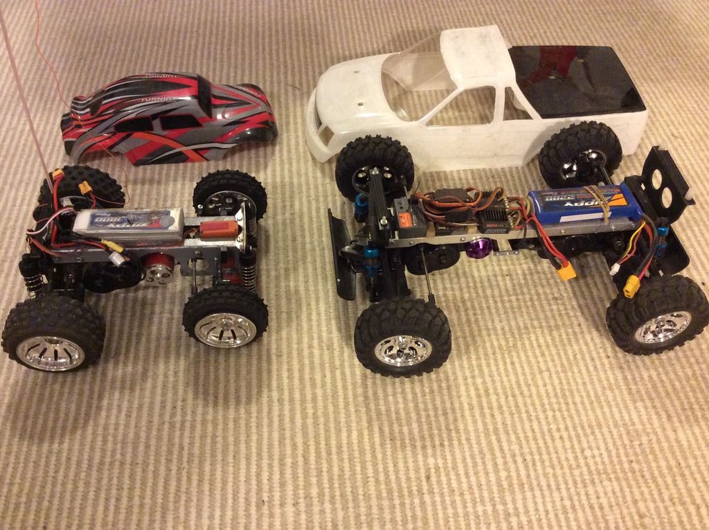

I decided to skip the articulated chassis and go stolly-style. The chassis is almost done, missing servos, BL motor mounting and some track width adjustments, but I'd like to share a few pictures:
Winter is forecast for next week, so I have accelerated the Stolly build. The platform is now running, albeit with small wheels (clearence problems with the 135mm ones) and small RS-365 Mabuchi brushed motors. Still it works very well, and I'm surprised how smooth it is.
I've driven a bit more and I'm very pleased with the chassis. Need to use a thinner shock oil, as thing get a bit bumpy at speed. Also, I managed to break the stock servo saver spring ring. Fortunately, I got two more, as I got 3 packs of the plastic parts containing these. I use a smaller servo for the middle wheel, as they turn less ans has a lower gearing. This servo has no saver, though, as I reckoned the middle wheel are fairly protected...
Finally, I decided to go with the 130mm Wild Dagger spike tires/wheel. I have 4 new ones from above biuld, and I ordered a pair for the reamining axle.
That looks great - good work!  What shocks are you using?  They seem to work well in the video.  Love to see that independent articulation.  In fact the whole thing looks better than I imagined it would, I might have to build a copycat project in the future :D
