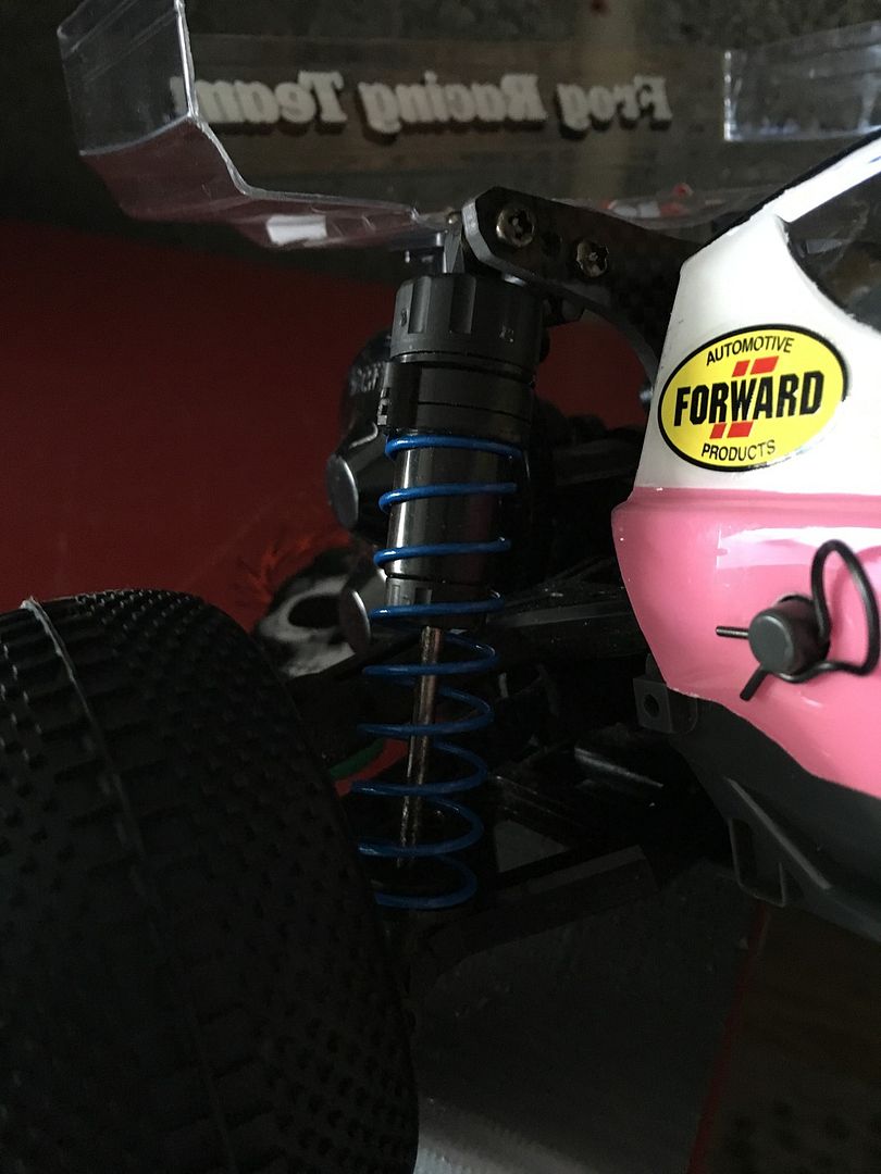

TrueBlue 44 Posted December 30, 2015 Not too long ago, I finished building a Tamiya Aqroshot which included the DT-03 CVA damper set. I followed the instructions to build the dampers 100%. Once the build was done, I noticed that the front dampers were fine and could push the chassis back up, but the rear dampers are very stiff and are unable to lift the chassis without me lifting it up myself. All the parts were used, nothing was left over. I filled the dampers with oil to the top and cleaned any overspill, I remove the air bubbles as I went. It's like the spring itself has no resistance (right word?) when compressed. Does anyone have any idea why just the rear dampers are doing this? Is it normal and has anyone experienced this before with this damper set? Any help would be awesome.. I wanted to drive this tomorrow! Share this post Link to post Share on other sites

94eg! 834 Posted December 31, 2015 A setup like this will have been done by Tamiya on purpose. The soft rear springs make the buggy understeer more, which is easier for less experienced drivers to handle. While adding ride height spacers above the springs will raise the buggy up a little, it does nothing to make the rear end stiffer (no matter what the Tamiya manual states). If you increase the rear spring rate, be prepared for a change the handling characteristics of your car (less understeer / more oversteer). Not that it's necessarily a bad thing. The overly stiff dampers holding your buggy down could be caused by any of the following factors. - A very thick damper fluid (this will have been chosen on purpose by the setup team) - A very imprecise plastic damper with lots of friction between parts (only expensive dampers will solve this) - Pistons that weren't trimmed properly and are scrapping along the cylinder wall - Imprecise fit & excess friction in the suspension components Keep in mind that while the buggy is running, there is a lot of vibration in the drivetrain and suspension. This effectively helps keep damper and suspension friction in check. Your buggy will not get stuck in the same lowered position like it does sitting static on a table. Lets me also mention that the above examples help illustrate that there is a reason TRF cars are so much better and so much more expensive. The smooth & precise action of the chassis & suspension can be worth every penny. 2 Share this post Link to post Share on other sites

TrueBlue 44 Posted January 1, 2016 I kinda sorted it out, but it's not great. The instructions say to slide a small tube onto the piston rod, which I have no idea what it does. So what I did was move the tube below that disc the spring presses against, therefore making the spring a little stiffer. It's not the best fix, but it kinda works and it now pushes itself back up. My description might not make much sense, hopefully the pictures do. I may opt for some better springs in the future though. Share this post Link to post Share on other sites

94eg! 834 Posted January 2, 2016 Those spacers don't make the springs stiffer. They simply raise the ride height. Share this post Link to post Share on other sites
Nobbi1977 1793 Posted January 2, 2016 Those spacers don't make the springs stiffer. They simply raise the ride height. Keeps the back end from dragging though. Just a thought, the rears have a story of black coating on the shaft. I always polish this off, did you? 1 Share this post Link to post Share on other sites
TrueBlue 44 Posted January 2, 2016 I did not polish off the coating of black, no. I was wondering why one pair was silver and one was black. Share this post Link to post Share on other sites
Nobbi1977 1793 Posted January 2, 2016 I did not polish off the coating of black, no. I was wondering why one pair was silver and one was black. I have no idea why one is black but the coating seems to cause stiction Share this post Link to post Share on other sites
mastino 1071 Posted January 2, 2016 I have no idea why one is black but the coating seems to cause stiction You speaking about that? I've polished in my DT03 these parts- It is not a coating. I think it's a failure to finishing of the parties. Polishing paste and drill Share this post Link to post Share on other sites
Nobbi1977 1793 Posted January 2, 2016 You speaking about that? I've polished in my DT03 these parts- It is not a coating. I think it's a failure to finishing of the parties. Polishing paste and drill That's it. I used a bit of scotchbrit and autosol to polish them up Share this post Link to post Share on other sites
94eg! 834 Posted January 3, 2016 OMGoodness, those rods are heinous! Polishing them is definitely a worthwhile task. Though I'm wondering if they are even made of stainless steel, and won't rust. :\ Share this post Link to post Share on other sites

Effigy3 1267 Posted January 31, 2016 When I built an Acroshot I also polished up the pistons for the rear dampers. What ever the reason or purpose of that black coating on the shafts is, the effect is that the pistons don't work as smoothly as I'd like. Here's a link to the step in my build thread where I built up the dampers. I have a DT-02 spring hop-up and I did try the hard springs on the rear before I settled on sticking with the stock springs. The plastic tubes placed on the shaft have various effects depending on where you place them. Inside the shock body and it will reduce the overall length of your shock On the piston between the shock body and the spring cup will limit the compression stroke. This can extend the life of your shock if you are bottoming out the shock before the chassis slaps the ground. On the piston below the shock cap. This will generate spring pre-load compression, and will be exactly like adding clips to the shock body. The downside to this method is that you can't adjust the pre-load as easily as you can with clips. Share this post Link to post Share on other sites
