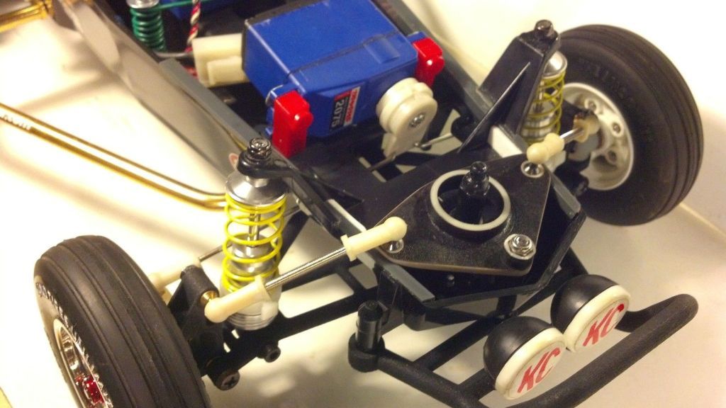

You also need to buy the accompanying hardware (nuts and bolts) set and you will need to improvise some upper control arms as the kit supplied ones are the wrong length
Works really well though!

I struggled to find oil shocks to fit.
CVA's have too large a diameter.
I tried to fit Hornet oil shocks all round but on the front they were fully compressed just at rest.
Ended up using some Tamiya 1/14 scale truck shocks - well pogo sticks/spring holders actually (not oil dampers)
Never been fully happy with them but they look just about right and do the job.
If anyone knows of oil shocks that'll fit with the CRP front end kit I'd love to know about them

This hornet has a great front set up. I don't know if it's a kit you can buy or custom made.
This one has the crp front end. I think it's a members that is on TC. Hope he doesn't mind me using the pic. Think its a great action shot.
img20319_01092008073419_1_zpspnnz1r0r.jp
CRP's ghopper replacement shock tower kit came with shocks. Early kit had aluminum retainers and seats. Later kit had red plastic. The same shocks were offered with many other makes/models. They are fairly easy to find.
