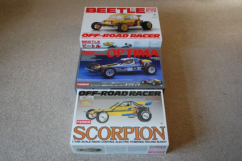

The box is small, like the Scorpion box
Yep, that was a real surprise to me too. They really packed all of the stuff in tight with this one. The box is actually less tall than the Scorpion box, and only slightly larger in length and width. Compared to the box of the Beetle it is miniscule.
