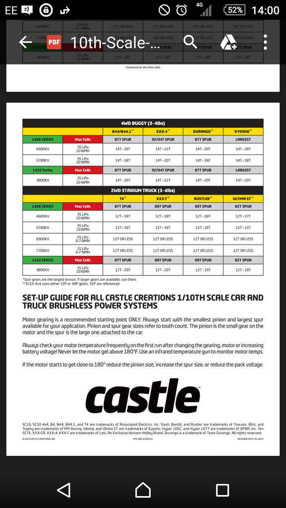

Generally,lowest gear you can to start with and work up.
Depends where you're running,car park,asphalt,I would say it would be fine on stock gearing.
Grass,would need lower gearing, same as BITD.
Screen grab from the castle creations site,higher rpm motor,lower gears required.
