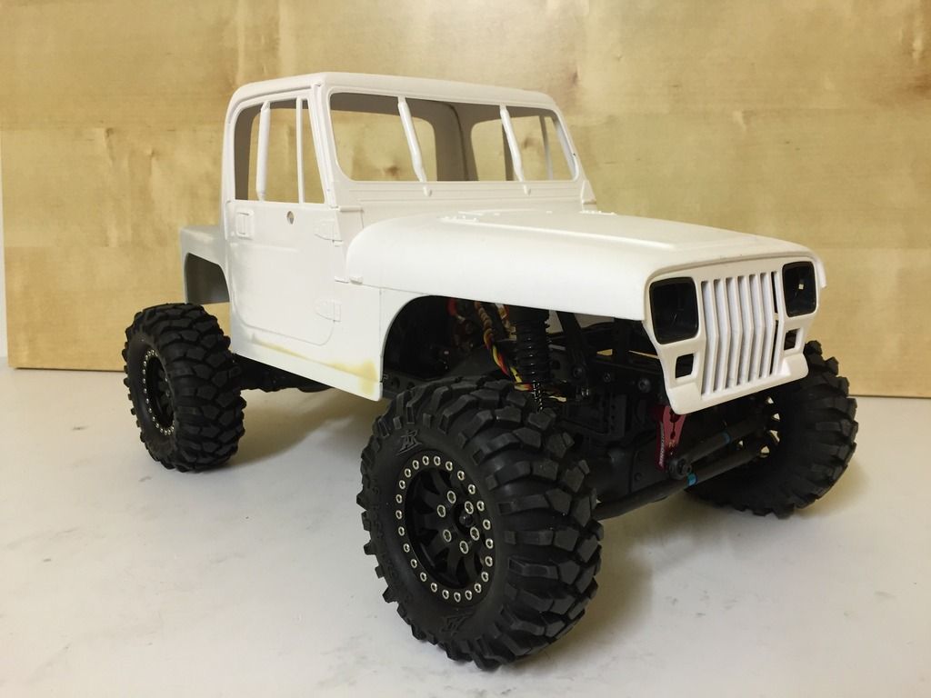

I'm currently building one of those (got the bodyless kit just after Christmas) with a modified Tamiya Wrangler body.
The bodies included are 100% Tamiya bodies, just as MST does it for their drift cars.
And while the technology of the CMX is very close to a SCX/Ascender, the very narrow width and the short wheelbase is pretty unique, unless you want to spend more than twice on a RC4WD SWB kit.
Quality is very, very good, MST is using some of the nicest plastic I have seen in the last 30 years working on rc stuff. Parts are fitting perfectly, screws are good quality, everything feels very solid and the tires perform very well (and would be a great upgrade for all the CC-01 owners out there).
Only thing I didn't like: just like Tamiya, they didn't include any ball bearings in the kit.

That looks like it will be brilliant bsy. Are you doing a build thread? Nice to know you rate the quality. The prices I've seen are around £170 but I'm still looking for the best place to buy at the moment.
When you did the build did you get the parts to build it in all of the 3 wheelbase options, 242mm, 252mm, 267mm? It just looks like the build in the link mark had in his post the kit has the parts for 242mm and 252mm but to make a 267mm wheelbase you need to purchase more parts. I'd need the 267mm stance as I'm thinking of buying just the chassis kit and a land rover shell. This needs the larger wheelbase.

You're right, the parts for the 267mm wheelbase are not included, but easy to make yourself. The length should be 60,5 and 72,5mm.

Regarding the Land Rover shell... Certainly a nice body, but with 280 mm wheelbase you might have to think about other drive shafts. With the stock ones, I wouldn't go longer than 267mm. Also, even at 267mm, the servo is going to hit the crossmember up front and you would need new shock mounts, as the mounting points on the axles require pretty straight shocks.
Edit: already doing a build thread in a German forum ;)
