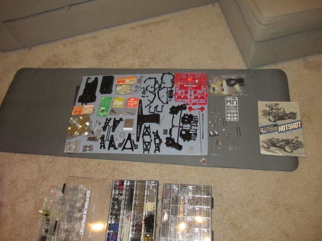

I guess the best place to start is from the source of all the parts. I have been hoarding/collecting most things Hotshot over the last 12 or so years since Al Gore invented the internet AND Global Warming. I have sold some parts off, traded, donated, given parts to all sorts of folks to all corners of the globe and I have enjoyed it and still enjoy getting parts to folks that are in need of them if I have them. Recently I found myself slightly disabled with back pain paying me another visit and with visitors over the holidays, I had to pack all my 'toys' as the wife calls them, into the garage. Thankfullly the temps in there haven't hovered over 100 yet, so I feel the parts and cars are safe, for now.

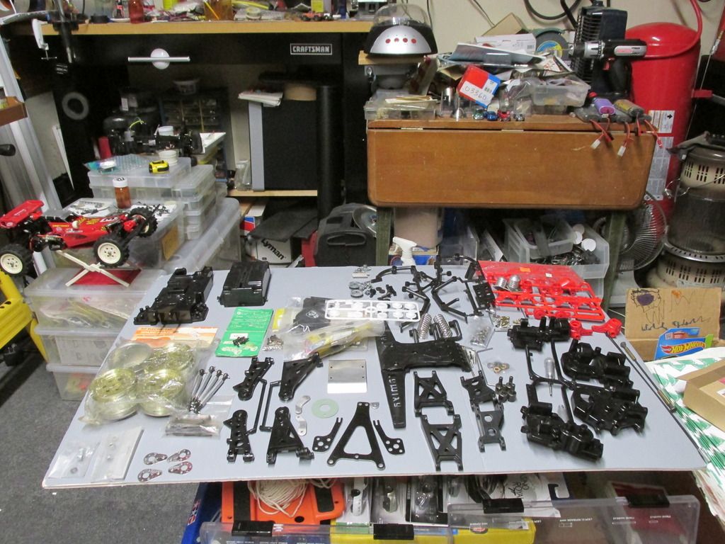

Doing all that moving around and having some time on my hands, well I started to see if I had all the necessary parts to build another Hotshot, wouldn't you know it, I did, save a couple screws and I expect those will arrive any day now really.
Have a look at how I laid it out in the guest room before it had to be packed into the garage.
Those are my new screw boxes on the bottom of the photo
Then it was transport the parts to the garage in a manner that I could focus on a build when time permitted

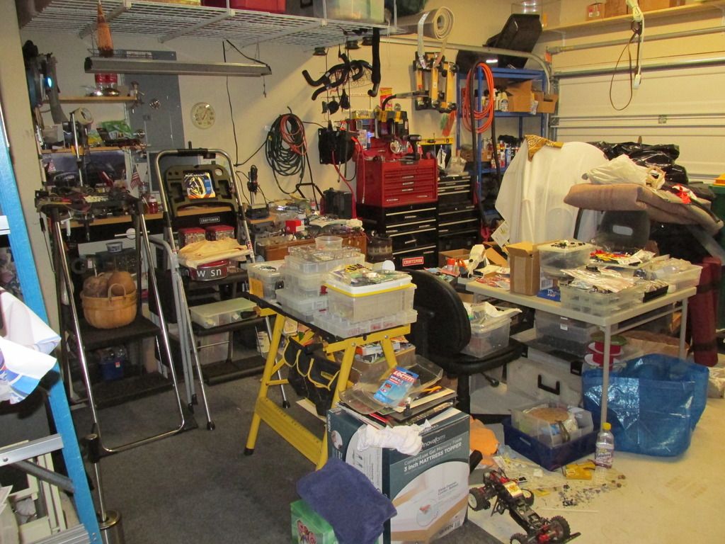

HA, I love it, you guys think I am organized. I think you ought to have a look at the garage area SURROUNDING the build parts and reassess that opinion.
Did you see the "project" Hotshot on the floor?? More on that in the near future I hope, still awaiting parts on that one.
The "shelf" wall, it still can use more neat and tidiness.

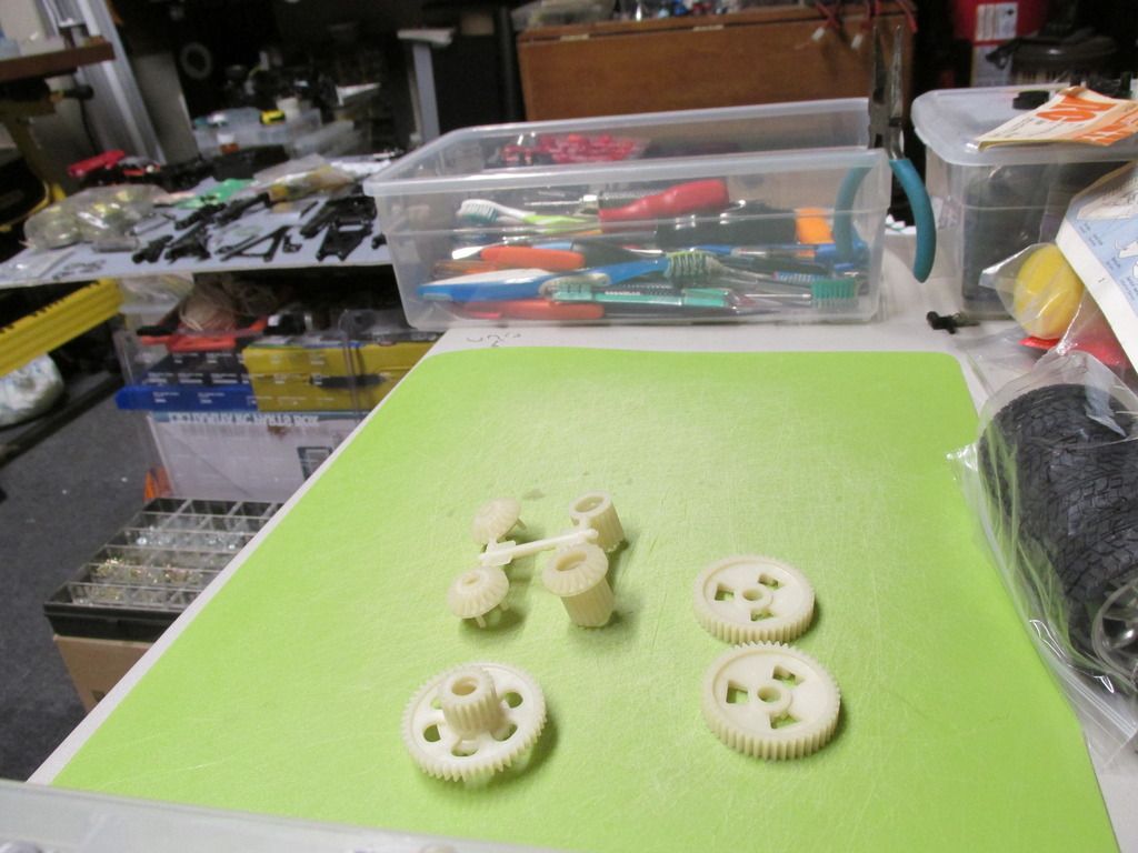

STEP ONE, find gearbag, open and trim and sort.

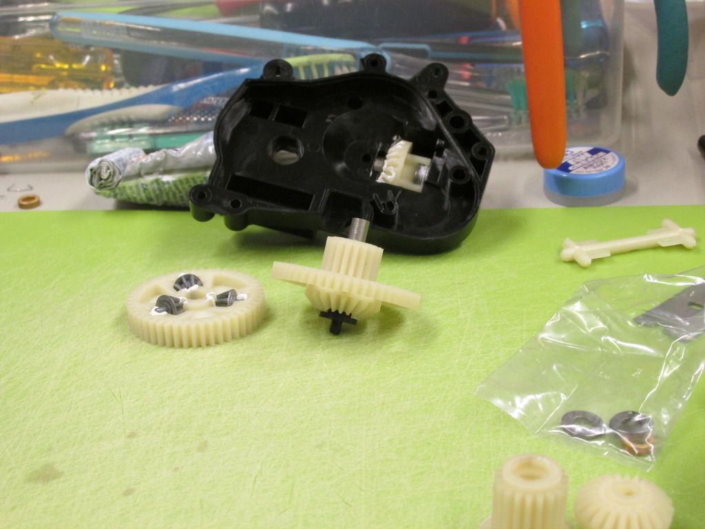

Now we need to get a half a gearbox out and the grease. This may be a little redundant as I have mentioned it in the past, but I like to be cheap and effective and efficient when I think of the projects I still have to do, so with that in mind, I tend to buy metal shielded bearings in little lots of 10 or so, especially when they go on sale at some ebay sellers and I like Tamiya's greases and such, but they are not all that cheap, so the auto store to the rescue, I have had so much success over the years with simple geared cars and White Lithium Grease as well as Dielectric grease for cars with a "sealed" gear diff, alal Manta Ray, M chassis cars, so that is how I work my differential builds. I also use the WLG on the gear's teeth as well as the pinion, no more blackish moly grease for me, thank you. Even though this car is likely a shelfer or even perhaps a car to put for sale somewhere in the distant future, it is going to be built like it were to be run casually, so here is how I work the gearboxes up.
So here is the amount of WLG I like to put on the metal bevel gears so it isn't flinging around all over the insides
You can tell I got a little more liberal with this side of the bevel, but not too crazy, note the teeth are greased up on the plastic diff gear

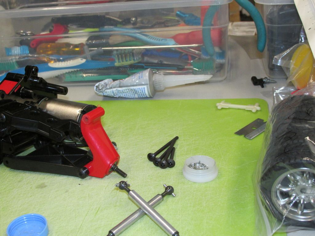

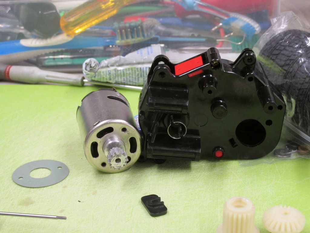

Well, we left off with a fully greasy rear gearbox, time to add the motor, found a nice vintage one laying around sans wires. This one looks vintage to me as it is stamped JAPAN on the endbell, I chose a 13T pinon to throw on it.
And then here it is all nice and tidy installed in the gearbox.
You might note that I haven't used the Tamiya rubber balloon, well, I do have one, not to brag, but they do not weather very well here in the humid state of Houston Texas. I don't know if I will ever wire this up, but it is nice to see it installed instead of some vacant hole.

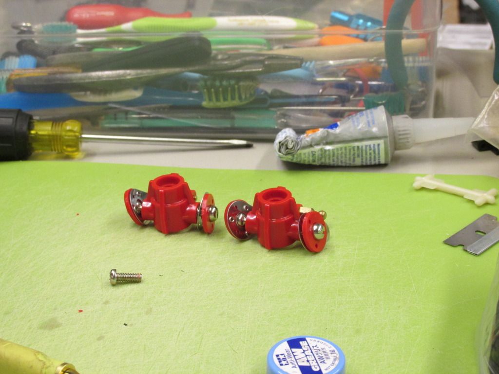

I have the front gearbox all greased up similarly
Red bit added and on this photo I wanted to point out the ONE machine thread screw(screwdriver point is nearly touching it) as it is important I have learned over the years to NOT over tighten this one as it strips easily because it is being seated into the gearbox half plastic. Trust me on this, liquid threadlocker is nice, but when the entire car is being held together with it, well, it ain't that great. :D Since this is a new build and likely not to run, I have been tighting these screws to the point of just closing the gaps in the parts assembled and calling it done. Hope that helps out someone out there so they don't find their cars full of stripped screws.

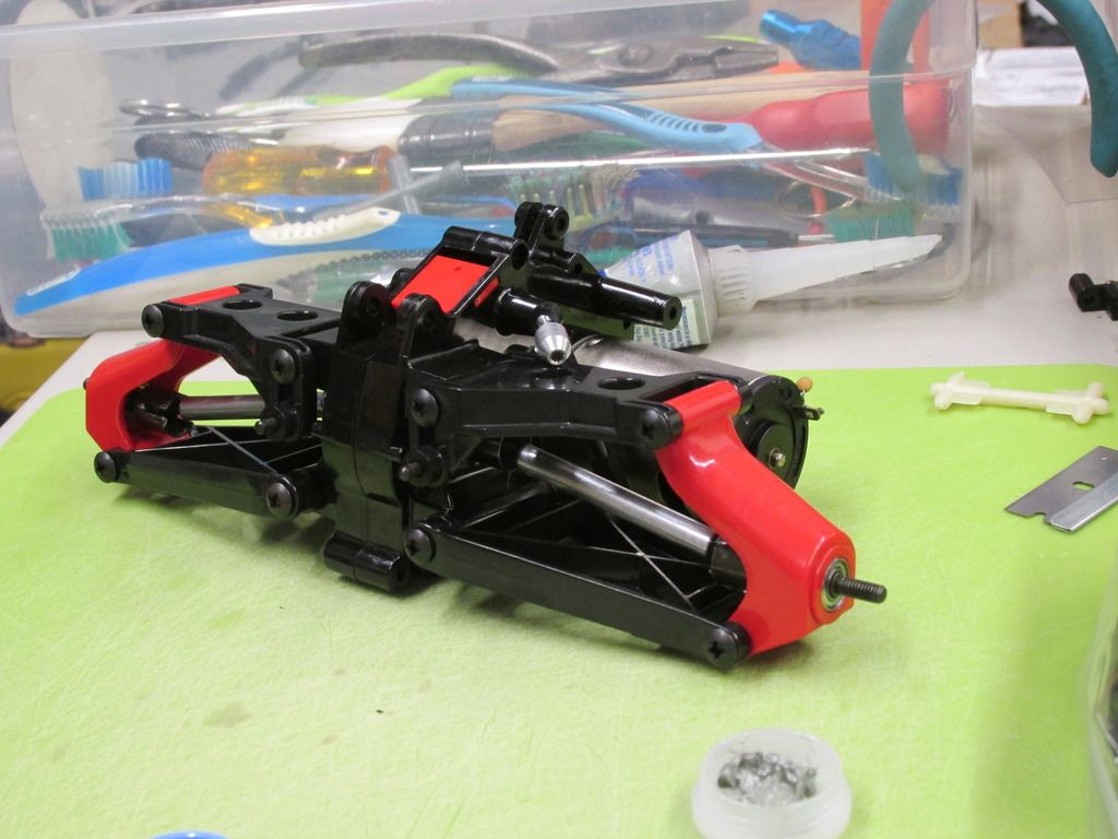

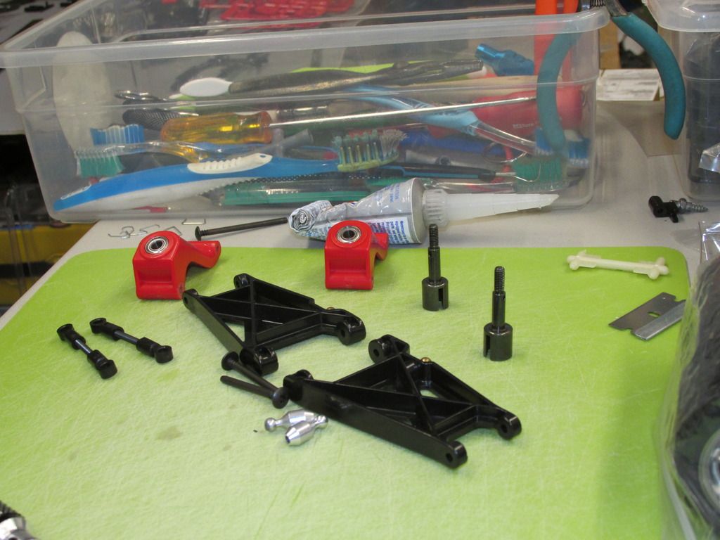

We have made it to STEP 10, the rear amrs, got this tree all laid out and the bits too, nice new black axle cups there and went with bearings in all the rotating spaces on this car.
All put together here
Adding the "wings" to the rear gearbox
Now onto the rest of the R parts attached to the rear gearbox.
Here I wanted to point out just how little AW grease one needs to apply to these dogbone ends. You don't really want to attrach dust to the sockets, so just a small layer applied to the ends will do. I like Tamiya's AW grease as it comes in a small pot that is nearly perfect to "dip" the dogbones into and this pot has lasted me for several builds. NOTE, only one ball end has any AW grease on it.

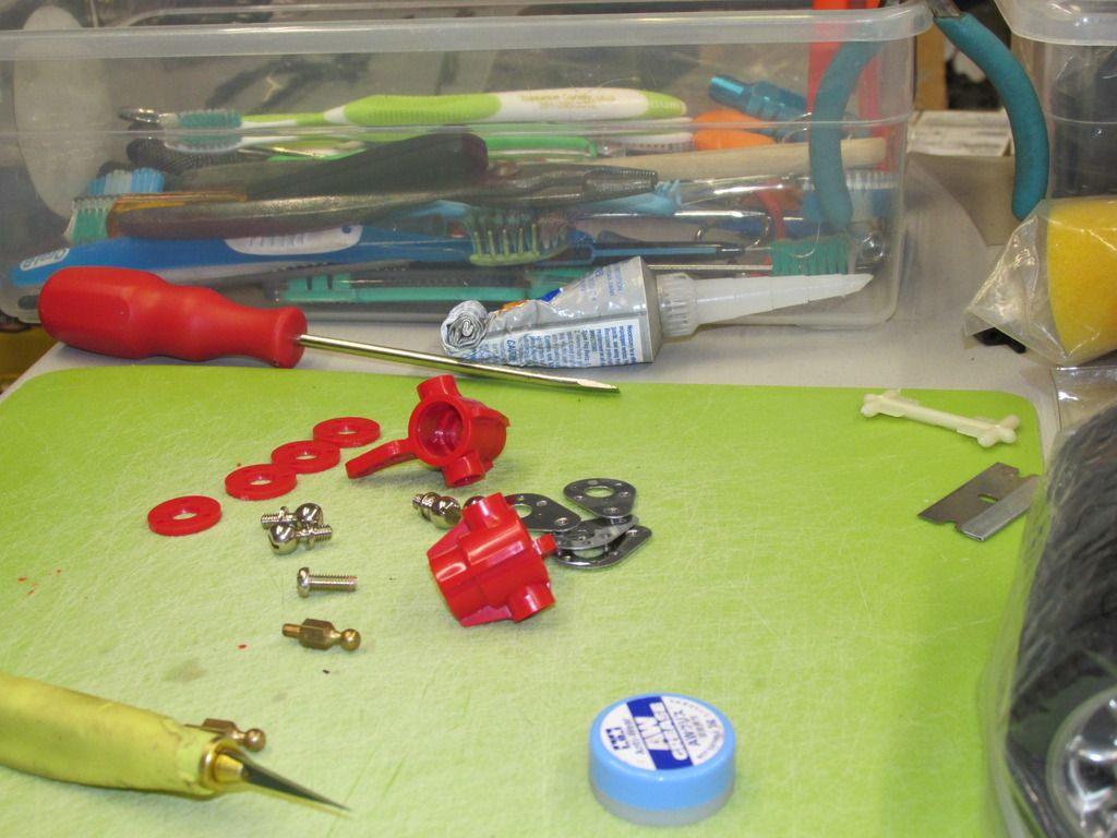

Now up to lucky number 13 on the steps, front upright construction, you have to be steady handed to get these threads tapped straight.
In order to do the tapping, you might notice a 4x12mm screw next to the brass ball end, that is for specifically tapping these uprights, the instruction manual states to use the silver wheel axle to do this, along with an allen wrench, I find that a little too difficult and since I had this screw provided by Tamiya when selling just the Upright in a package, well, I went with the easy way.
All stuck together now
