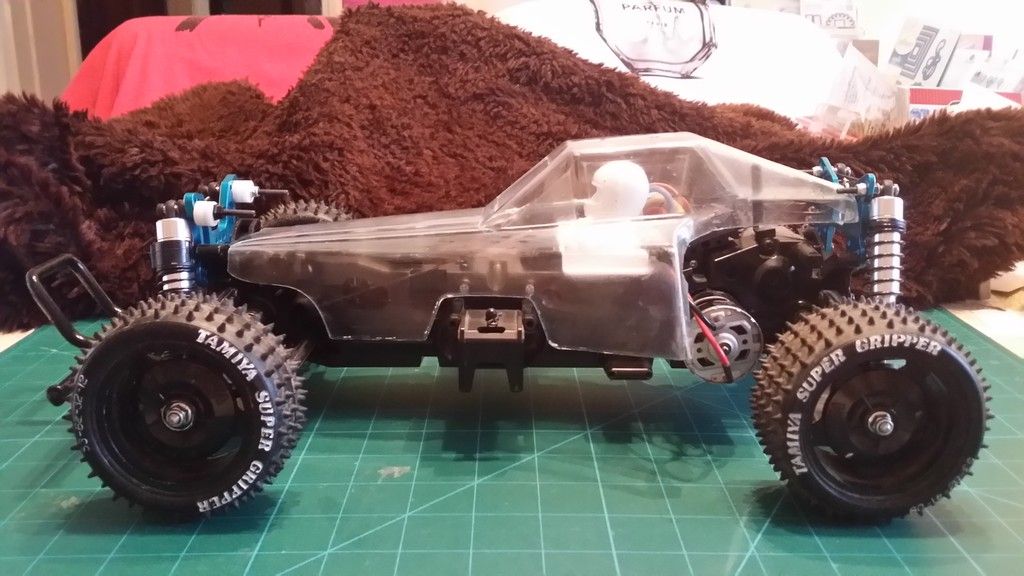

mongoose1983 3335 Posted September 3, 2016 On 18/6/2016 at 3:40 AM, mongoose1983 said: Well, I haven't touched the ruined Hornet body in months now... [...] I'll turn and try something else with the ruined body. I have some idea for it. You guys know I don't throw away expensive stuff just like that, I'm going to find GOOD USE for that one you take my word Well it happened the buddy I got this used Hornet body from show me some pictures of how he stripped his Axial Wraith body a few weeks ago using regular house paint solvent and a piece of cloth. I happened to have a bottle of that here at home, as I painted a couple of rooms a few years ago. So I tried it and worked fine, and now this is as far as I'm going to go with this old Hornet body, now that I just got another one of these classic chassis here to experiment. Â I'm wondering now if one of these small bottles would do for a Hornet body. What do you guys think? The wing is still painted blue, so it would match alright. Â Share this post Link to post Share on other sites
chevelle 997 Posted September 3, 2016 Well done buddy, Considering how that body was looking  Putting it down then coming back to it was a good move, That paint will be a close match but you'll always notice a deference  However It will be an excellent runner body 1 Share this post Link to post Share on other sites
Terz1 745 Posted September 4, 2016 Good job on your hornet body. The shell which you've had difficulty removing the paint from looks much better now you've used the house paint solvent too. I've just refurbished an old tamiya and the paint was a horrible dark blue. I'd done a quick paint job on it 16 years ago and not even masked the windows. I think I had in my head at the time if I do a rough job on the body I'll actually use the car as a basher instead of do a really nice paint and decal job and just sit it on a shelf. I recently thought I need to repaint it but remembered this thread you made back in February and the trouble you had removing the paint from tbe polycarbonate shell. I must have heard somewhere that nail varnish remover removes paint really easily. I borrowed some from one of the female family members  (as a bloke I never had the need for any , power to any guys that do use nail varnish though! ). And the nail varnish remover worked a treat. It seemed to weaken the paint in a matter of seconds and could then be rubbed off with a cotton wool ball. It didn't break the paint down to the point it left any smearing on the plastic either which was more than I could have asked for. Stripped the shell completely of paint well within an hour. The colour removed was a very dark blue and I resprayed it tamiya ps3 which is a very light blue so any remaining paint would have shown up badly. So I was really impressed with the nail varnish remover. This is how it started... This is after the paint removal with the nail varnish remover... And how it turned out in the end... I'm not sure on the coverage that paint pot will provide mongoose. I tend to use the small tamiya polycarbonate spray cans which are 250ml (I think). Sure someone will come along that knows. 2 Share this post Link to post Share on other sites
mongoose1983 3335 Posted September 4, 2016 It's amazing what you did with that old, beat-up looking bodyshell Terz1! Well, I tried nail varnish remover on this Hornet body, and it did nothing to the paint-and I mean nothing at all. I really have no clue about what type of paint was used in it, it's like nothing I've seen before. I do like learning more about other TCers experiences about the subject. Right now I have a original Avante that I would love to have the chance to repaint. Something must be done to make that ugly buggy look a bit better! Have a good Sunday! 2 Share this post Link to post Share on other sites
