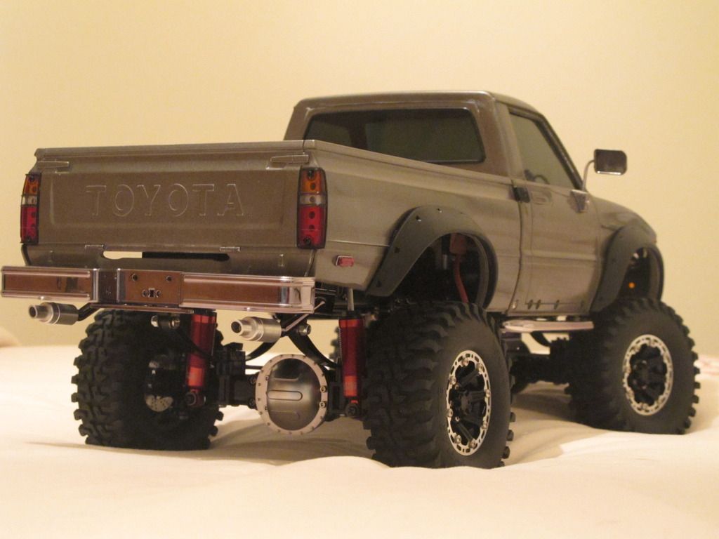

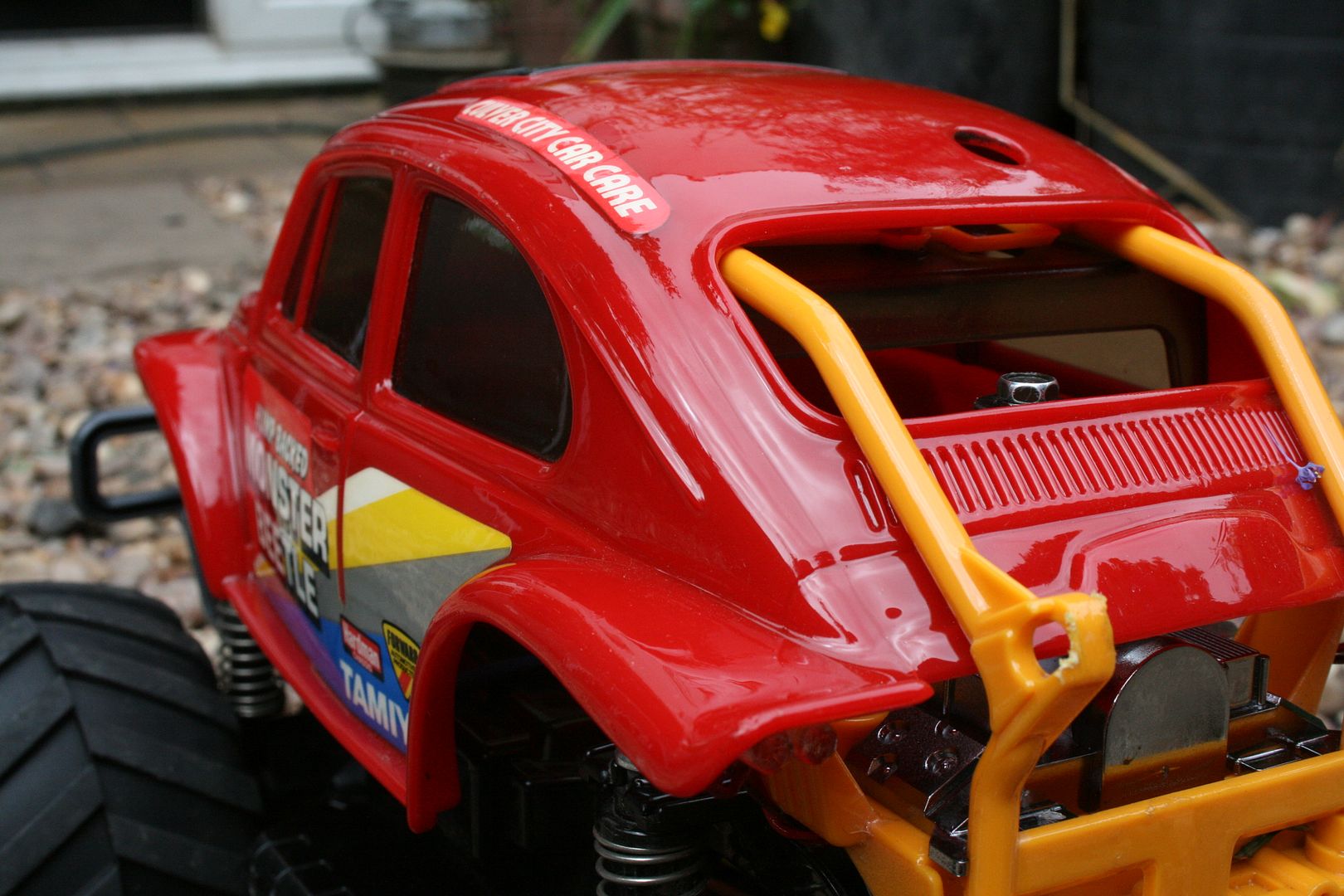

I left mine about a week before wet sanding and a polish with menzerna 2400/4000
I didn't go overboard, only spending perhaps two hours maximum on the finishing, it will be an occasional runner, I used BMW Mini rattle cans ..
F4F39FAC-E5BA-4E4F-84D0-4AFA79F27DD6_zps
By no means perfect but good enough for me, if I'd spent another 20 hours on it I'm not sure it would have be hugely better.
