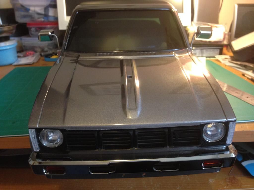

The big question is do I clear coat? I was about to (much like with the Tundra build but the difference is this is blue and less forgiving so my gut feel was to not clear and spend the time polishing out the orange peel on the actual paint as that will get it to a glaze better. If I laid down the clear on this paint (recommended 15 mins after final blue) then I wouldn't have had a chance to correct any of the actual blue, so decision made.
I am feeling this is about an 8/10 from a paint perspective, there is always an issue or two, but all in all I'm really happy with it. The Tamiya spray cans can give sensation results when you use them right.
Looks pretty good on my screen - flatting out the blue before clear will help, and prevent multiple coats and flatting of the clear. At least you went with a solid colour; metallics are another story on that body, the size and the micro porosity of the plastic creates all sorts of inconsistencies in metallic flake laydown, not visible on some colours but a nightmare on others if you are trying for a concours finish.
Looks like a job well done. I have no experience with the Tamiya hard body paints or how they respond to polishing. The colour looks really good though, is that the manual colour?
I've spent over 100 hours on mine (stopped counting after that for sanity reasons), I can't argue or justify in any way that it was worth it, some of it I really enjoyed, some I didn't, I learnt a lot and I sincerely hope the next one will take an awful lot less time!!
Thanks for the comments guys, I actually wish I had a pearlescent colour to be honest, but to stick to the manual I used TS-15... So the only thing to do it so get it as deep and "wet" as possible. You've motivated me to take some higher quality photos with the real camera in the sun outside just now, it's a good coating, but when you get the 70mm lens onto it you can see the 'peel' on it.
I've had a bit of experience with 1:1 cars and polishing with Meznars polish and a DA polisher. I feel that the process is the same and after reading this tutorial: http://www.modelcarsmag.com/perfect-paint/ I'm convinced that I can work the paint to get it really deep and wet looking.

Most bodyshops say not to wax for a month after paint! Although of course they are clear coated. I'd leave it for a while and probably test it on the inside first. With mine I left it a week just between clear coats to let it off gas and also you could almost smell when it had finished off gassing as the shell no longer smelt as strong. That said I'm using a completely different system, hopefully others will chip in with experience of Tamiya spray.
The decals aren't so bad when you get im to them, as long as they are printed to the right side!! It is definitely a detergent/water and hair dryer (sparingly) operation.
The silver looks great. If you can get a bit more shine out of it that'll be the icing on the cake. I think it looks great and at least the solid colour is period correct, which pearl paints aren't!
I left mine about a week before wet sanding and a polish with menzerna 2400/4000
I didn't go overboard, only spending perhaps two hours maximum on the finishing, it will be an occasional runner, I used BMW Mini rattle cans ..

By no means perfect but good enough for me, if I'd spent another 20 hours on it I'm not sure it would have be hugely better.
better than all my attempts Percymon, but then, none of mine are slated for shelf work.... that said my lowride pumpkin is just sitting around on a shelf gathering dust...
