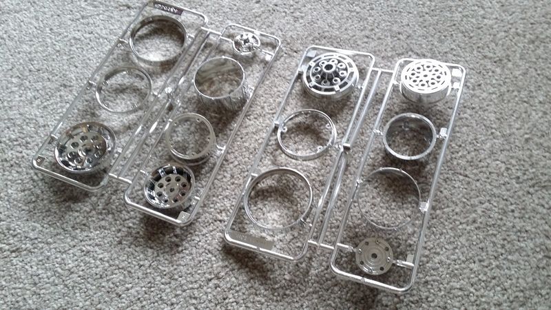

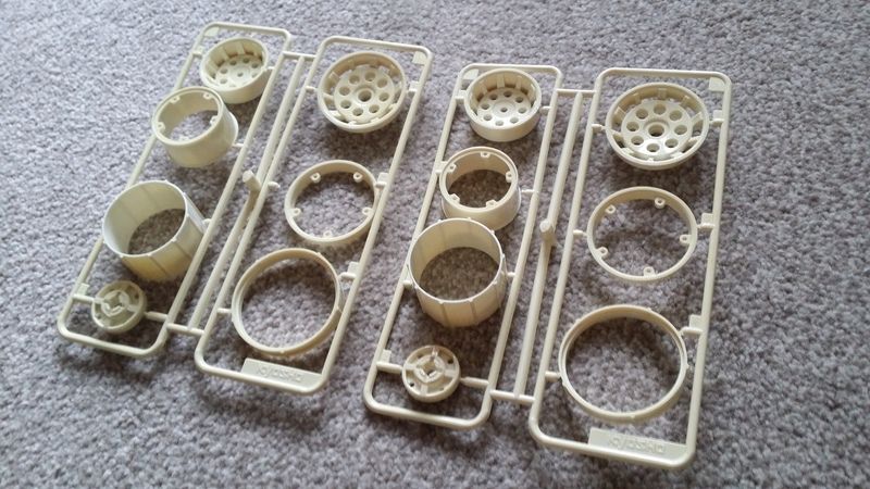

After seeing those cheap Pegasus wheels on ebay I decided to nab a set and buy some more Oven Pride to confirm my previous experience with stripping chrome off with this stuff.
It turns out that the stuff is even more potent than I remembered as the chrome on these wheels simply dropped off as soon as the Oven Pride touched it. No joke, every last flake was removed with a bit of agitation within 120 seconds.
Weirdly though, the bare wheels look yellowed after the chrome removal, as if they have been sitting directly in the sun. Were the kit supplied wheels yellow tinted like this from fresh?
Before and after pics below...
WOW yeah, the boxart pegasus wheels are a 'bone' off-white. check out the actual box art and u will see the contrast with the white paint of the body.
what u have there is a set of real-deal NOS pegasus wheels! nice!
Yeah, they are a lot nicer when stripped than in that nasty chrome.
