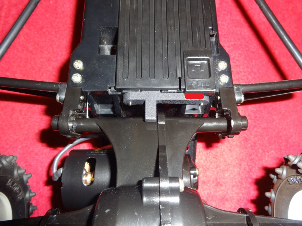

Ok this one is awesome. Installed and tested with full articulation to the left and right.
I think the installation is really neat and tidy. I thought it was going to be very obtrusive for some reason.
I need to order one from shapeways to confirm tolerances and then i'll make a thread in the TC Designs area about how to get one. Thanks for the suggestion! My lunchbox has never been happier!
By the way, guess who is next...
You know, if this piece was altered to extend to match the width of the chassis tub installation could be simplified. Rather than drilling the battery box to locate the mounting screws the nerf bar screws could be replaced with longer ones. The longer screws would be more than enough to support the mod.
:) Also I thought of a good mod also that can be done to improve two problems with one small part.
if he made a raised lip on the side directly behind the battery pull UP tab on the inside half of it from the cut side to about the letter U on the tab half way.... it would stop the battery lid from falling off all the time and you could still open and lift up the tab from the outside half without the raised tab behind it..
I did initially think of this but its really hard to get a screw in there. Plus those sloped ribs mean I need to thin out the brace around them. I dont think it will weaken it considering how the loads are applied though. its not a bad idea.
Hmmm....I like that. The brace was initially designed to do away with the battery door all together. It is supposed to look like this:
This mod was the idea for the brace but now it is looking like it has become much more useful than I thought.
Thanks for the info folks!
