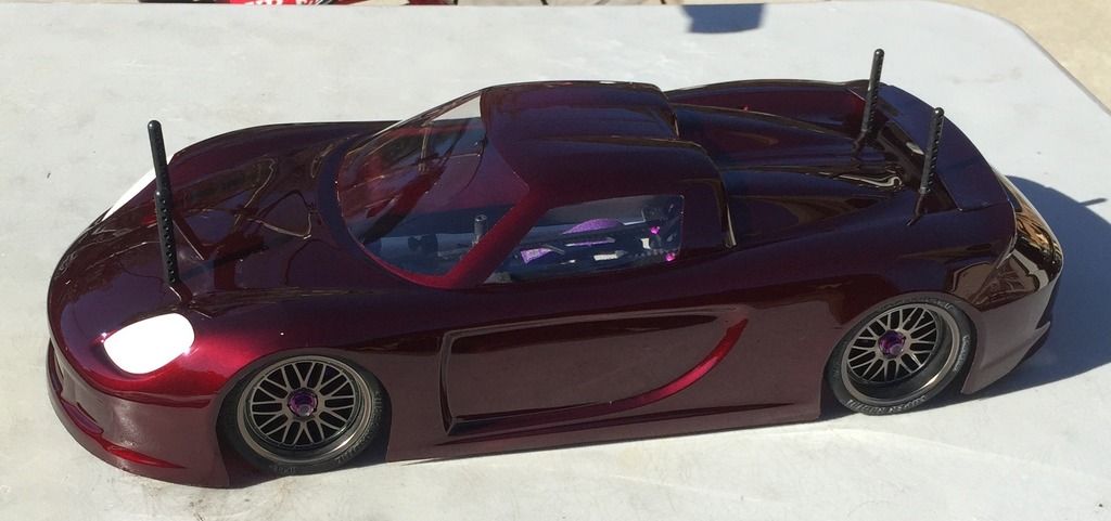

Backing a candy with. Gun metal silver gives it a deep rich color. I did this as a paint test on my RS4.
I sprayed the red
81F33055-81B7-4292-95D0-F5172A2108E5_zps
Then the gun metal
406CB135-D788-4EEE-AD15-E181EBAD8475_zps
Here is the end result
0F6F6722-D007-450D-A5BC-E85EFD9EF744_zps
