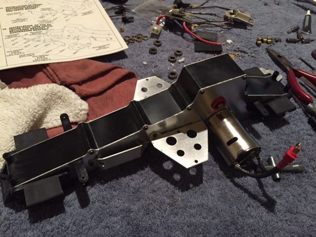

Got this Bulldog many years ago and started to clean her up. Kit was very lightly used, missing the front bumper and the tires are pretty much rotted. I also got a bunch of parts with this when I bought it and realized it was a whole kit still in the box! The condition of the car was pretty good except for the corrosion on the fasteners, the air shock and the rotted tires.
post-4843-0-96009000-1458037797_thumb.jp
You can see the the corrosion with the body off!

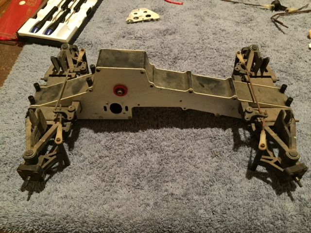

All the steel parts and fastners were pretty rusted.
post-4843-0-30201300-1458167454_thumb.jp
Put the parts in a bottle with vinegar and let it soak shaking it occasionally.
post-4843-0-81434100-1458167552_thumb.jp
Heres what they look like after about 5 hours.
post-4843-0-60756600-1458168247_thumb.jp

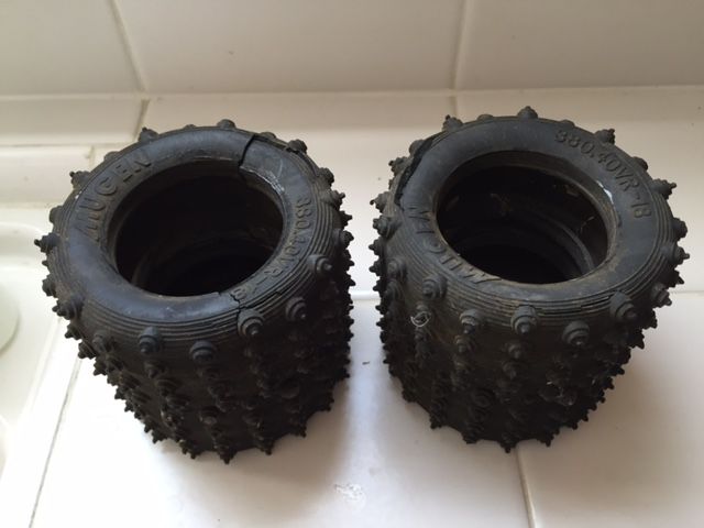

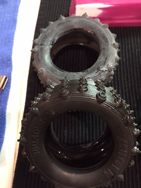

Here's what the tires look like, rubber dry and brittle with multiple tears.

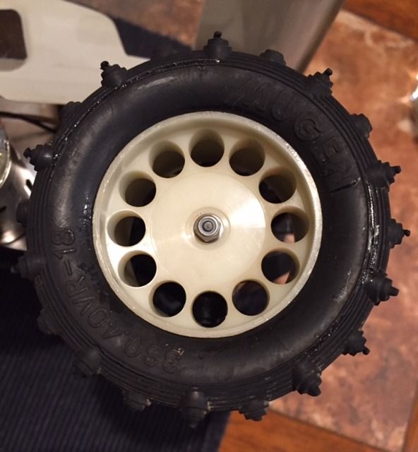

This is the tires glued and trying the paragon traction compound on one of the tires.
After 2 coats of traction compound applied soaking for about 2 hours each coat, then washing the tires with soap and water to get the oily residue off. Tires are softer and look so much better, the shiny glue marks are not that noticeable in person.

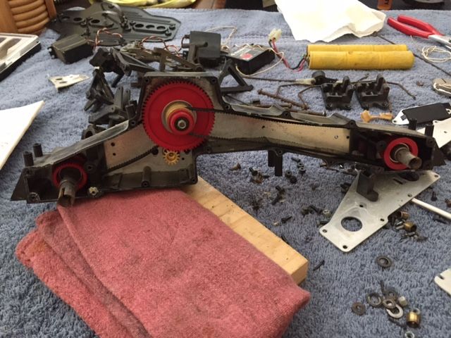

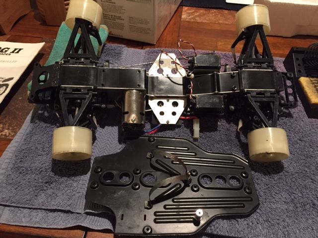

Radio gear and under tray off the car.
Side plate off showing the belt drive system.

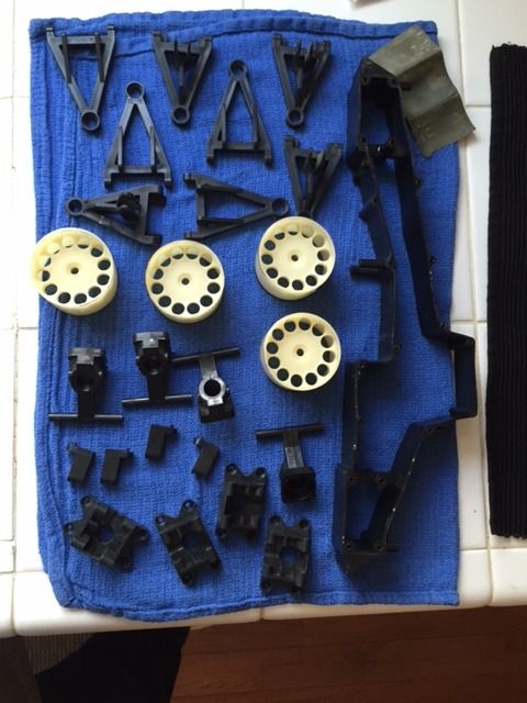

Plastic parts scrubbed clean with soap and water waiting to be put back together.

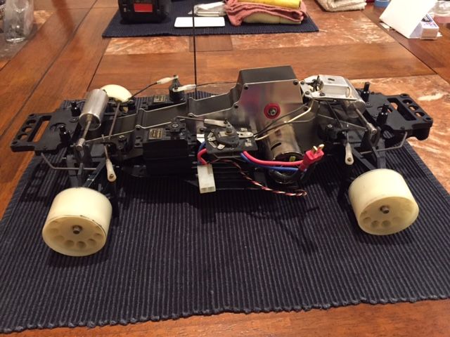

Got the drivetrain back together, why does this look like some kind of sci fi spaceship? lol

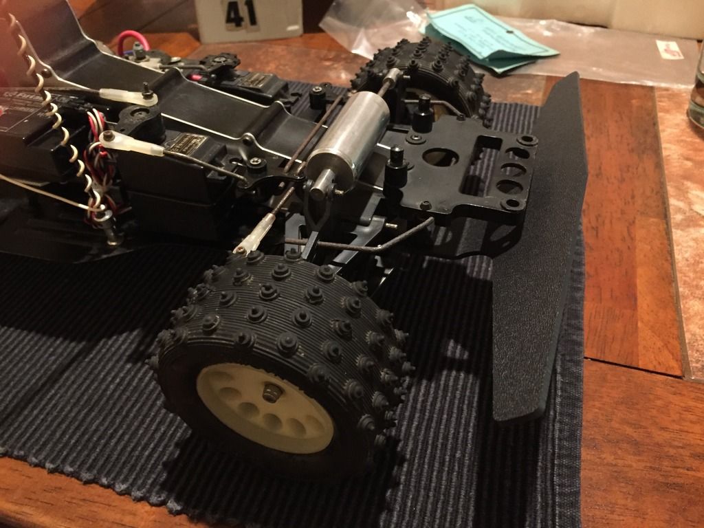

Suspension and servos on and skid plate showing the battery mounting strap.
Electronics installed and crusty motor replaced with a new 540.
Pic of the underside.

I used 5% white vinegar and it can be diluted with water if you don't want it as strong. Just be aware that it probably will remove any coating that might be on the metal parts.
