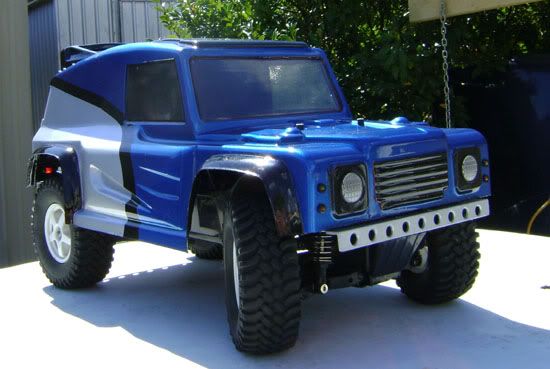

Thanks for all your help guys. I've made a decision finally! And the inner is a....
CC-01 ding ding ding lol. Sometime ago a buddy of mine offered me his rally raid style Bowler Wildcat for a fantastic price and I've wanted it ever since. So now it will finally happen. Here's some pics:
http://s567.photobucket.com/user/scattershield_racing/media/CC01%20Bowler%20Wildcat/mount4.jpg.html?sort=3&o=6
An interesting choice - not quite what I expected you'd go for, but a good model nonetheless.
While not the fastest model out there, it is pretty quick with the right motor and gearing, and also works well trundling along the trails at a slower pace.
It also has huge scope for mods and hop-ups. Do you have any in mind for it?
Actually it's already got almost all the gpm/junfac mods done plus its got a 1200kv bl outrunner in it.
