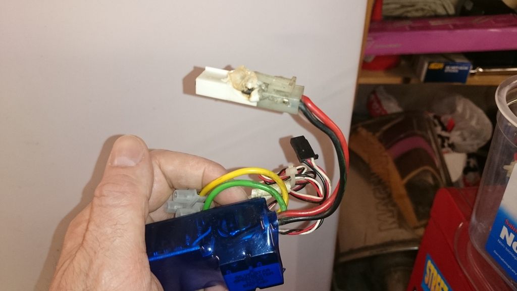

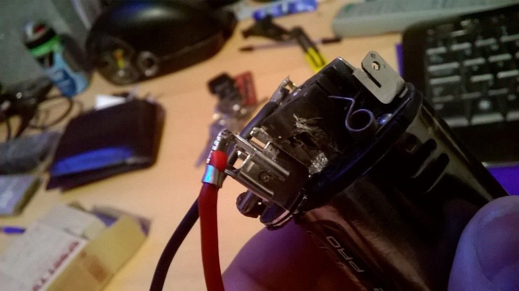

I see the endbell has melted so I think its quite dead now.

Help !!! What am I doing wrong? I have now managed to cook a brand new Tamiya Sport Tuned motor after only two runs. All was going well doing some doughnuts wheelies etc, then the truck suddenly lost power. The motor was so warm that you couldn't touch it and smelt burned :( . Even 30 mins later there was still heat in the motor. So charged up the battery and the motor is noisy and about half the power it should be. Now as far as I am aware the gearing on the KBF is non-adjustable and the sport tuned is a recommended hop up. I can feel no binding in the drive train and the original silver can doesn't even brake a sweat.
