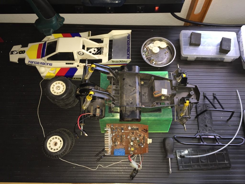

Disassembly

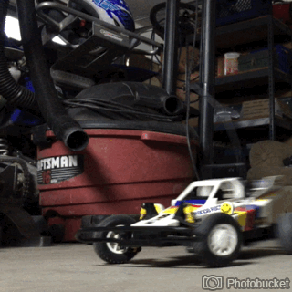

This little car wails with the stock 540 can and a lipo. The motor being attached to the rear axle makes the rear end loose. Lots of fun. Donuts for days... Haha
