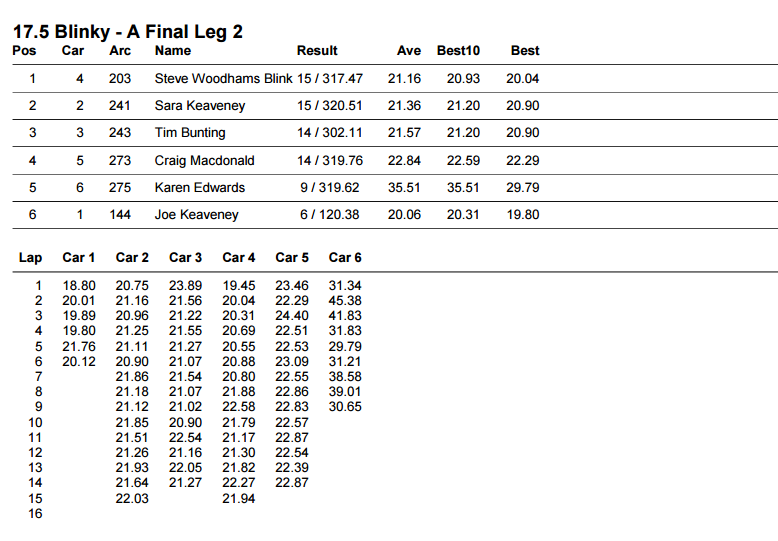

My shorty lipo conversion found me 2 seconds per lap!
But I'm still 2 seconds off the pace. And I drove my thumbs off yesterday.

It doesn't look like your placement is too far off. You're what, 4th? So how do you pick up a couple of seconds time? When I asked myself that question the biggest place for improvement was my piloting skills. Since I'm racing a TRF 201, like your rig mine is also "dated" by current design standards. So I asked one of the competitive drivers from the A main to take my car for a few laps. He confirmed that while my car does present some performance hurdles that a new chassis wouldn't have, it's more than capable of being competitive. I'm still in the tuning phase with my rig so maybe that's where you're at as well? I don't know what motor and timing you're using or what the rules are at your track but what I'm learning is that 1/2 the fun of racing is tuning your car for maximum performance then tuning your driving skill to match. I personally wouldn't change chassis until I have reached the ceiling of both.

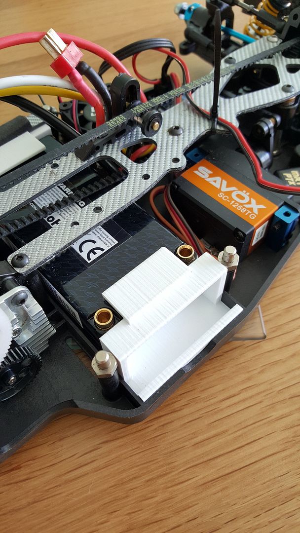

I don't suppose you'd mind sharing a bit of info about how you fitted the shorty pack in your TA04? Have you had to grind out the reinforcing webs in the battery compartment? I'm looking at buying batteries at the minute, shortys would be good for this and hopefully my DF03 too.

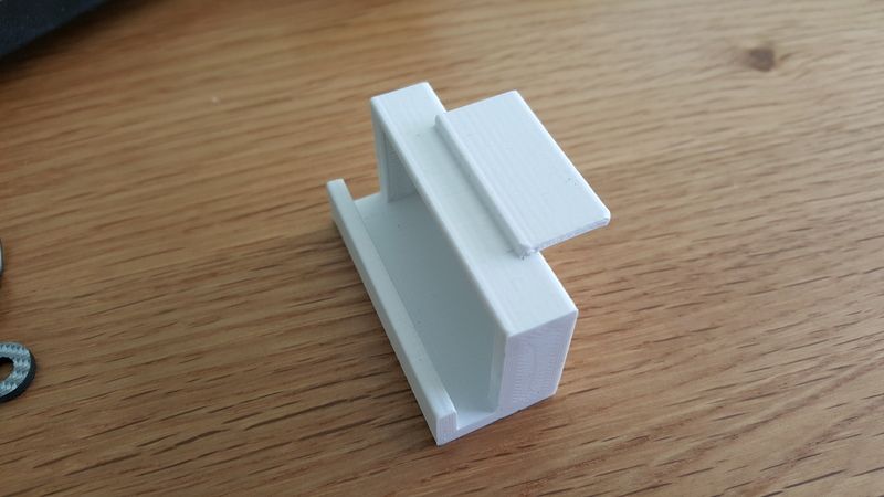

Firstly I bought the carbon reinforced chassis (that doesn't have rounded moulds to secure stick pack nimhs). no grinding needed. I also bought the SSG carbon battery straps. Then I designed some retaining blocks as pictured, got them 3d printed, and job done.
I need to design another pair of blocks (or a once piece retaining strap) for the super shorty lipo cells I've just bought.
If I'd stuck with the original TA04 chassis I would have had to do a lot of dremelling!
