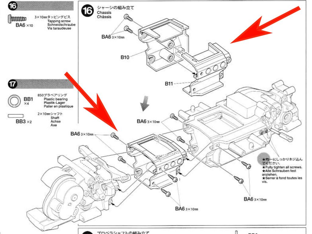

I was considering chopping around a TL chassis to fit my Brat body (I want to make it a proper 4WD) but this chassis with the right combination of spacers might also be a good option too?

@ Jenny,
the chassis without spacers has a wheelbase of 170 mm. Spacers that come with the kit are 15mm, 30mm and 40mm. The brat body isjust under 10" right.. so 2 40mm spacers would be the closest match.. would be interresting to see how it fits.. :D
300058629_Bauanleitung_MF-01X-11_zpsf6at
I only used one spacer on my City Turbo so if you want the other two to make different combinations let me know. I am suprised more have not been made of this chassis yet
