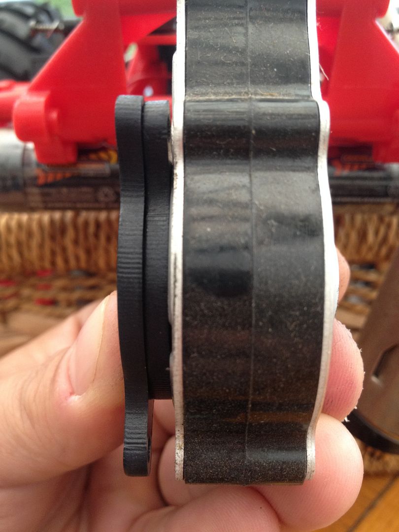

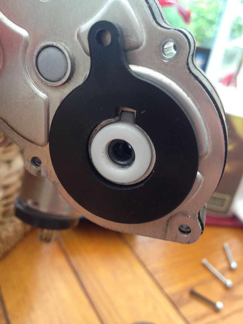

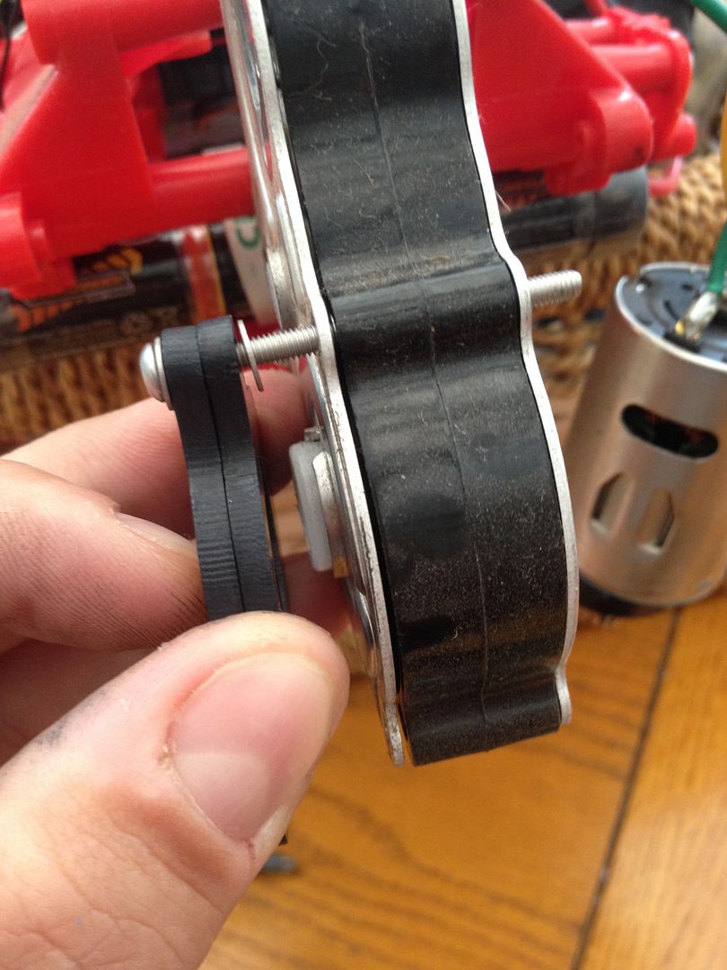

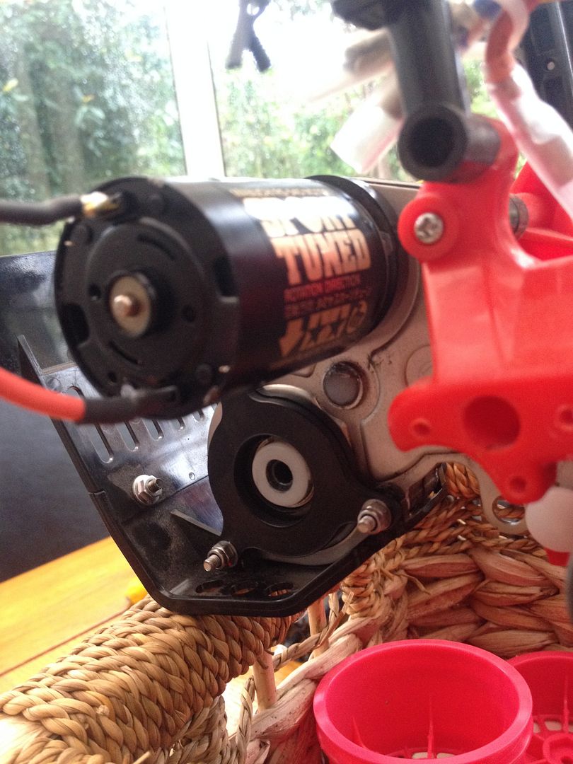

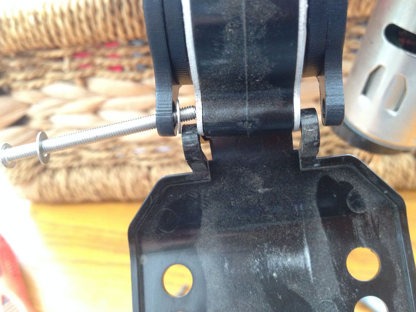

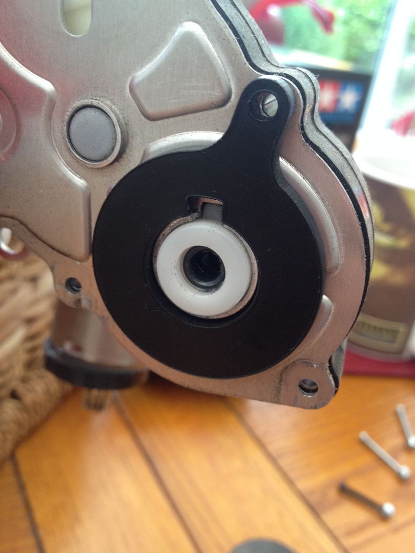

quick guide...
really simple little mod
remove both rear suspension units at the chassis (put the screw and washer back into the chassis to keep safe)
remove the 3 screws each side that hold the rear swing arm in place
totally remove both rear swing arms including drive shafts (inc rubber covers) and gearbox joints (BB16 and 17)
then unscrew the 3 bolts from around the gearbox/diff  housing
then offer up the 2 strengthening rings with just 1 tab - they will only go 1 way
not..
then you can offer up the 2nd set of strengthening rings with the 3 tabs
(you can see here why the washer needs to fit where it does behind the first ring's tab)
At the bottom the space is where the rear bumper on the beetle fits
washer in place
and all first bolt and washers and nut in place
when reattaching the rear bumper, as there is no OEM washer between the bumper and the gearbox/diff so i placed the kkit washer between the 2nd strengthening ring and the bumper
here it is fitted and the new sports tuned 540 fitted
Hope that helps/gives confidence to others
