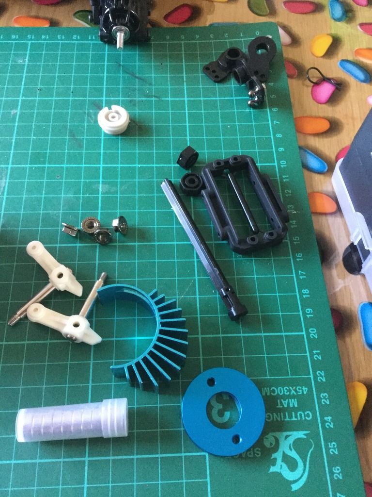

A quick look in the spares box and I find
EC99B004-2D15-4576-8720-CF1EEA322B0F_zps
can you see where this going?
8CFB2DDA-7336-48D0-92D6-BBFFB1FDFAA9_zps

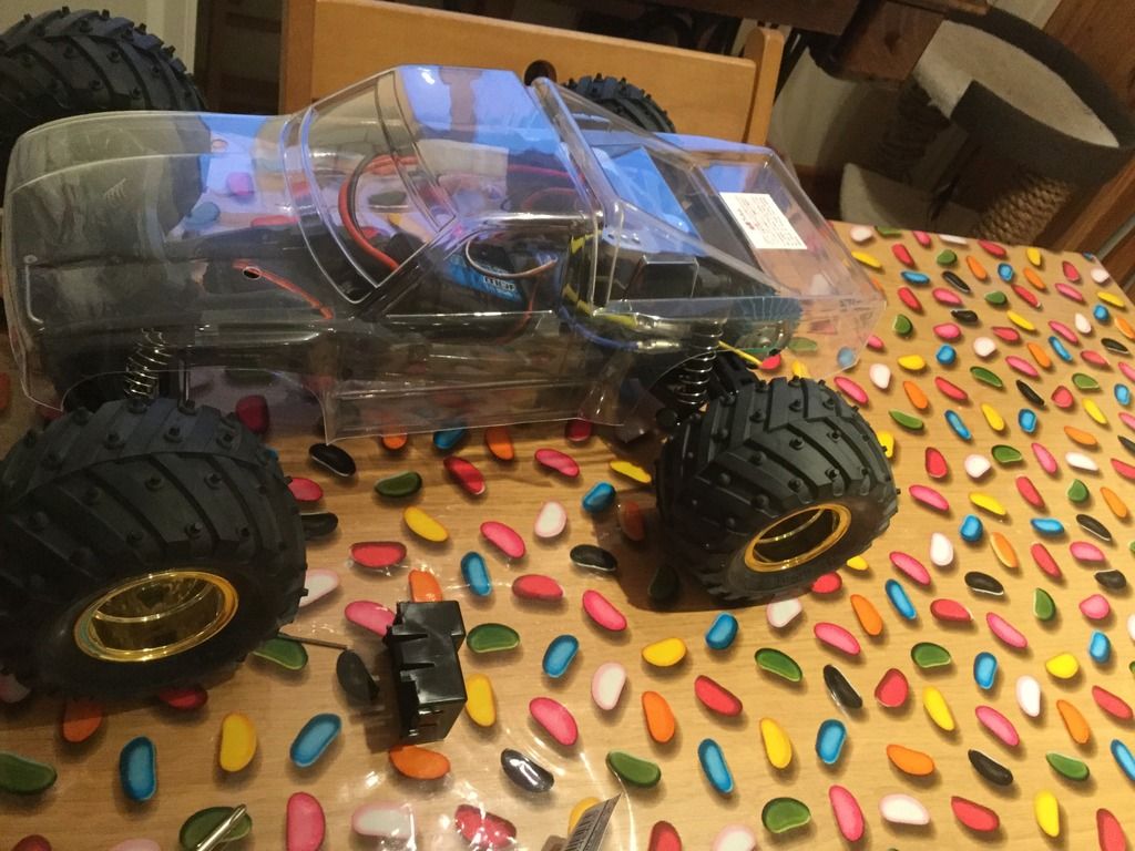

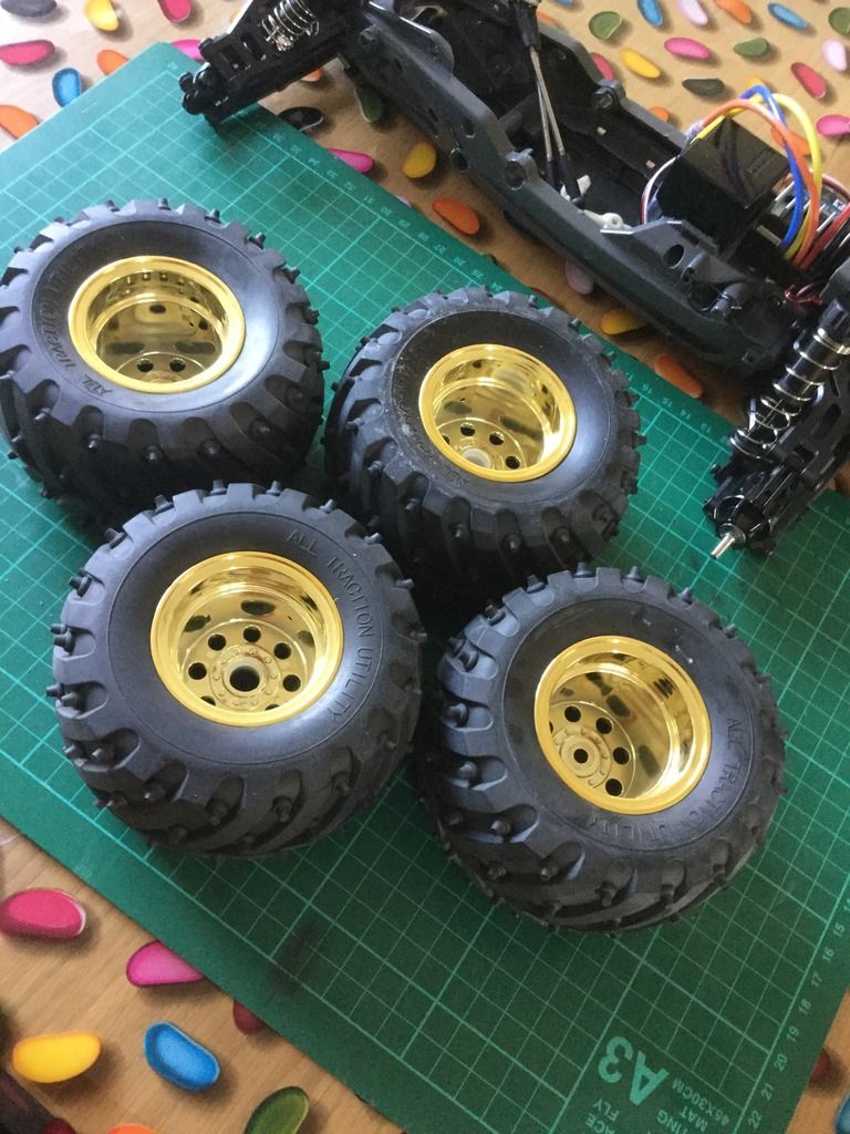

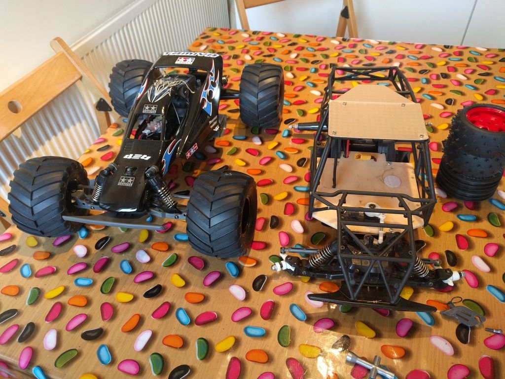

I have the wheels kicking about so monster DT-03. I know there are fears about over heating the box on these with big wheels but I will give it a go.

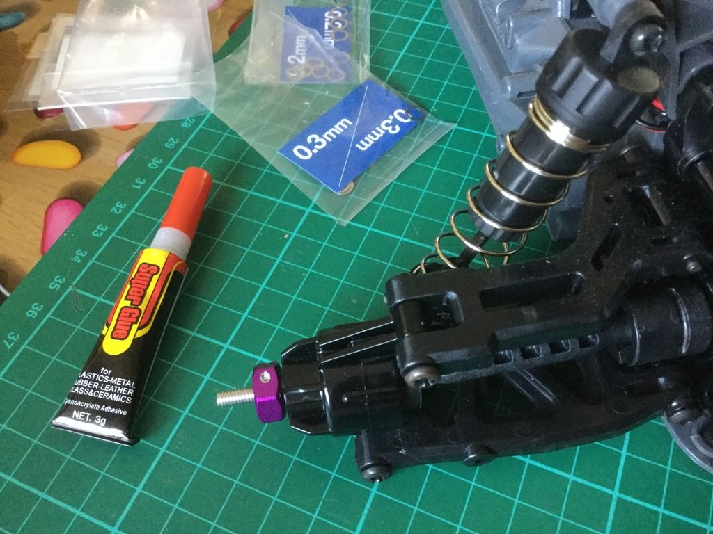

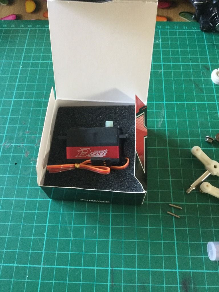

Servo from the cupboard
BB4620D6-BC1B-461C-83D1-C0F58BE0A09F_zps
Super glue on the servo saver

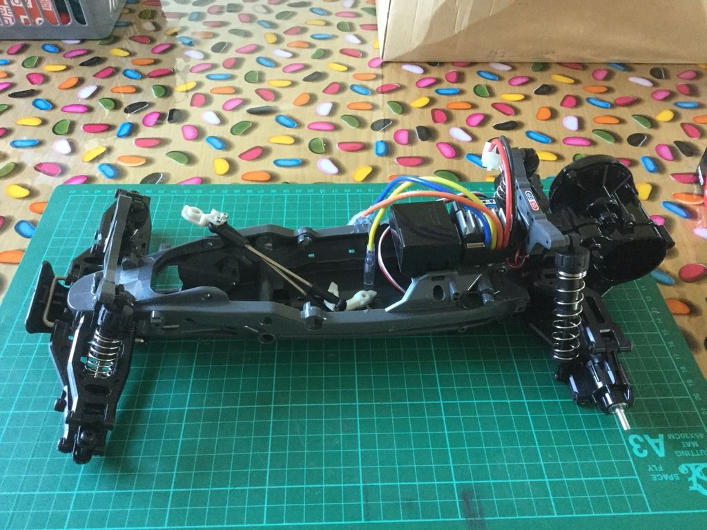

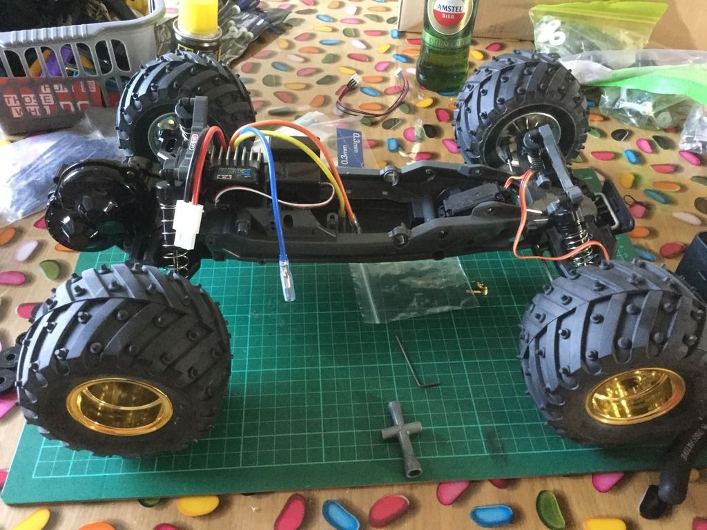

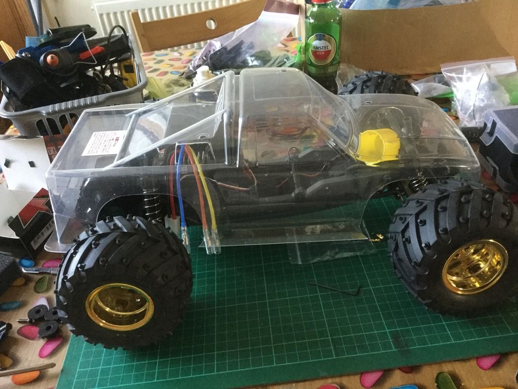

So here we go
ADF259BA-2510-4F0F-806D-1CD29A835C55_zps
4 minutes ago, XV Pilot said:
Looks good so far! Do the body holes fit the Aqroshot post locations?
Front are in line but not underneath. Rear are a mile out

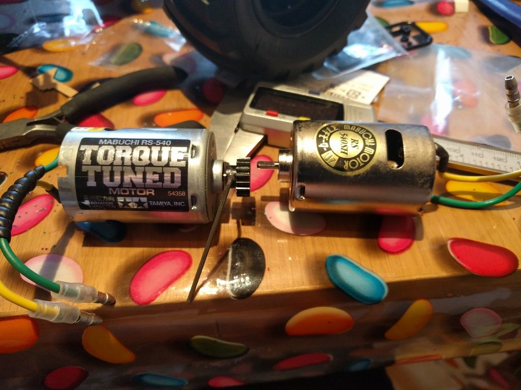

Cool !  You can always run a 35t CR Tuned motor.  They are still fast enough to blast around with big wheels and either pinion (17t / 19t) and decent run times compared to a silver can.  We tried it with a friends Acroshot with the big chunky truck Dirt Hawgs.  Makes an awesome gravel basher !
I wil try a silvercan and see how hot it gets. I cannot find a mod 08 pinion in 15t to fit with a modified plate

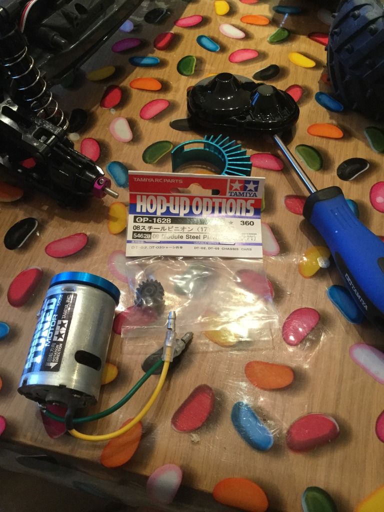

So motor time
F1415113-9679-4EA7-93C5-D7564D485A20_zps
Silvercan, Torque tuned or maybe Sport tuned on the stock ESC.
10.5 brushless on stock ESC
4000kv waterproof setup
23t cheap motor from Japan on a 1060
I do have a random 3s soft pack that would be well protected in this chassis so I could run silvercans to death on that and a 1060
What do people think? Need to use up what is in stock rather than buy new.
Anyone know of a 15t steel mod 08 pinion?

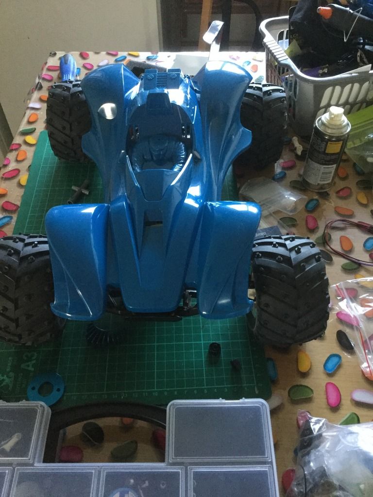

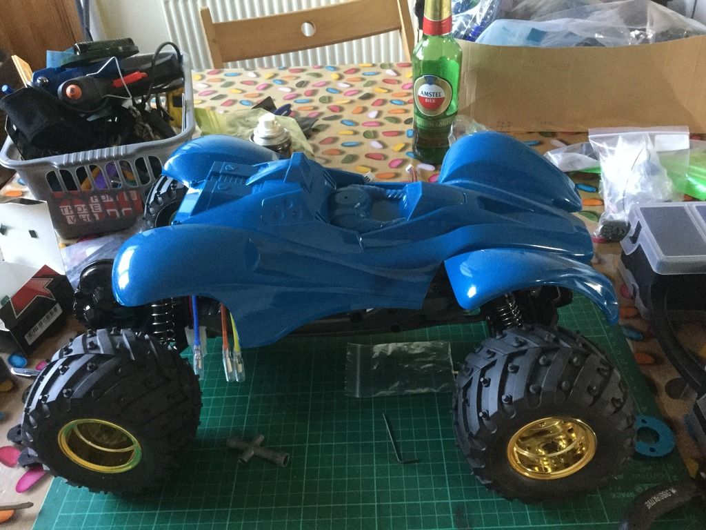

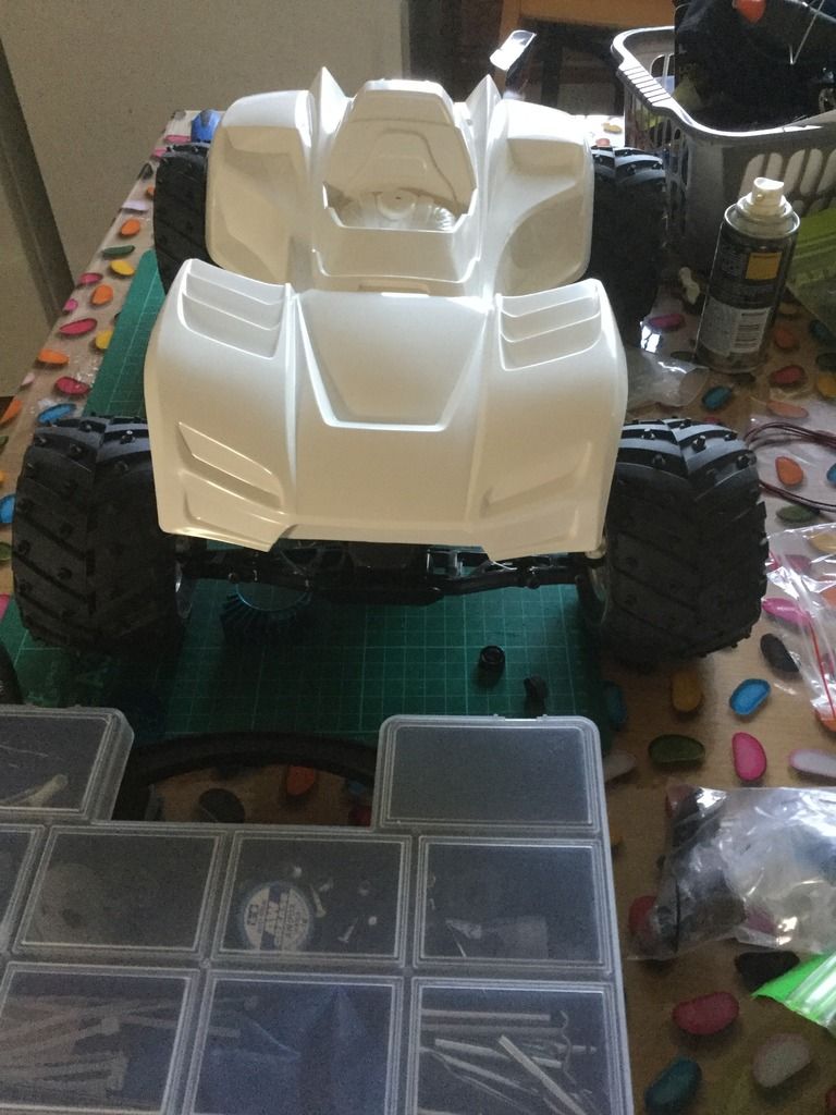

Shell trimmed
64094980-26D6-4110-8C43-D076CCD78CE8_zps
not a bad fit. Well base is a lot longer than original but it does not look to out of place.

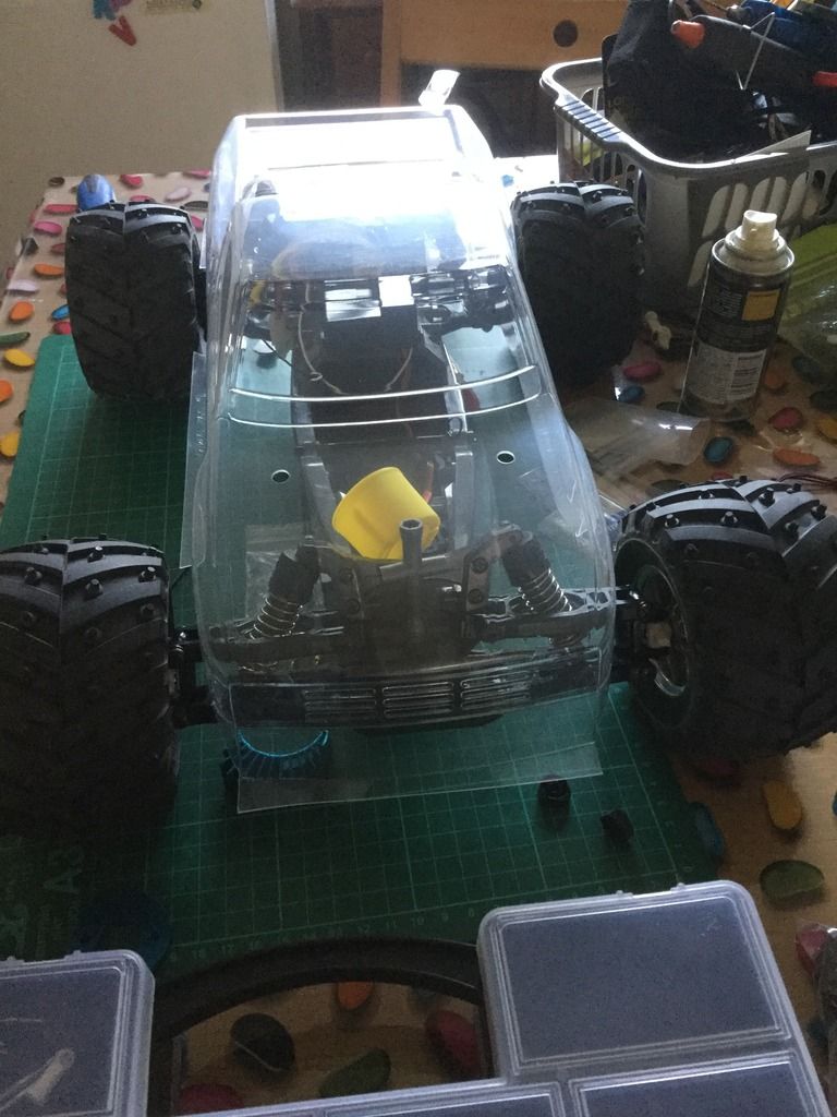

Will run with a torque tuned and heat sink for now and see how it runs
0708C939-FF97-43BF-863F-8B17BE059984_zps

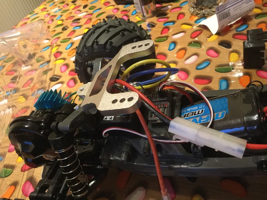

Shell mounting points are not very close but I did find this lump in my box that lines almost exactly with the rear body holes. It is made of chinesium so is not as heavy as it looks.
3BC0D9EA-C7F3-4E5C-A887-768E4AF41D92_zps

Sorry box polishers, this has been sat in the window for ages and I thought I should build it before my wife gets very fed up of it being there.
476A286A-93E1-42CE-A7B4-F83DC1E15390_zps
The body is being used on another project so I have no idea what to do with this chassis yet.
CCA72A17-8F44-4A3F-A30B-AC6160288D2E_zps

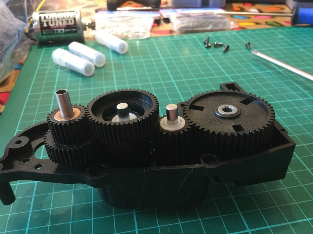

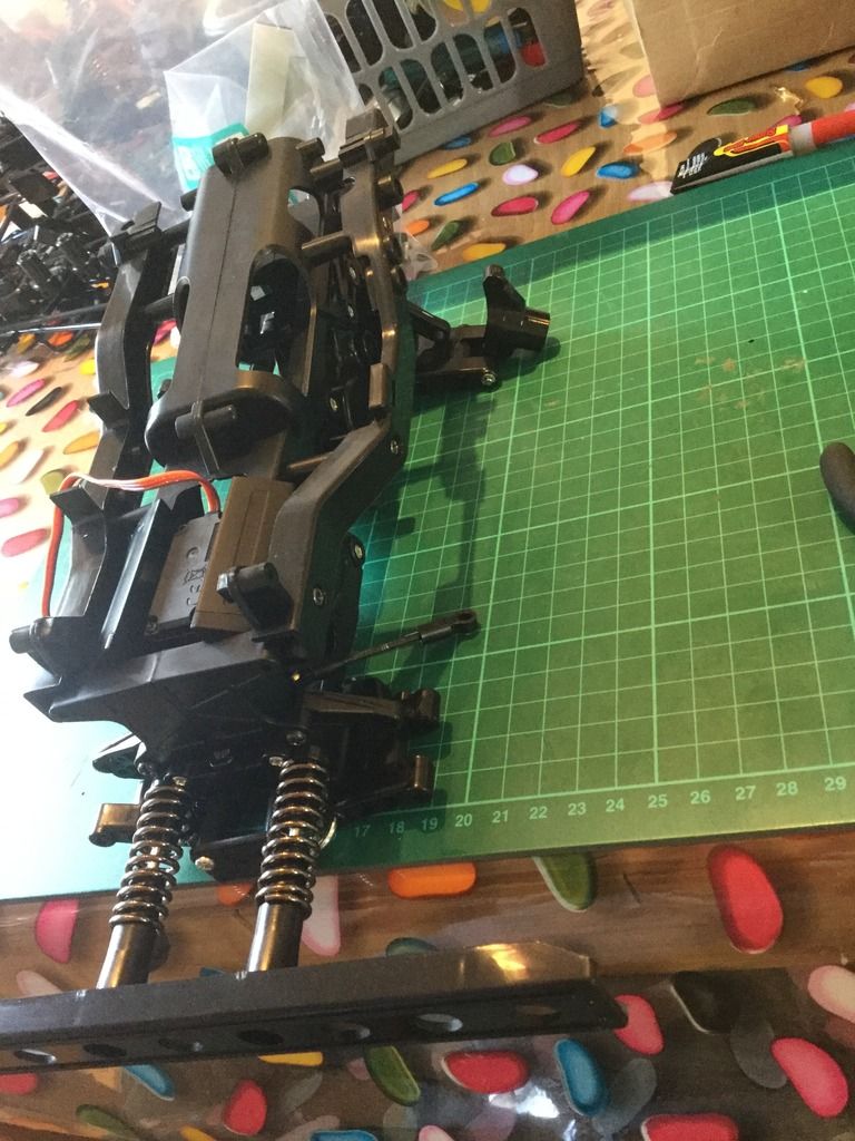

First things first. Lob the motor in the motor box with the others and dig out the bearings.
FF0DA8B9-26EB-414E-8F40-4C90EAE908E0_zps
There is not a lot of grease in here, which is a good thing. I am sure the old white geared boxes were stuffed with to much grease.
E18695BD-3EF8-4809-B7DE-D951FF46E0F7_zps
Enough done for tonight
7E8A4F96-08E7-4D0D-9815-F6B80A5D369F_zps

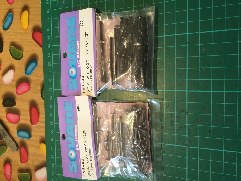

Not sure how or why I got two machine screw sets to build this with. I am not using them anyway...

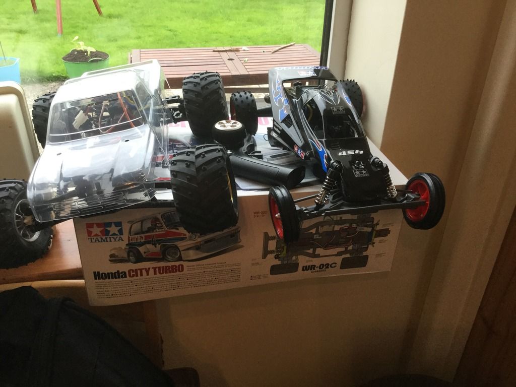

will be on its wheels in no time, if I had any idea which ones to fit that is.
I have a couple of sets of CR01 wheels with WR-01 tyres so they would work, but what body?
Wheel not a good match but I have two sets of WWII ones I can rob the rears from if needed.
What body though?
Needs to be short and cheap
2 hours ago, Nobbi1977 said:
I might have to get the tape out and find out.
Need something crazy for this one I think.
It is stealing from one of my ideas for a project but...it is short, cheap and crazy on that chassis / wheels.
Coming in at 210mm wheelbase, the Kamtec Morris Minor van in ABS.
