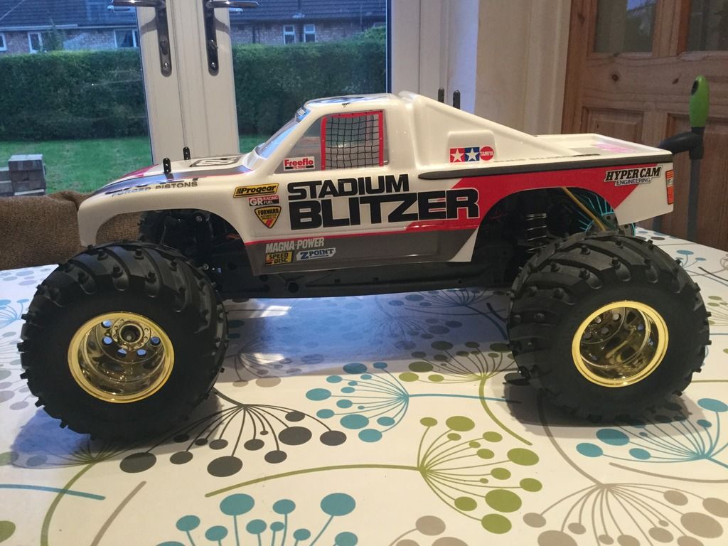

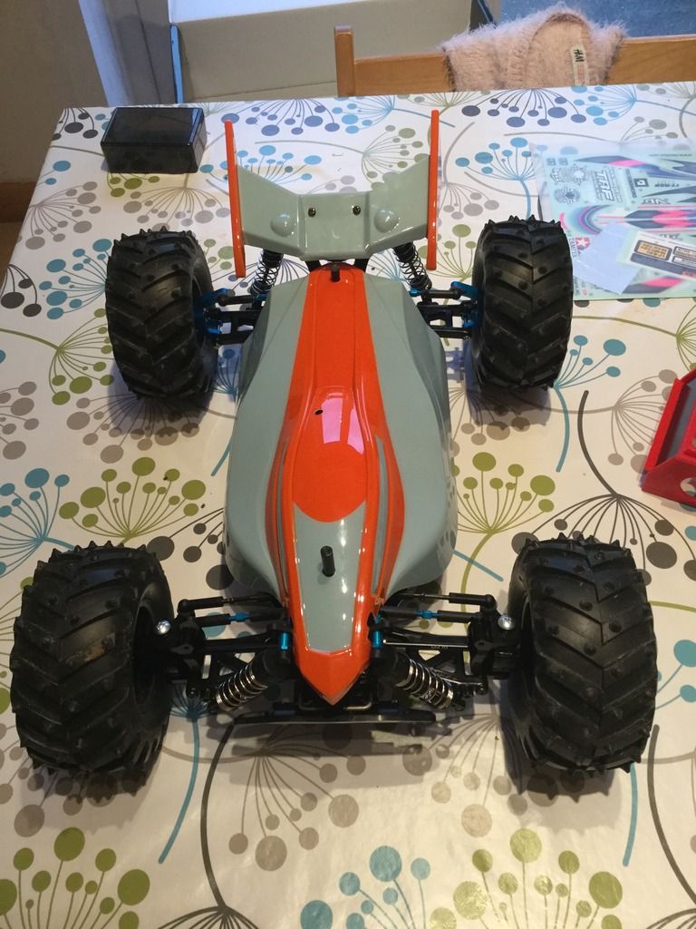

36141129-AB9D-4A41-B394-0935BB15CA83_zpsGot fed up of looking at my Stadium Blitzer DT-03 and in light of a couple of fantastic paint jobs on here I would be afraid to drive I thought I would just get it done.

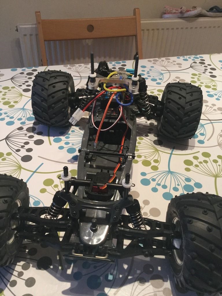

I had no good front mounting option so I did the Tamiya Re-re trick and drilled two more holes.

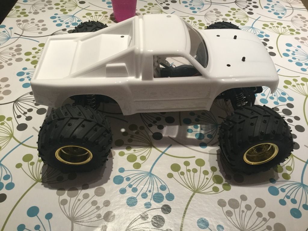

I looked at the shell and to mask and paint it well would require so much effort I would not want to drive it.
I found and old tin of white and black and was going to do a fade paint job. Looks like there was more white in the tin than I thought.
6C915F22-917F-4377-9ABD-F5F28F3FC8DC_zps
Rear body mounts and stickers and it will be ready to roll.
I did not build this car so It is going to have to be stripped and rebuilt quite soon so I know it is done right

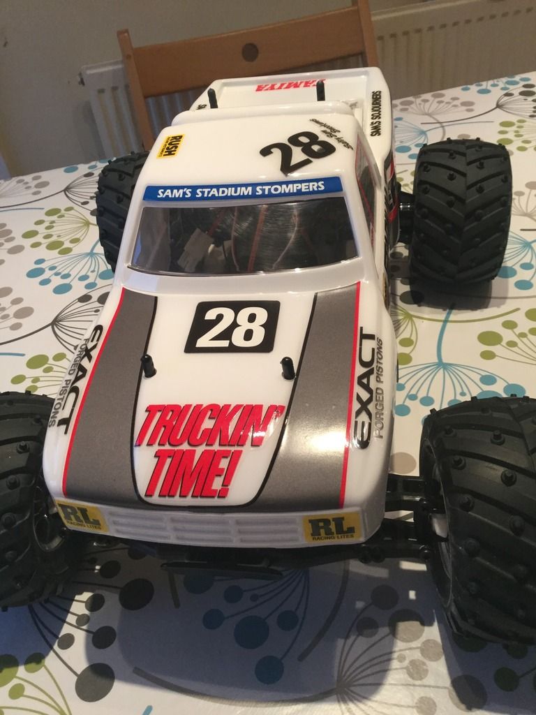

Off work with the norovirus so got some sticker time in.
not 100% box art as I wanted to cover the roof hole and not have the side number boards on. The bonnet stickers cover the original holes so I am well pleased.
BCADF0D1-B7A9-457A-9FC0-34CCE3369FFB_zps
CB12E085-8DF1-4C3A-AC63-3C130FA6C6A8_zps
2E1B37E8-C023-43C6-9C5F-0EE03ABC5A64_zps
86CA346D-FC83-4330-B7F5-604AAE28AEEE_zps
My other DT has stadium wheels and tyres on so I might have to swap. I think this one will end up with CC-01 wheels and WT-01 tyres in the end though for grip and ground clearance
Looks great, nice that the decals covered those holes, do your front wheels clear the front bumper at full lock?
Now you just need to rip out that weedy esc and go for a top speed run ;)
Wheels clear bumper and arches.
Think I will try my cheap Chinese motor combo in it. Diff is open and it is on plastic drive shafts so not sure what 4370KV will do......

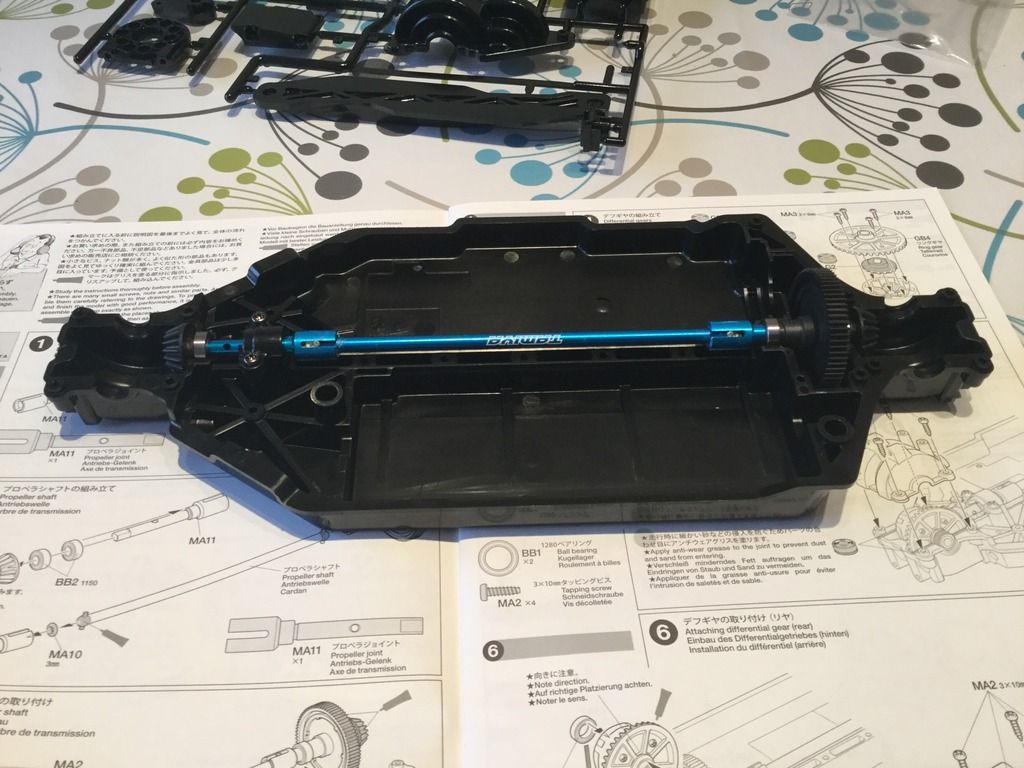

Spare time so I thought I would start a build.
A3B81960-BFE7-4C24-8B8D-1D1D468D70F4_zps
Lots of blue bits with the MS. I am sure I would have hopped it up in the end so saves time now. Build the diffs stock with a bit of putty in for now, will see how the survive before metal upgrades get ordered.

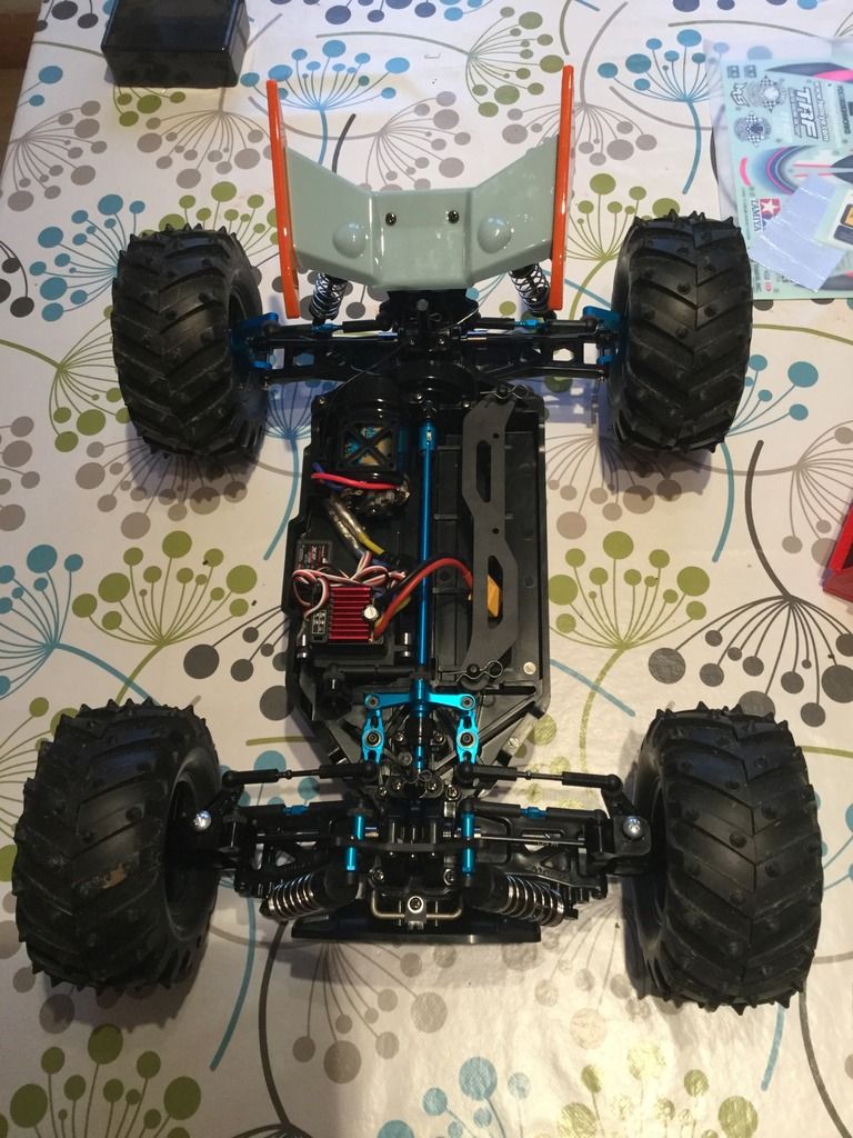

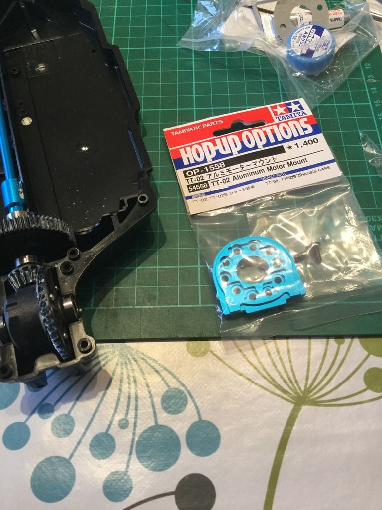

This was supposed to be a build stock and then upgrade affair but I had to add the motor mount.

Pinion is steel out of the box, finger is not.

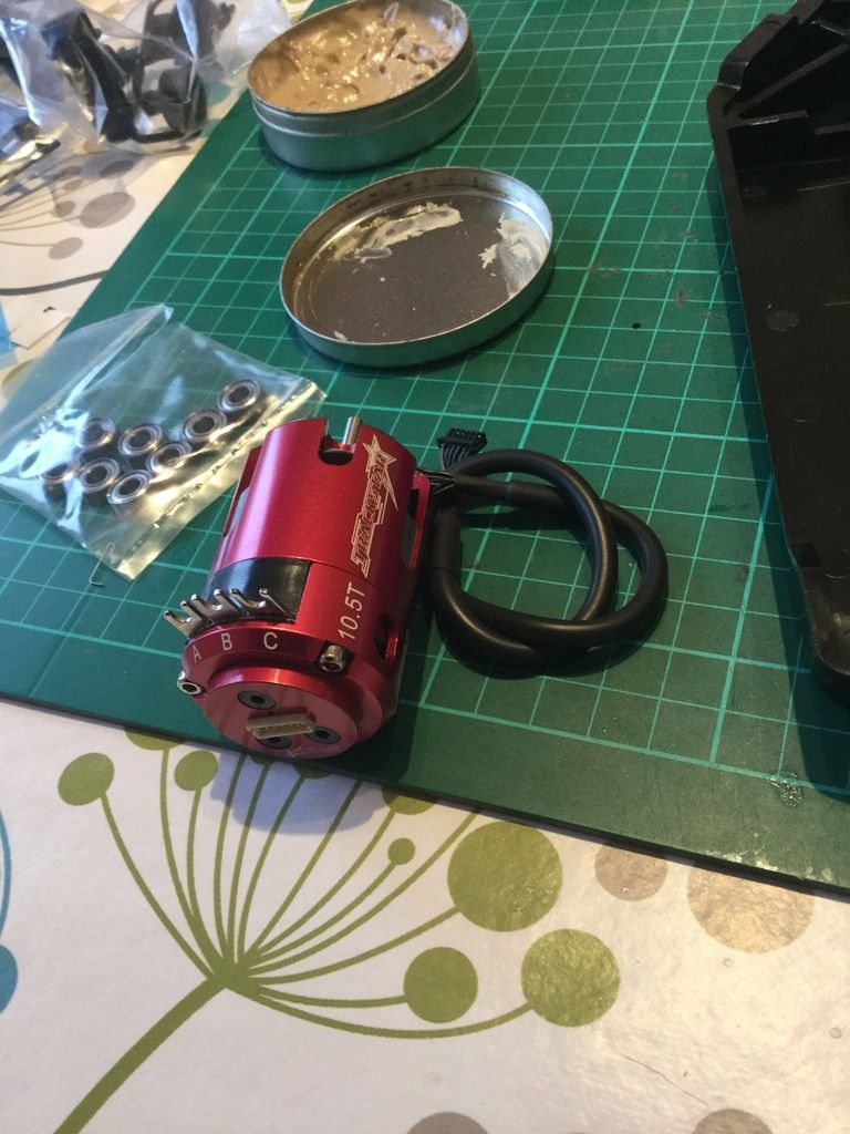

First choich of motor but though it might be a bit much for the Tamiya ESC. Run one on my WR-01 with no issues but thought best to try something else. Have a 1060 in stock so though I would try this cheepy.
974BB3DB-CF99-4390-821C-E5931932651A_zps

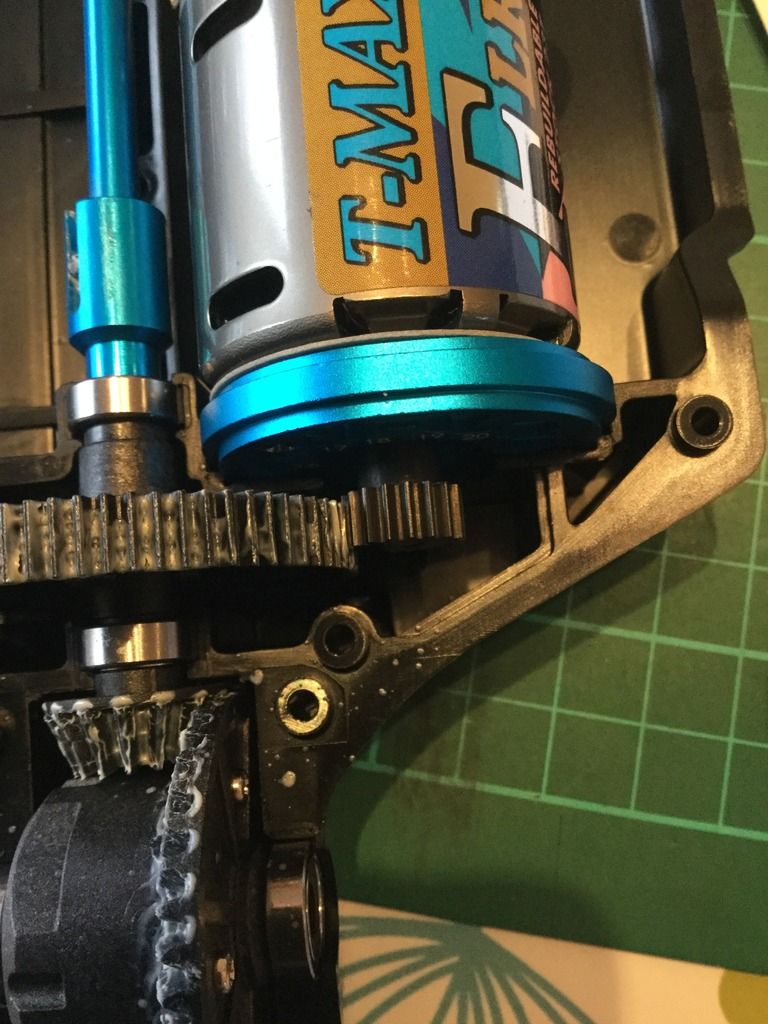

Instructions did not line the pinion up very well so I changed it

Done for today. Shock to be built and steering to be added. White shocks going on sons DT-03 and black on here.
I might have had a small slip and ordered a steering kit and universals so will wait for them to arrive before I carry on further

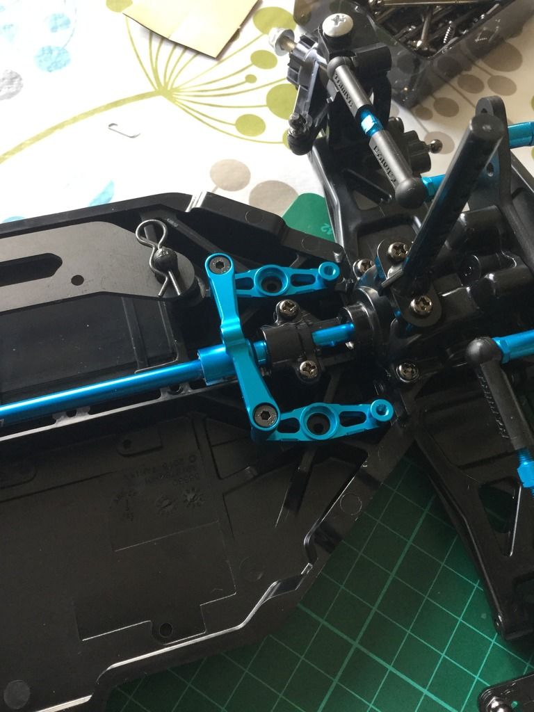

YR steering set up. This is going to need some shimming to make it tight, I am not impressed out of the packet

Back to your DT03... I was confused how you mounted the Blitzer shell... you've used some other rear posts and fitted them on top of your aluminium wing mount?
 I only ask as I was toying with a van type Bodyshell on the DT03 and was looking for some way to get tall rear post mounts.
Just checked your front mounts too.. are they mounted normally ( on the side of the chassis) or have you modded them to fit on top of the shock tower? Picture is hard to tell, again I'm curious for a taller front body post.
Edit: Your front body posts look like  they are the DT-03t angled posts?

@Jason1145 I am not sure what the front posts were off, I put all my old ones in a "posts" bag and dip in as I need. The rear is a random alloy mount mounted horizontal off the shock tower. I had to drill new front holes and if I did it again I think I would just use straight posts and drill the shell at the back as well.
