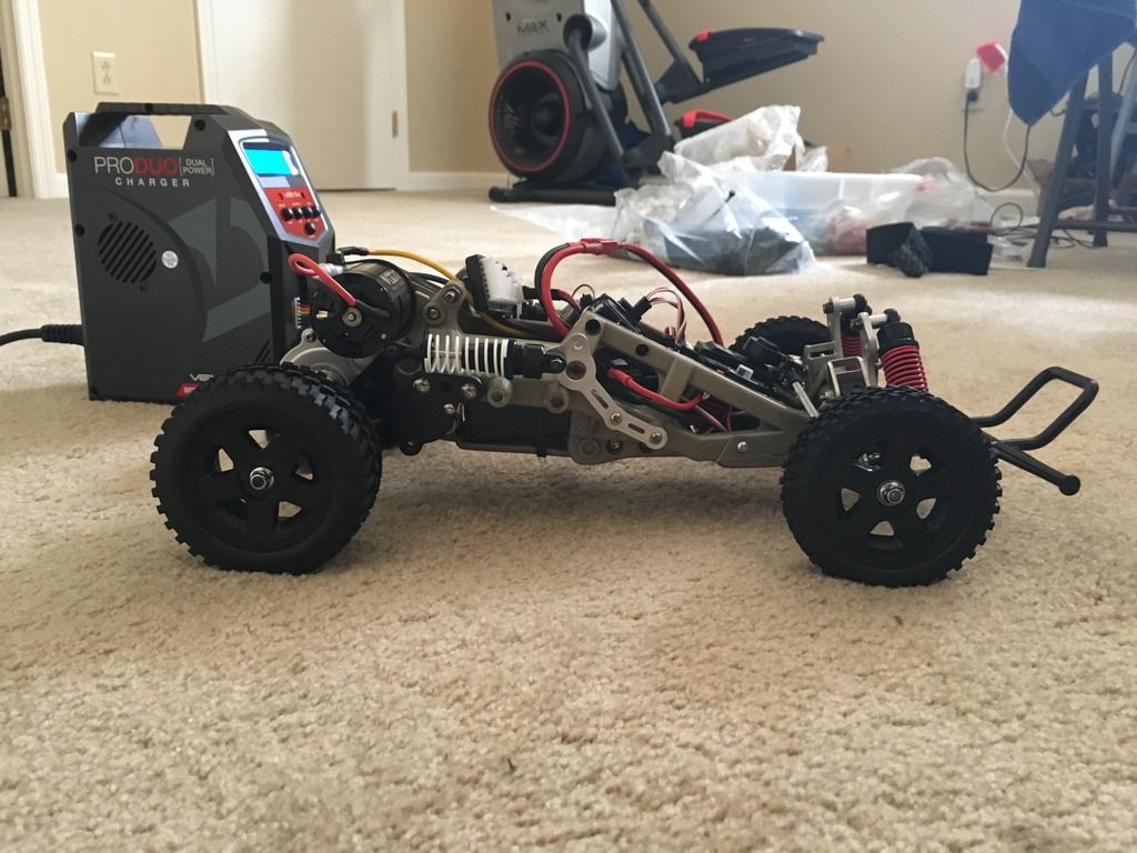

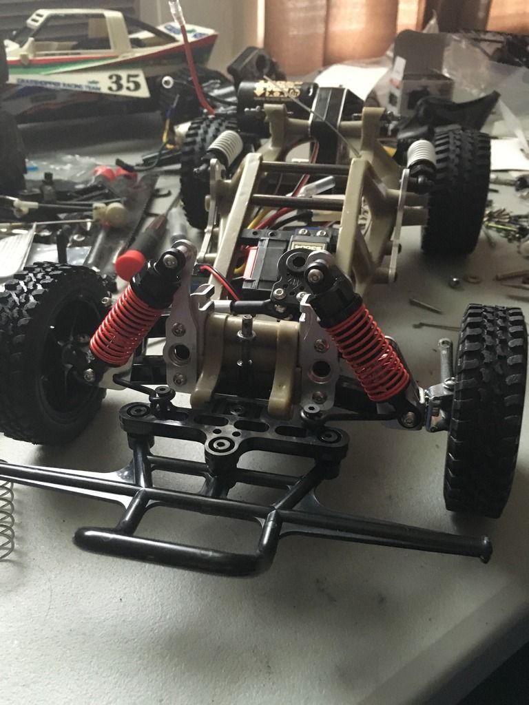

Yeah, sorry, I meant that I was using the losi shocks all the way around. I have read through your TRF frog thread many times, actually! I was hoping it might be you to chime in. I am using two shocks, though, vertical style. I modified an ebay shock tower I found that was one piece. I cut the center connecting section out, as it was plenty beefy, and I just didn't like the look. I'll take some pics when I get back home.
So here's my setup. the Losi shocks fit just about perfect. The fronts I used a 1/4" spacer, and the rear I used the spacers that came stock with the shocks, on both ends. I found a bottle of 35wt oil I forgot I had, so I'll probably start with that and see where that gets me. I know you used 40wt in the Mini T shock, maybe this will get me close. Might be a bit much with the 2 shocks, though.

Looks all good to me But it's the springs and damping that I can't tell by pic's.
The Frog is a light buggy to start off with so a soft spring set up is important in order to work effectively. The rear is a lot easier to sort out then the front.. As I said in my TRF Frog thread I found small Losi Mini T aftermarket shocks to work the best with the light front end ..
Doesn't mean it wont work with bigger shocks just the springs would be harder to match. I like what you did with the one piece shock tower up the front. Looks so much better.

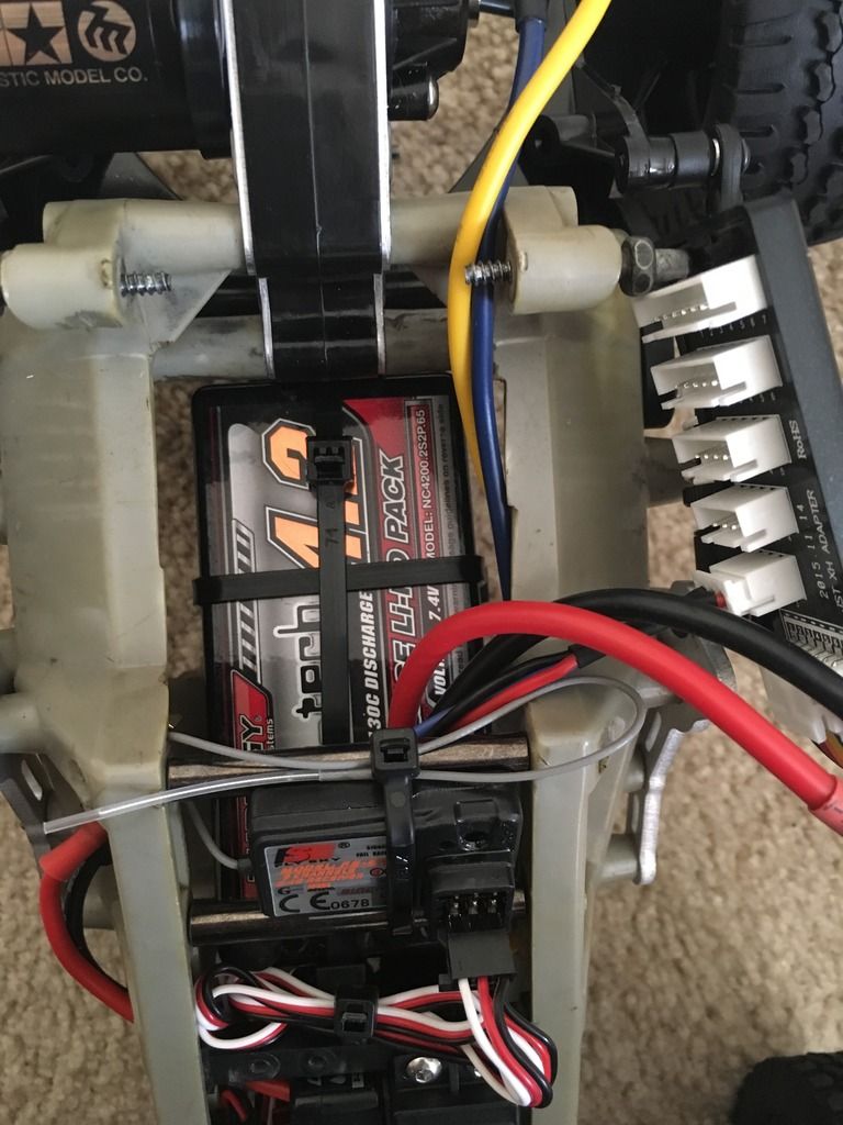

Quick update while I wait on the battery to charge. Front shocks I think were filled with diff fluid. Maybe not, but it was insanely thick. Refilled with AE 20wt, we'll see how that goes. Also, my shorty pack came in, so I played with the mounting a little. Most of this is temporary, but I think I like the battery lengthwise like this. Almost like it was meant to be. Kinda hard to see, but it fits almost perfect. 5CFD0035-C2B8-40F4-8F39-1A5120FC4BE7_zpsAD4CABD0-FA8D-46A9-88C9-DFA31284C2E7_zpsE3D16946-C1D5-4712-9BB3-845D84B3E22F_zps
Initial impressions... It's a blast! Has tendency to traction roll in the high grass of my yard (been too hot to mow), but admittedly, that's more my driving than the car. There's a little jump at the end of my driveway, and it handled it great! It does push a bit, and then the rear lets go on pavement, but again, the was just me playing around. I think my evil plan is working well. Forgot to mention, I'm building two of these little guys, and setting them up for FPV racing in my house/yard. Out the back door, jump off the deck, around the house, then back in the front and through the living room! (Before you ask, yes, I'm single). Going to take some getting used to to keep them from flipping, but I think it's going to be a riot! Now to put the other one together while I wait on the camera systems.

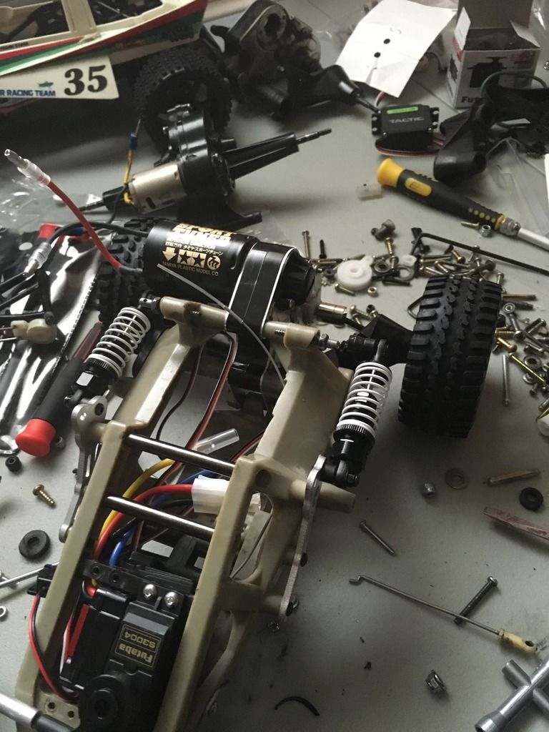

Got started on Frog #2 today. Going a lot easier now that I have everything together. To my surprise, not only does this one have the CRP mounts for the rear trailing arm, (they both do) it also had the bushing in the transmission, too! Here's where I left off today. Gonna get the other body painted when I get to the LHS. Wondering what color to paint them both, guess I'll see what they have in the store.image.jpeg
And my bench is still a mess. Trying to get this put together to make room for the Egress!

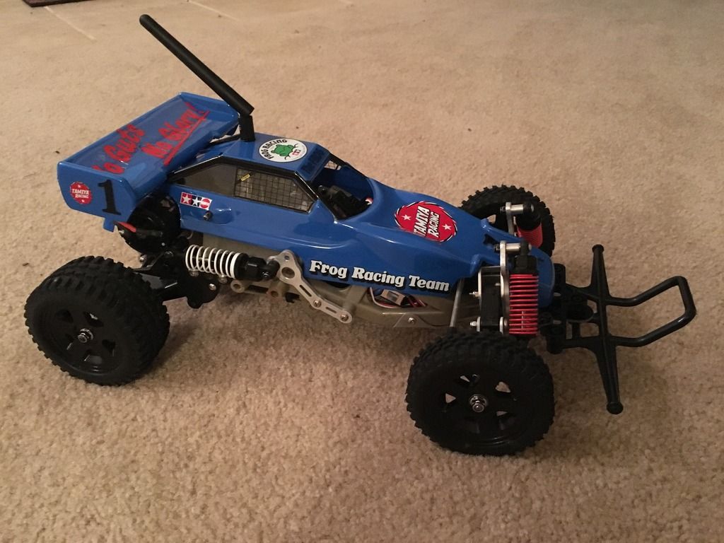

Ok, so I should have been getting ready for my vacation, and I could have probably started on my Egress, but I wanted to get something actually finished before I leave for a week. So I painted Frog #1. Didn't want to go totally box art, since I'm building the two as racers, so I picked up some Tamiya blue and red. This one gets the blue, for no other reason than it didn't have the red CRP plastic pieces on it. 5DA6D6DE-C2D4-4E09-A245-3B76082EC696_zps
Had no idea it would come out so patriotic looking! Scrimped a bit on the stickers for a little cleaner look. May take that frog off the top, now that I'm looking at it again. Wanted it to be recognizable, though. Going to do the other to match, but of course use the #2 stickers.
