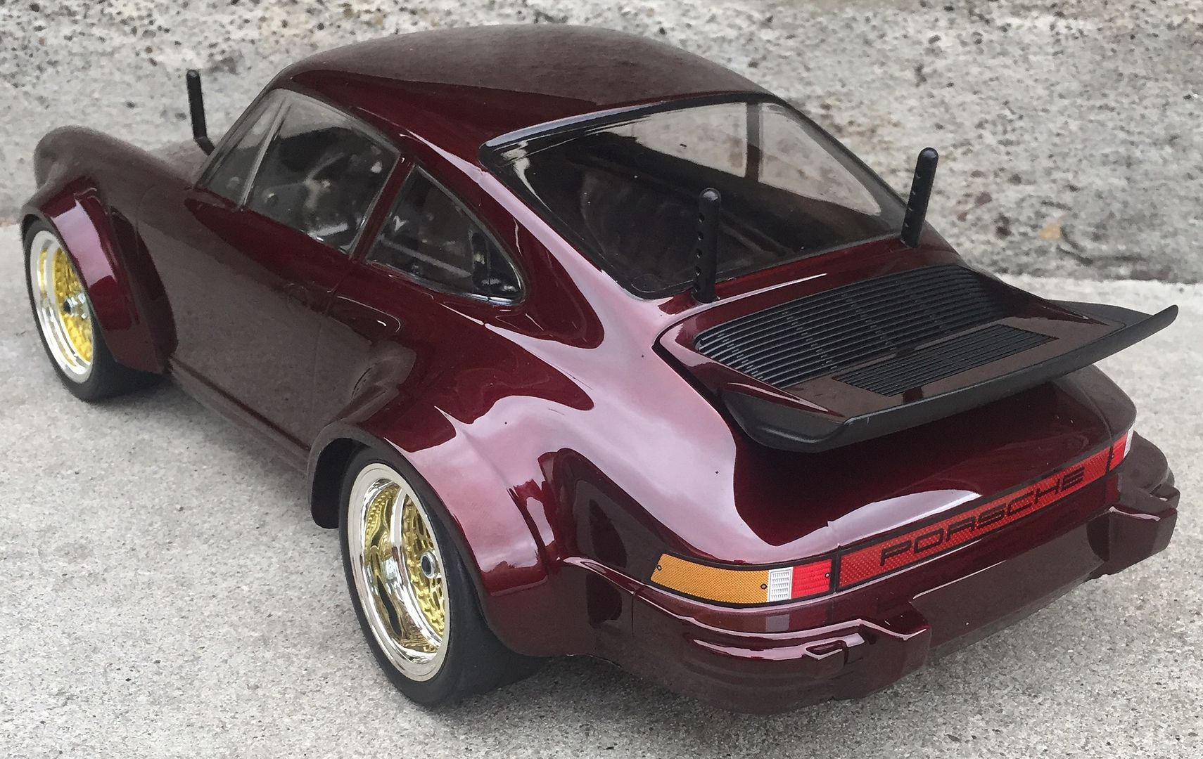

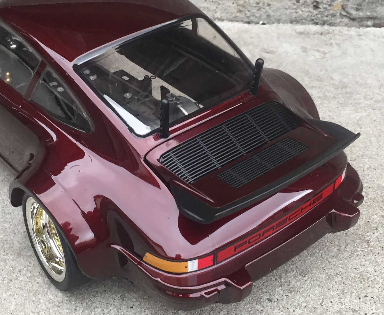

slowly making progress. Painting up the wing takes the most time.  Primer, Base of gun metal, Finish coat of translucent red. I sprayed 5 coats of clear, flat sanding between the third fourth and fifth coat. Taped it all off and shot Matt black.  Well pleased with how the clear coats get it close to the shine of the body.

Fantastic stuff here! Good work man!
