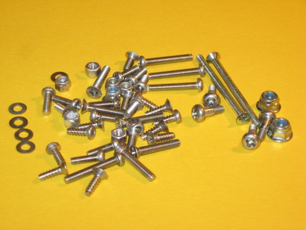

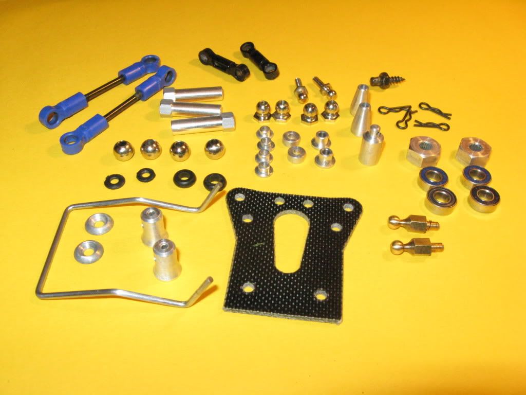

I have a cheap silvercrest one that came from Lidl I think. I find it amazing when used in conjunction with concentrated multi surface cleaner such as Flash/Mr Clean etc. I find it most impressive at getting gunked up grease off of stuff, you can see it melt away before your eyes.
It's also good for rust when used in conjunction with white vinegar.
I believe it's the combination of the cleaner AND flash that makes it so effective. It's great for gears and bearings etc but also general dirt and mud just seems to melt away before your eyes.

I just realised I left one of the "after" shots out too! I've amended the post now!
