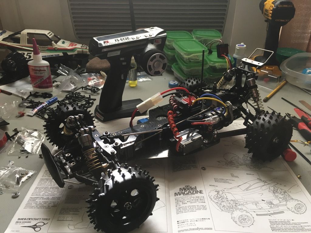

Everything is tested, and seems to be running smoothly, at least in the floor of the house. Only battery I have that fits is the Ni-Cd that came with my Jimmy, though. None of my lipos fit. Was kind of expecting that, though. Any body have some recommendations of ones that work before I start measuring?
I did say I was going to leave the car clear, but I do plan on driving it, so I was a little worried that it'll so scratches and such too bad. I'll do up a clear shell later. For now, body is being painted. It's metallic, but not silver.... You'll see when it's done!

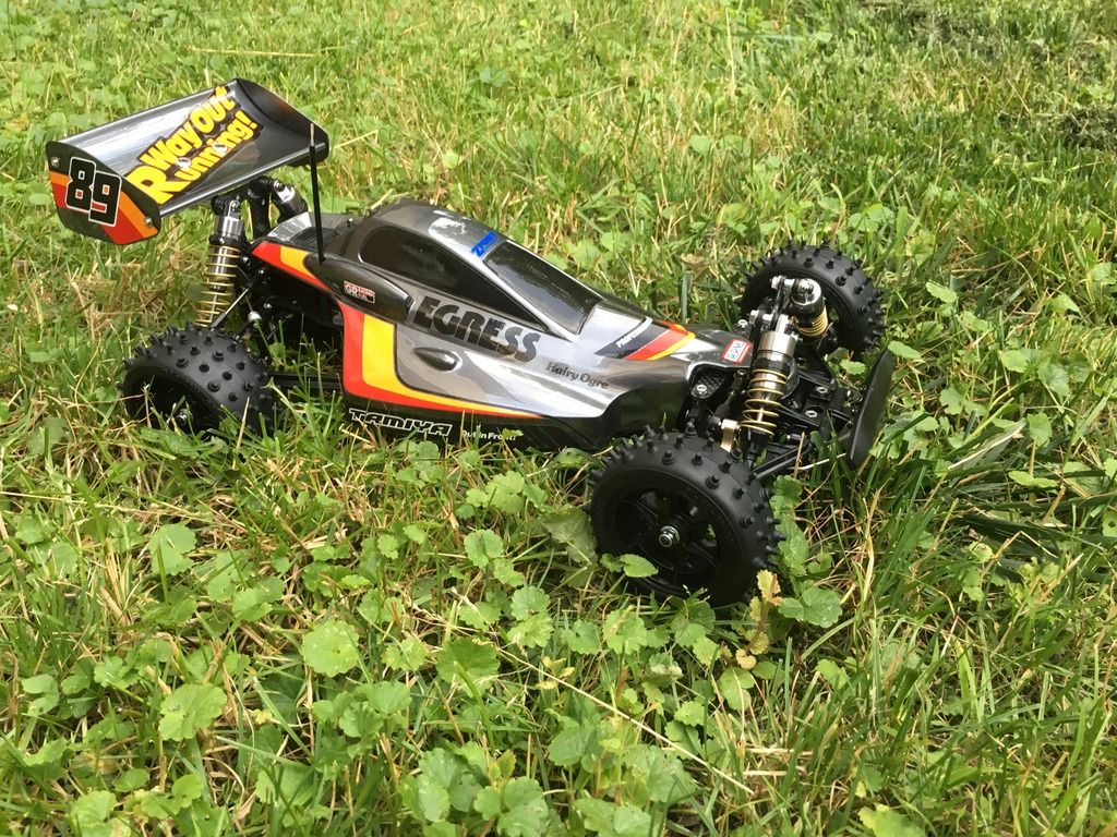

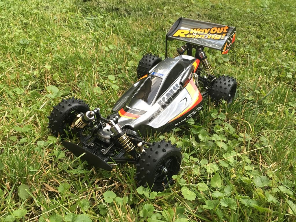

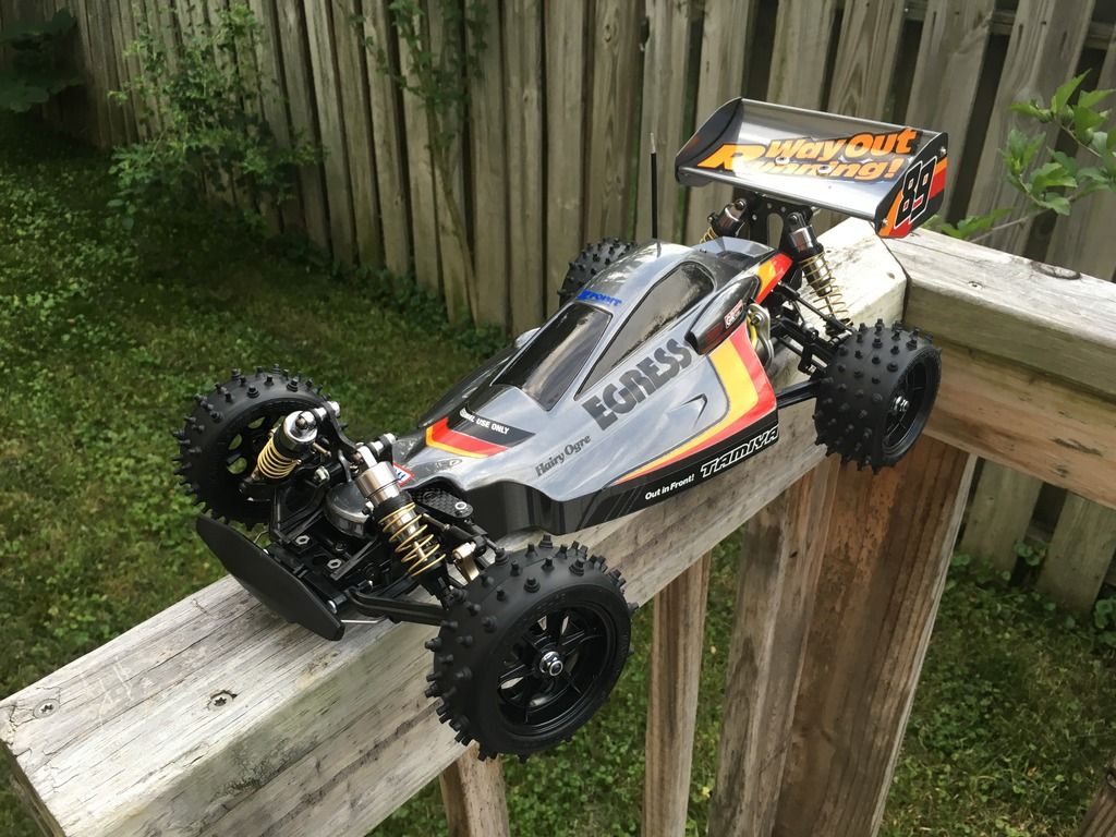

Ok, here she is!

I really like the Gun Metal. Just subtly different, but I think it looks a bit more sinister. Glad this will be my runner body, too, as I didn't get the decals as perfect as I would have liked. I'll do better next time.
Thanks to MatMan I have a ball center diff on the way, and I went ahead and picked up the bonus wheels the same seller had, too. Probably stick some dirt hawg tires on it for messing around in the yard and park, since I sometimes wind up on pavement. Can't wait to get a battery and start driving it, but it's been a really fun build. Probably like 10-12 hours, I think, from start to finish.

WOW !! came up great , nice colour choice .  Give it a run as is , Before you had the ball diff .
Then you can see/feel the difference :lol: . Looking good .
Nice work.
Yep great fun to build. I enjoyed this build more then the Avante for some reason. Maybe less complicated especially  in the front end.
Nice colour choice too.

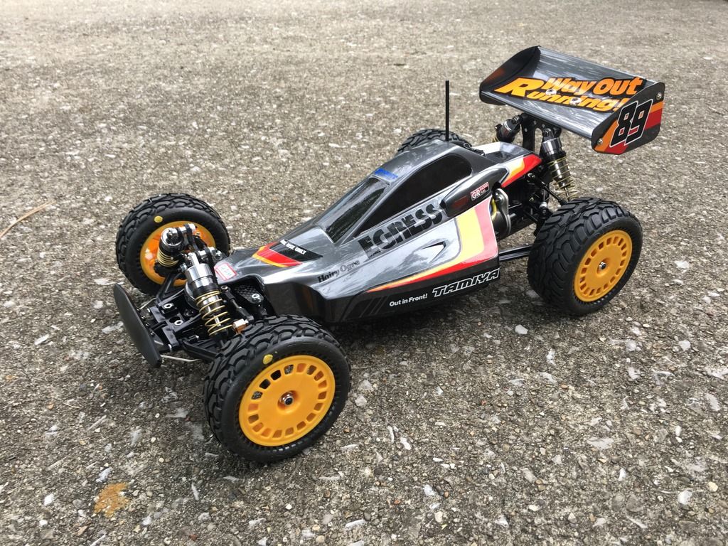

Got my Tower Hobbies order today! Reedy Wolf Pack can be added to list of batteries that fit...sorta. I did file one corner down, and it was still a very tight squeeze. But at any rate, it's in there, and I have a tendency to charge batteries in the cars anyway. I honestly rarely run them long enough to require a change. But also, got the Avante bonus wheels with the Dirt Hawgs mounted up.
7A61FDD5-4052-43F3-920E-40C52BBF0CE2_zps
I really like it! Handles pretty good (for my bashing around the yard) with one exception. I think I'll be putting in the ball diff soon. The two-wheel braking pretty well sucks, especially on pavement when I happen to be on it. Nothing like locking the back wheels to send one sliding sideways. I did manage to traction roll it a few times, something I was a little surprised at, but I think it has more to do with me and the high speed/high torque servo I used. Still getting used to her.
That colour is lovely, I did my Avante re-re in that colour too! So nice.
I think we can safely say that the Egress is Tamiya's finest moment...ever.

I saw yours in the showroom! I really like the color, I think it suits it very well. I do agree that this car is probably the most gorgeous car that Tamiya ever put out. Body on or off.
It's a bit old/late but your front and rear wheels are mounted on the wrong side, the tyres are rotating the in the wrong direction. Just swap both sets left and right and you'll be sweet. :)
You know, I wasn't 100% sure on that. There's no arrows, and I couldn't figure out the directionality. Thanks!
All good. Think of the tread as an arrow that should point in the direction of rotation. On your tyres you can see the outside tread all points in one direction (backwards on your car at the moment). This only applies to tyres with directional tread of course. :)
