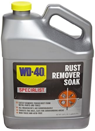

Simply dismantle each and every part of it and use some rust remover product. The polishing wheel you said you have will sure come handy afterwards.
Here's something you could use:
After removing the rust from parts, then do a little polish and then rebuild it, and use lil grease on moving parts. Add some bearings in place and as last step dismantle the gearbox. Believe me, it is NOT a hard task!
