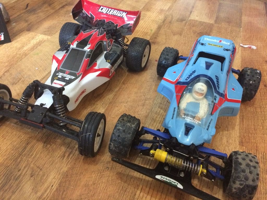

thunderstriker 3 Posted July 28, 2016 Here it is, next to my daughter's well-bashed Helion. Just added an eBay A5 brace (original part broken on one side, but I haven't replaced the plastic part as the brace seems plenty strong. Ball bearing set and a decision on the motor choice and I'll start the resto. As it's still huge fun to drive thinking I'll maybe treat it to a brushless. I use a Speed Passion 8.5t in my Kyosho and they do a 13.5t kit too, which is about the same price as the HobbyWing and readily available. 1 Share this post Link to post Share on other sites
