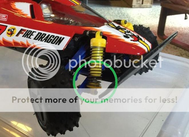

I think Max was talking about your Fire Dragon. The front shock bodies look too long and it looks like suspension travel would be very limited.

:lol: I was just editing the pic, Yes well spotted Max :)
Argh, I thought you were talking about the Thundershot. Hmmm, don't know if I've got any mini's. I'll have to sorce some or can you modify these?

Thought you might have been :) You wont be able to mod these as the shock bodies are the problem (to long:wacko:) your gonna have to source some .
The Yellow mini shock's were used across a few models which should help to find some :) cars are, Road wizard, Sonic Fighter, Vanquish, Astute, F101 & group C cars. 50332 cva mini shock :) there are a few sets on Ebay now =  131785462834
