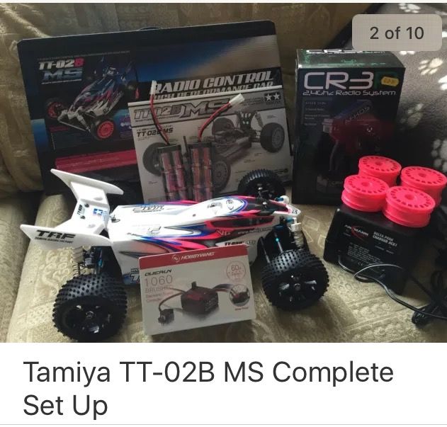

so I decided I was going to buy a neo scorcher - comes in at about £100 with motor and ESC
but noticed they did a TT02b MS upgrade kit with alu shafts, prop joints, rear uprights, FRP suspension mounts and full bearing kit for £120 BUT no motor, ESC or even tyres.
Looked at buying some add ons for the Neo and was getting expensive. Plus I needed servo and another battery maybe.
Had a watch for tamiya terra scorcher on eBay and there was a guy selling off ALL his unused shelf tamiya - LOADS all built but not run!
He had TT02b MS with motor, ESC, radio gear, 2 X batteries charger spare wheels and tyres all for £180
so I went for it......
Am I mad?

and what I'm sat eagerly awaiting haha...
