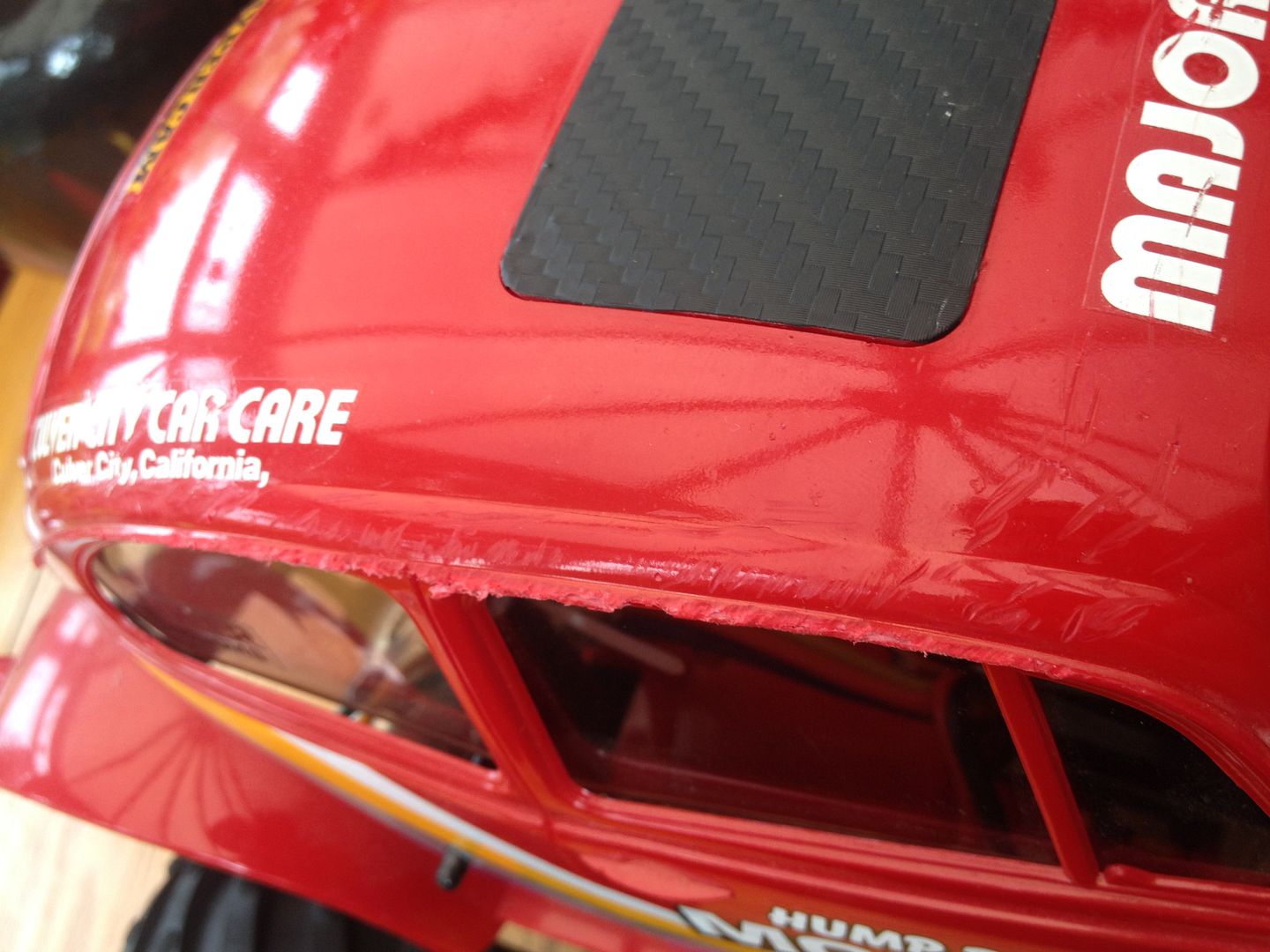

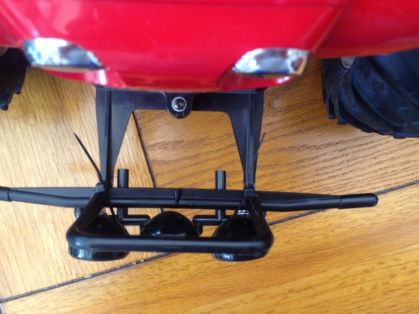

thought i'd post up my RR Beetle damage in the month i've been running it.....
All street driving so understandable I guess
front spot mounting point broken so tie wrapped to the bumper
(seems a bit silly having the mounting point as part of the shell)
Bonnet damage from a spikey bush (or possible roll)
Roof damage from flips
Both wing mirrors gone walkabouts

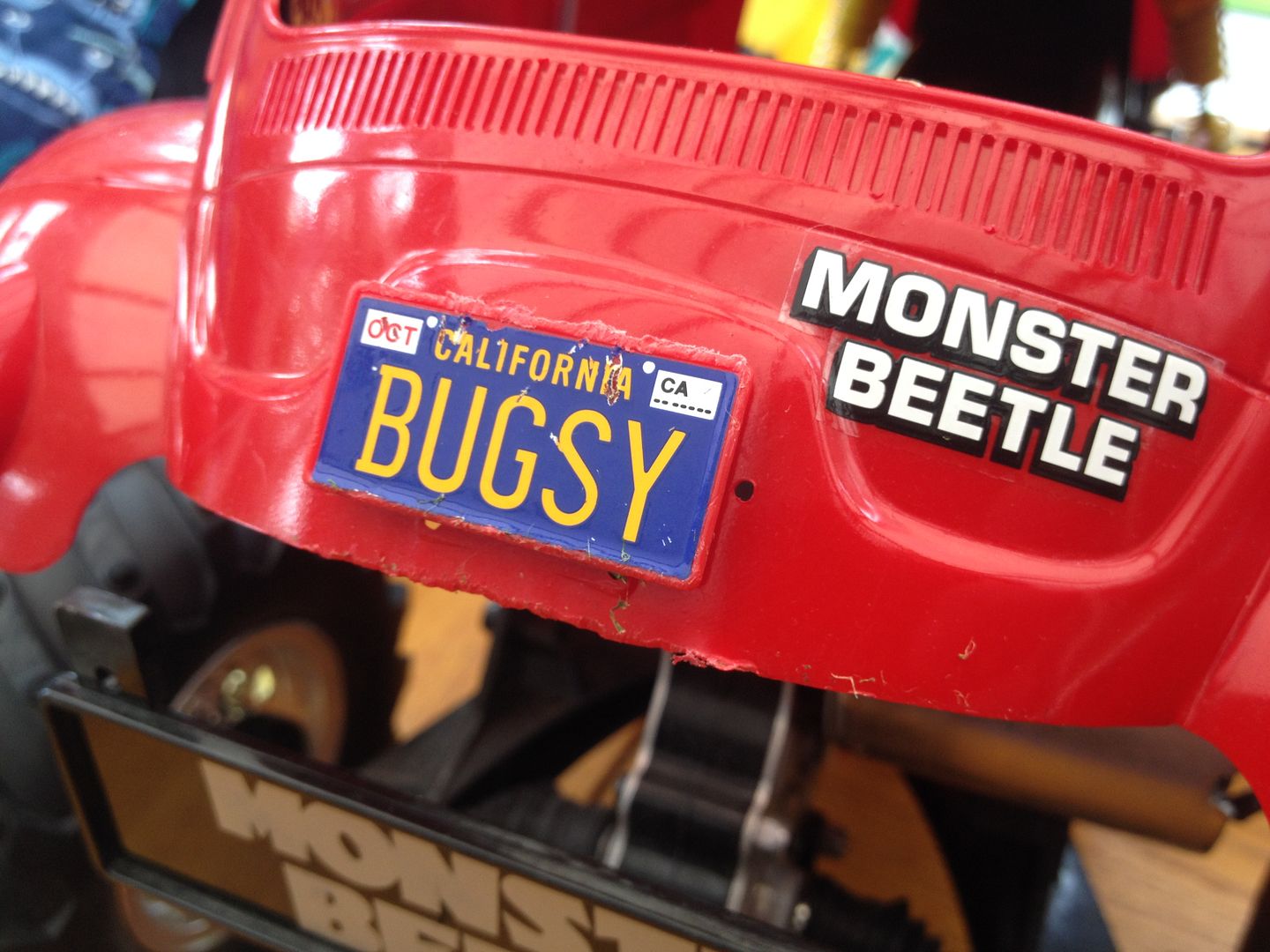

Rear boot handle destroyed and covered up with numberplate (now damaged too)
Also did a little bit of lightweighting of the heavy glass sunroof (haha)

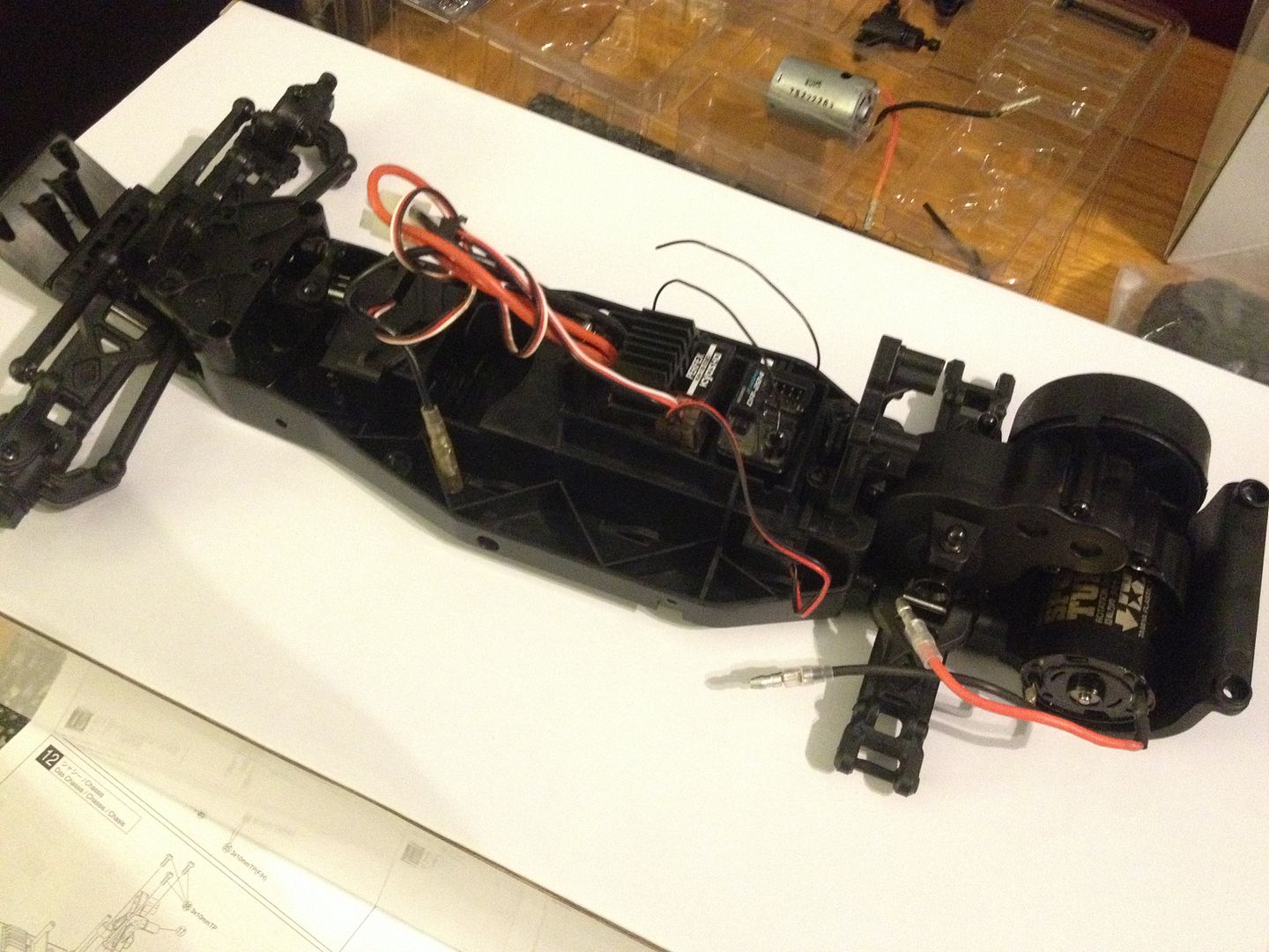

so after sorting fitting the brushless 8.5T and the TT02B going backwards fast and forwards slow (flipping the diffs but i'm sure there MUST be a way using the ESC and transmitter) i've spent 20mins running it and the tamiya ESC held up well (c50degC according to the laser thermometer)  with the motor running at only about 35degC and the tamiya battery connector just being a little warm.
so all good (for now)
Yeah racing bearing steering fitted too
i tried the 12mm metal hex but they just dont grip the drivershaft and they come off too so sticking with plastic for now
JJ

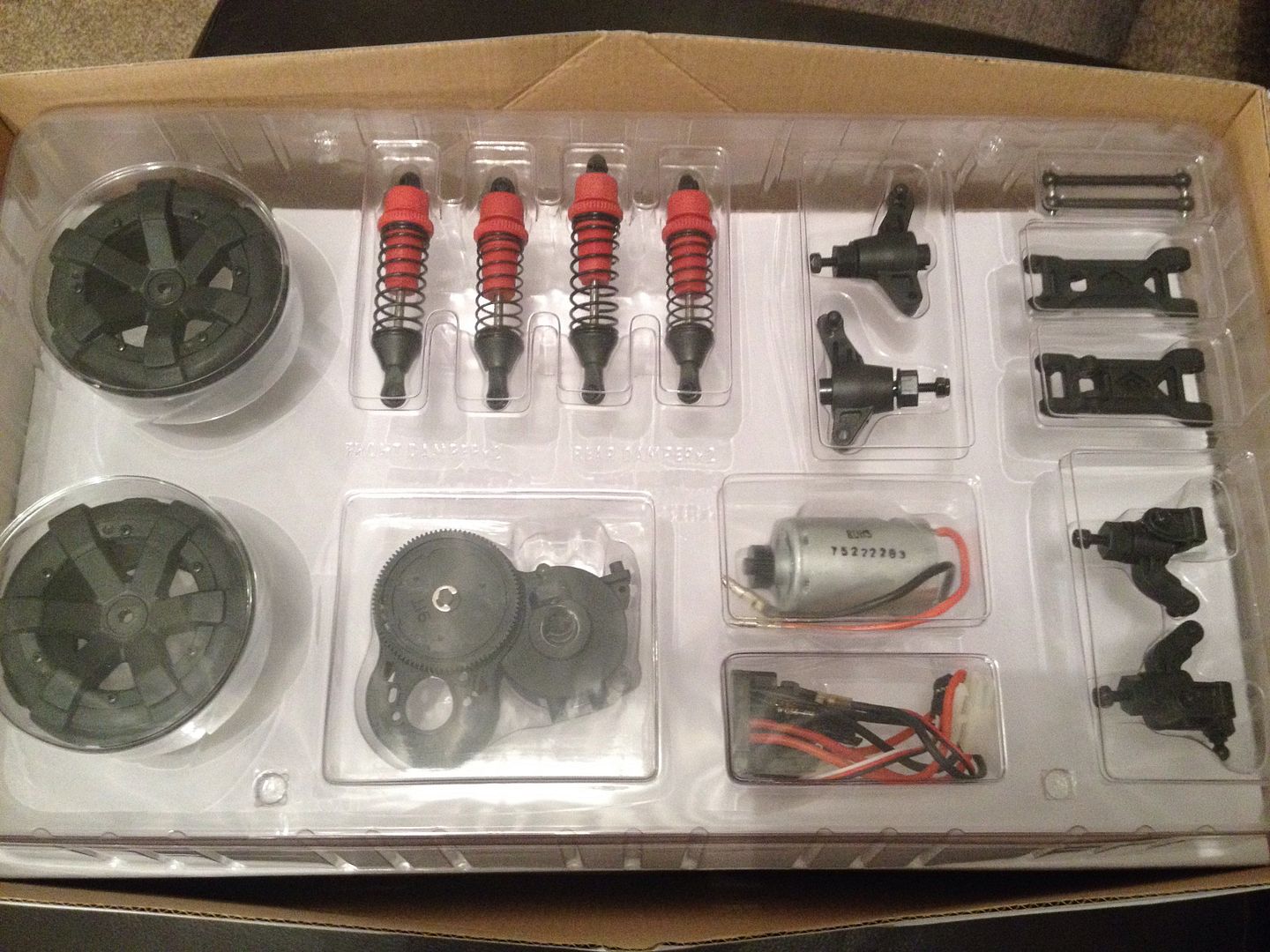

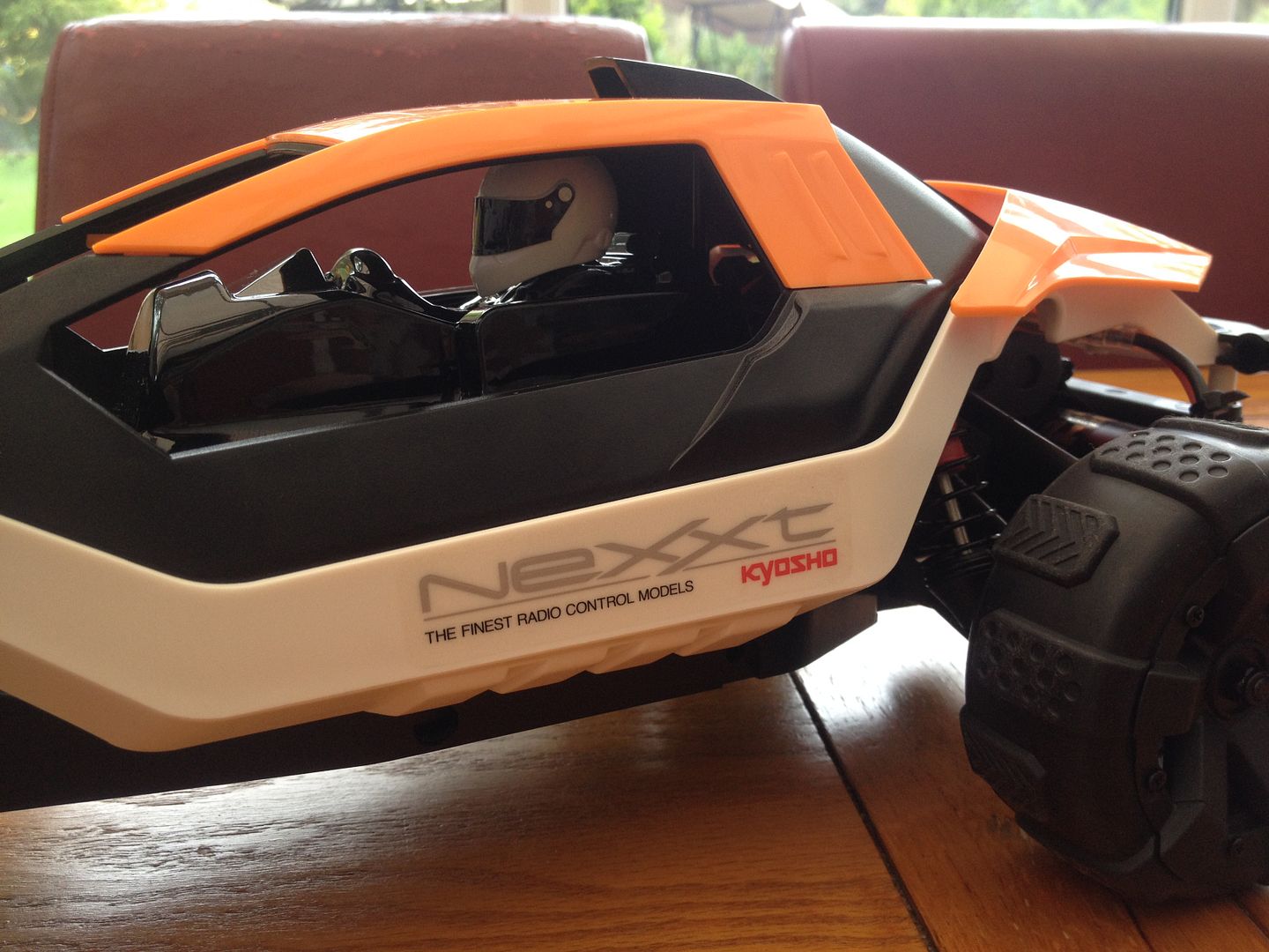

so got the nexxt and it was a fab build for me and my 6yr old
he did 90% of it
it was different to a atamiya build in a number of ways and the instructions are the megablocks of the lego world (ok but not as good as lego)
given it comes with an ESC and motor and screwdriver all for £55 then its great
some components pre assembled (gear box and shocks) but the rest is good and the body is superb
initial thoughts.....
tyres are hard so wheel spin a lot (but can wheelie now i have the sports tuned 540 in)
steering is light so understeers (combined with crap tyres)
its heavy but seems a tough unit ( the shell screws to the chassis so its v rigid)
the ESC has no slow reverse and if you change the end points on the redio gear to say 40% then you lose the breaking
BUT - the main thing is he LOVES it ;)
fab entry into model RC kits

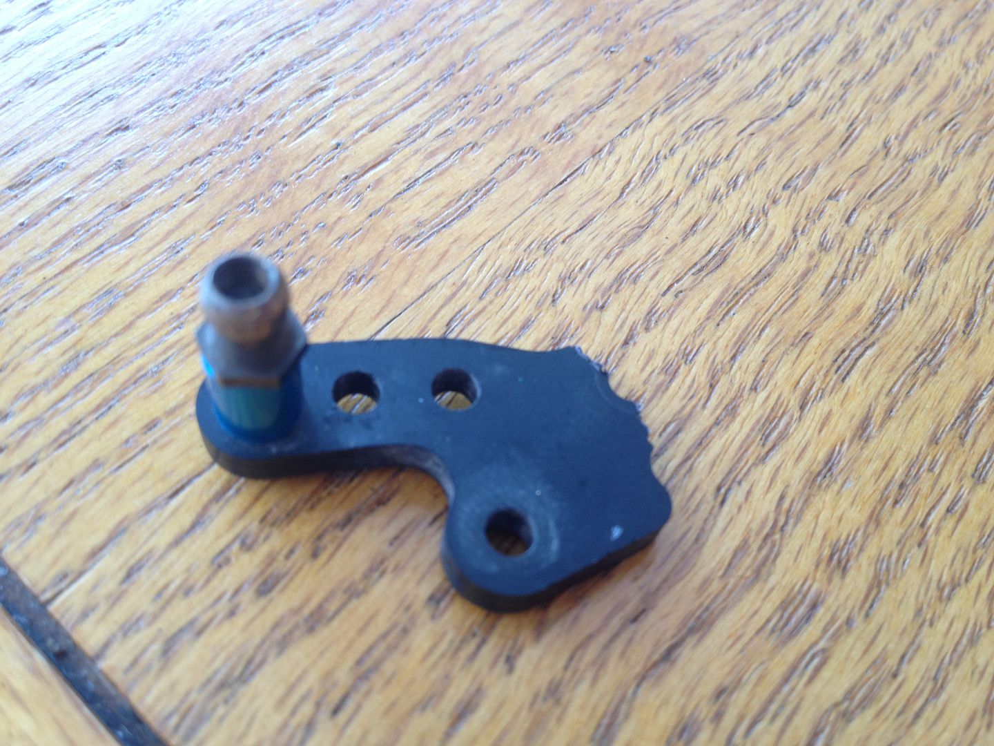

Aw - broke the FRP front suspension mount today just on normal road use (think I hit a pot hole haha)
this is supposed to be the stronger one :(
another order into yeah racing - should have them on speed dial

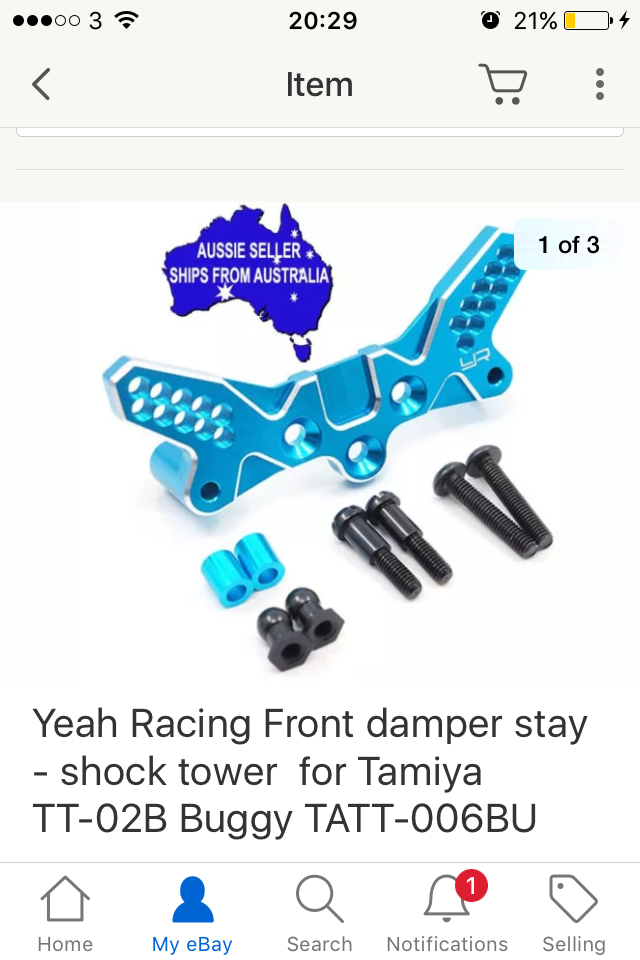

got my yeah racing front mount from oz - has really stabilised the front end (i'm thinking i may have had a fault with it maybe
there was a slight issue as the kit isn't set up for the MS and its adjustable top supports so needed to steal some ball mounts off the neo scorcher donor haha
