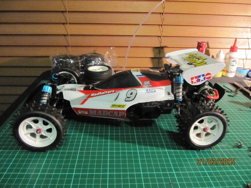

I love the Madcap. I own three. One you can see in The Build thread. This will be a runner.
The others are two chassis I cleaned up. Both from Ebay. They are used but in overall good state. I'll put them up for sale.
As far as driving I've no experiance. I think the Madcap is the best looking 2wd buggy.
