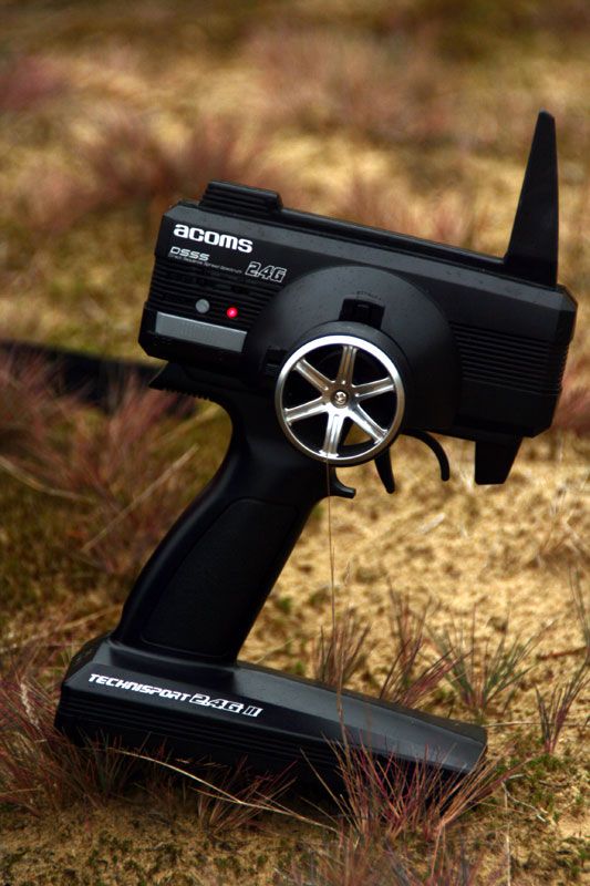

From all the transmitters I had in possession so far, no one beats my old Acoms Technisport 2.4 G II, though, both in look and feel. :)
