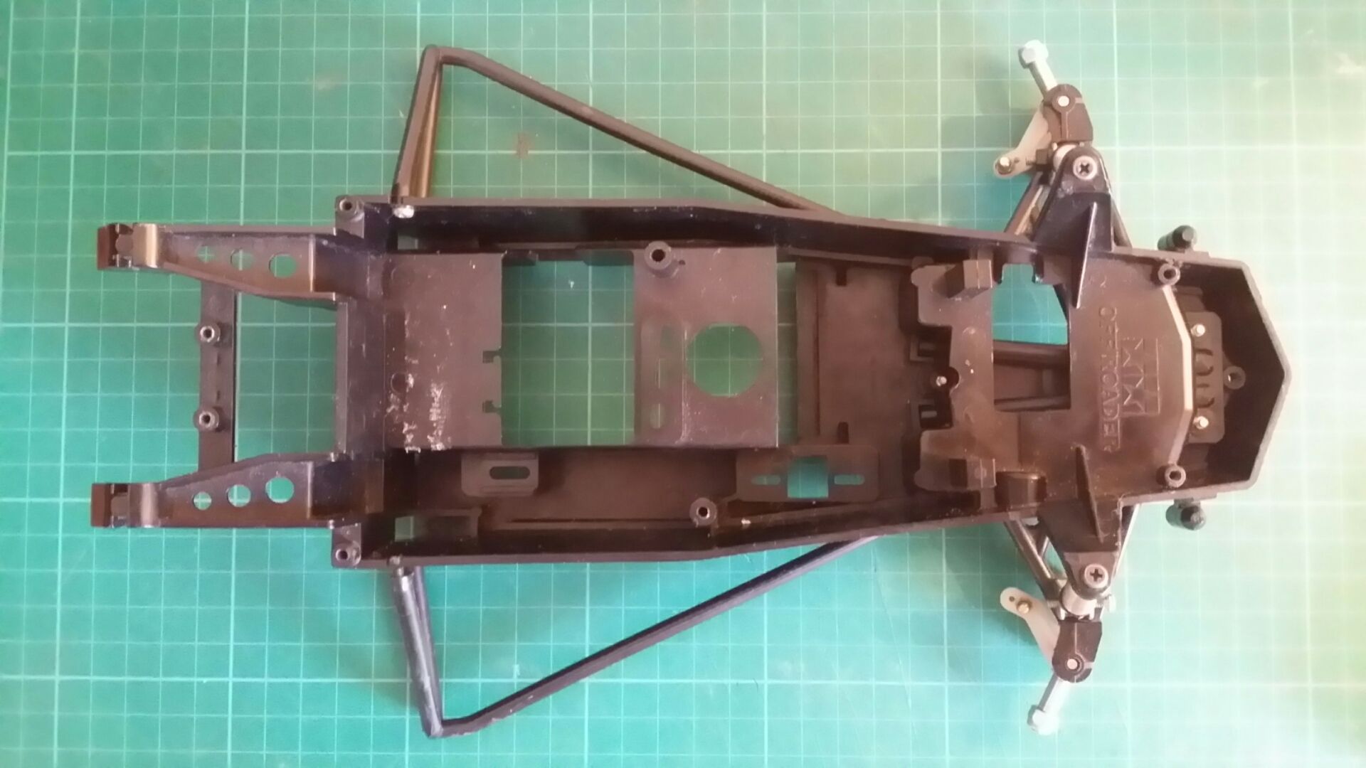

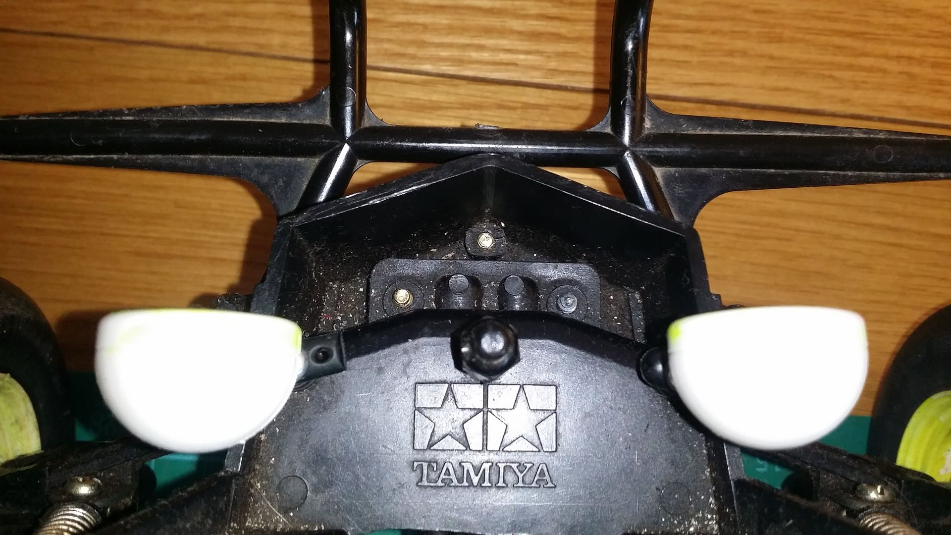

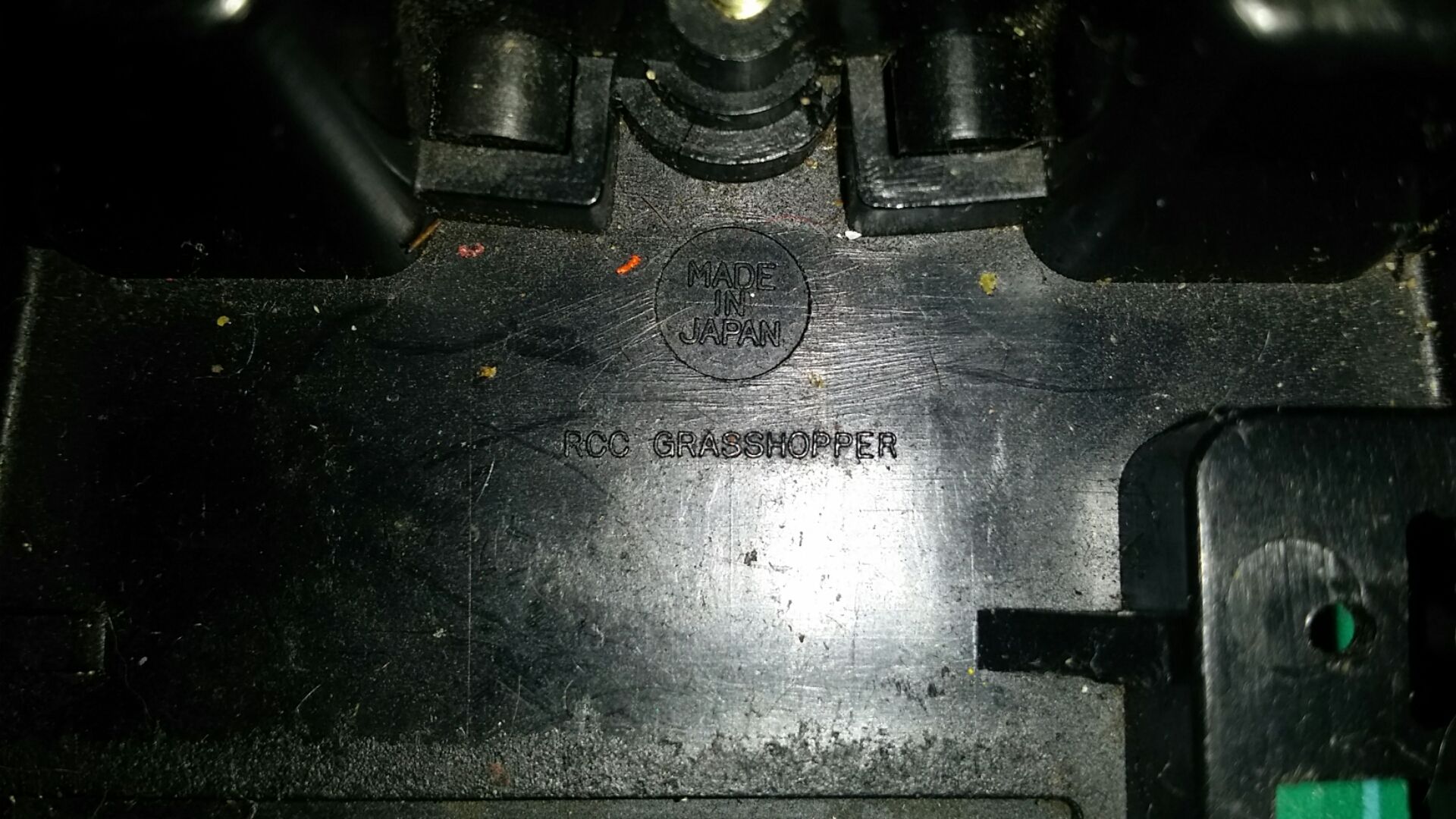

So I've took some (bad) pics with my phone and I forgot I actually bought a grasshopper/hornet bundle on ebay. Lots of good parts including a spare chassis. So I have 3 in total.
So after looking at them all I noticed the following :
  1. The re-re -
  •  Says TAMIYA at the front of the chasis with the 2 star logo
  • Circular stamp in the chassis tub with a serial number. Underneath this is wrote RCC GRASSHOPPER
  • Small square hole for humpbacked battery and no tab for elastic bands
I didn't take any pics because It's identical to the pic mongoose showed as is most definitely a re-re
       2. The 2nd hornet I got given when buying the re-re -
  • Says TAMIYA at the front of the chassis with the 2 star logo
  • Circular stamp in the chassis tub saying MADE IN JAPAN. Underneath this it says RCC GRASSHOPPER. (Didn't take take a pic, servo in the way)
  • Large square hole for hump backed battery and tab for elastic bands (pic taken from underneath beacuse of esc blocking the top view)
       3. Chassis received in job lot of hornet/grasshopper parts -
  • Says OFF ROADER at the front of the chassis with the 2 star logo
  • Circular stamp in the chassis tub says MADE IN JAPAN. Underneath this it says RCC GRASSHOPPER.
  • Large square hole for hump backed battery and tab for elastic bands. This final chassis also has no front body post for a hornet body and the gearbox attached to it had the smaller 380 motor.
So from this would the first chassis be a re-re hornet? The second chassis a vintage hornet? If so what mk? And the third chassis a vintage grasshopper, again which mk?
Thanks for any help and sorry for putting this in your post mongoose. Hope it turns out helpful to everyone.
1. Re-re chassis
2. Original Grasshopper chassis Mk2
3. Original Grasshopper chassis Mk1
