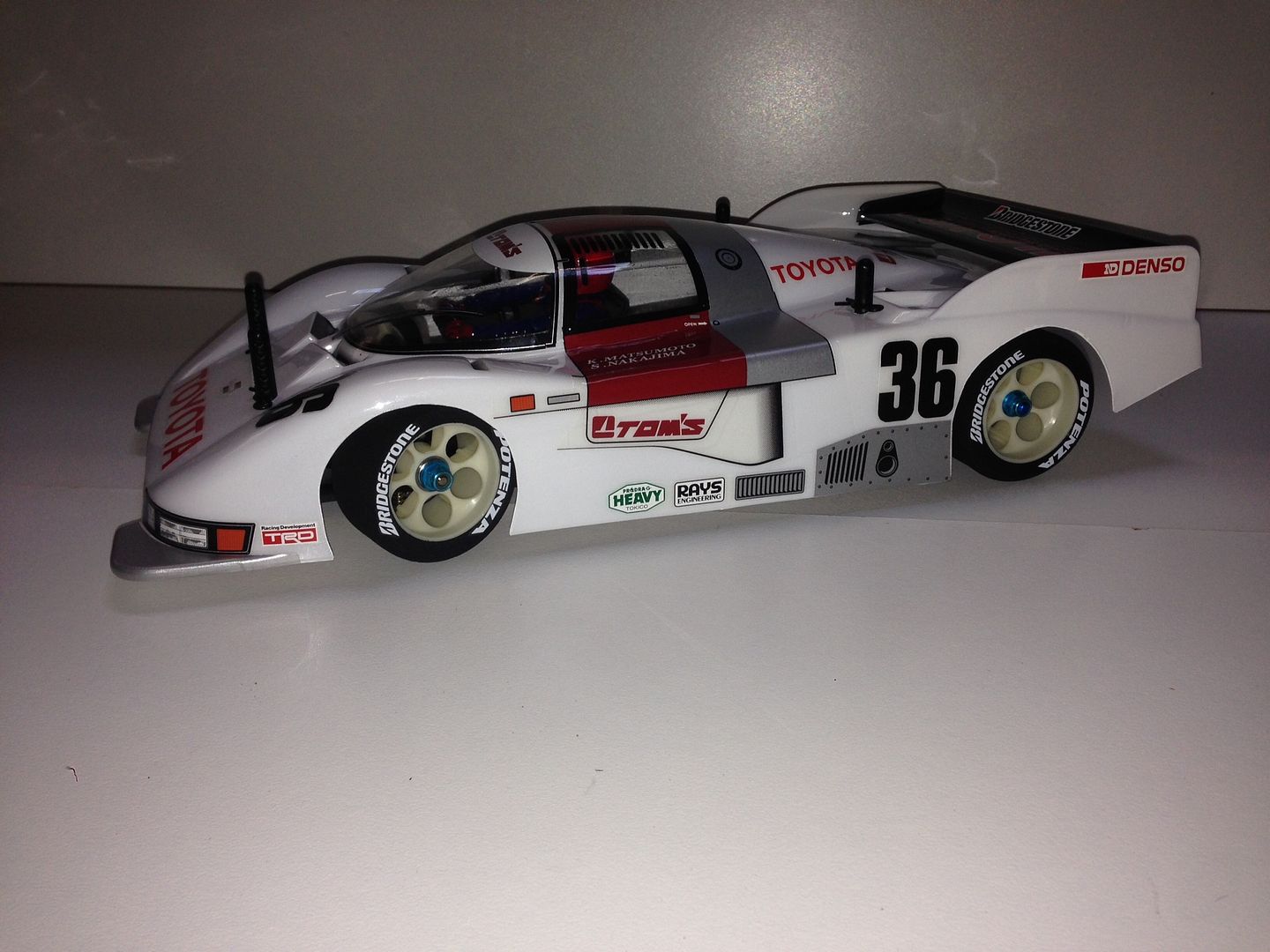

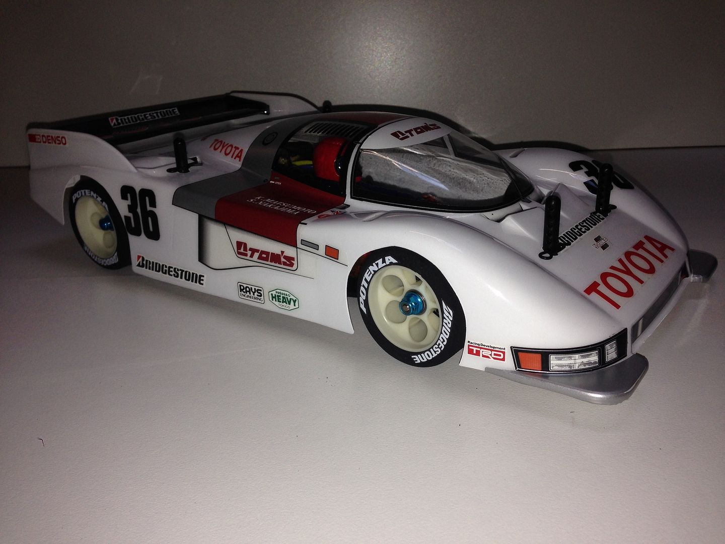

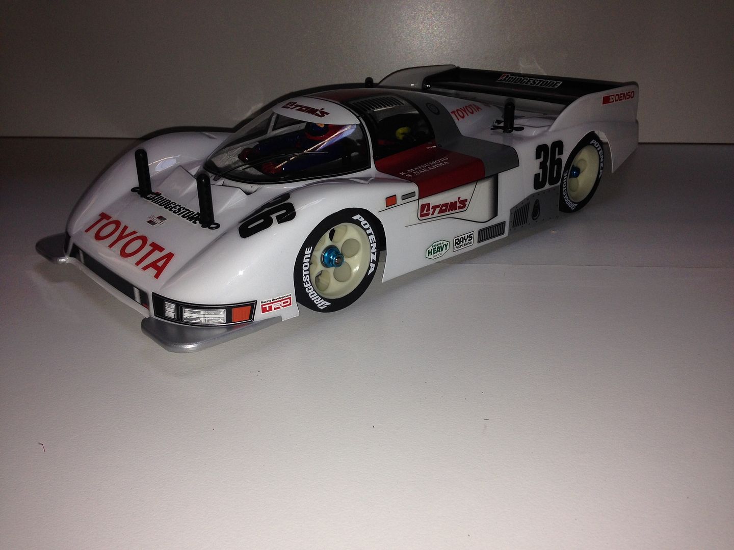

So the MB is off the work bench, and the CR01 back on, thought I better show it finished too, took me about 5 mins to fit the extension wire for the light bar :blink:

So into the morning sunshine for a couple “Glamour Pics”
39912409883_247a1df3d5_k.jpg5625D2E3-84DE-4F45-B779-B59A5DBEC8AA by Kym mtbkym01, on Flickr
46152424084_06d5045bac_k.jpg39F236DB-FD4B-42C9-94BF-05AAADB514DA by Kym mtbkym01, on Flickr
39912408853_dba39653b6_k.jpg41512E56-8024-45BF-B584-424A0E49F864 by Kym mtbkym01, on Flickr
