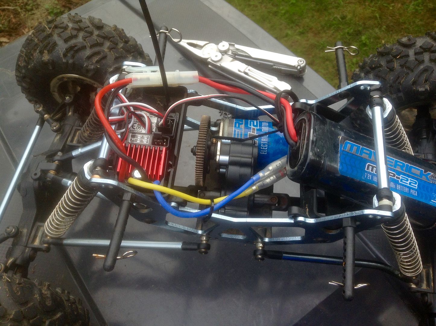

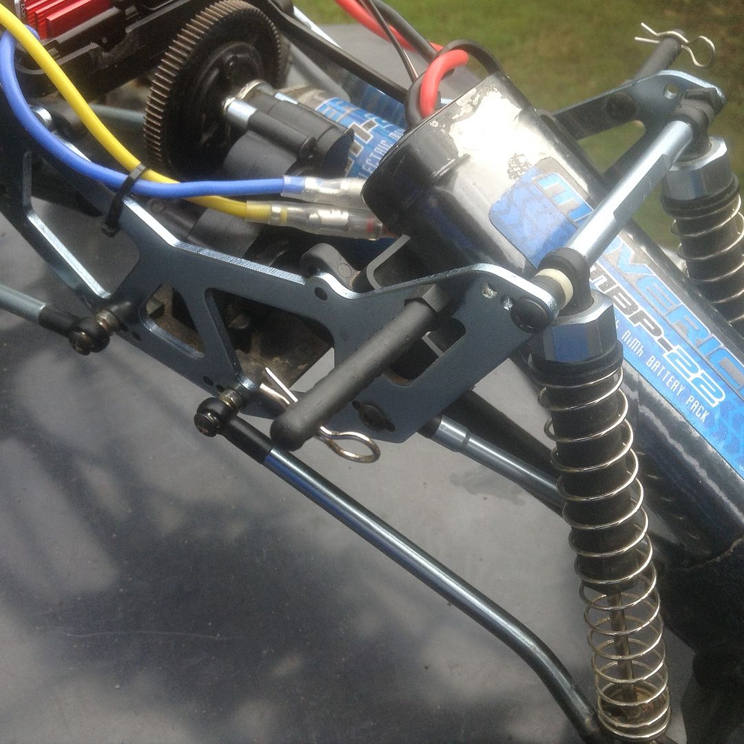

The first step was lowering the COG. In my case I removed the battery/electronics tray,and attacked it with a Dremel.

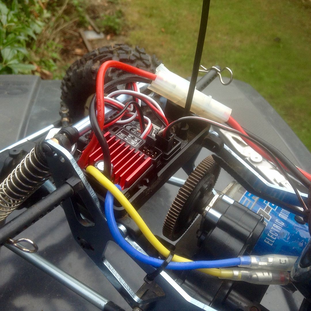

Basically,I chopped the tray into three segments. I kept the end segment,with the aerial guide to use as the electronics tray. The mounting pins fitted into holes lower in the chassis plates,with the tension on the cross member keeping it held on an even keel
I never reinstalled the Maverick ESC,and kept the Hobbywing 1060. The new receiver is a Flysky compatible with my FS-GT2E tx

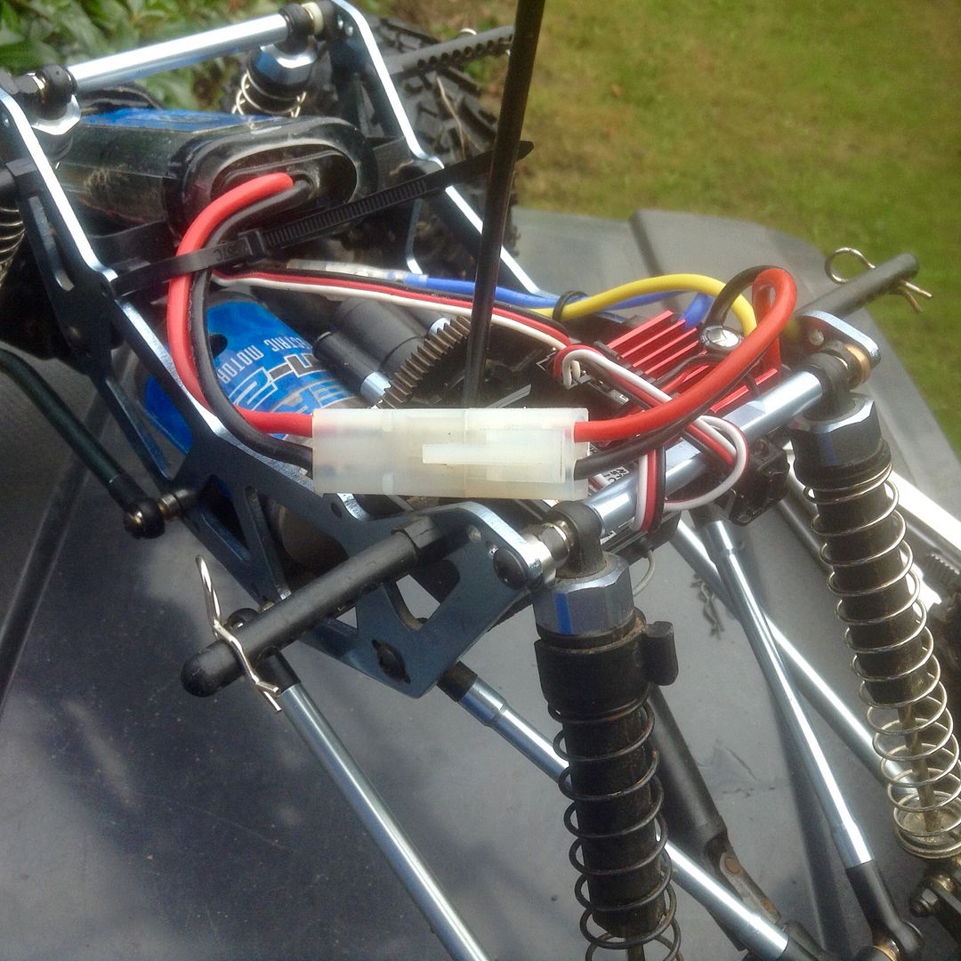

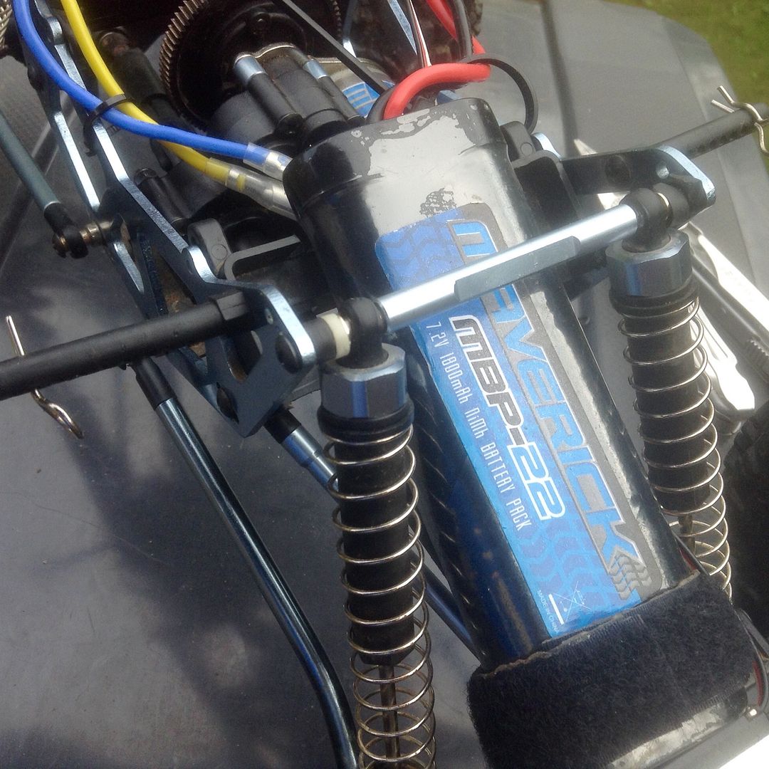

The other end was used as a guide for the battery
I cut out a retangular section to control the lateral slice of the battery. The tray is mounted in the reciprocal holes in the front of the chassis,both is allowed to pivot. The back of the battery rests on the suspension beams,using the servo as a stopper. Initially,I'd had a cable tie to hold the battery in place,but it wasn't suitable. As the photos show,I'm using Velcro at the moment. Testing has shown this isn't fully suitable either.
To be honest,the battery mounting has been the bit I've got most wrong. I hadn't thought out how much the battery could slide backwards on a steep climb...in fact so much so,it slid clean out of the Velcro. The cable tie seen around the battery wires had to be put in to control the slide. It's been adjusted twice already...

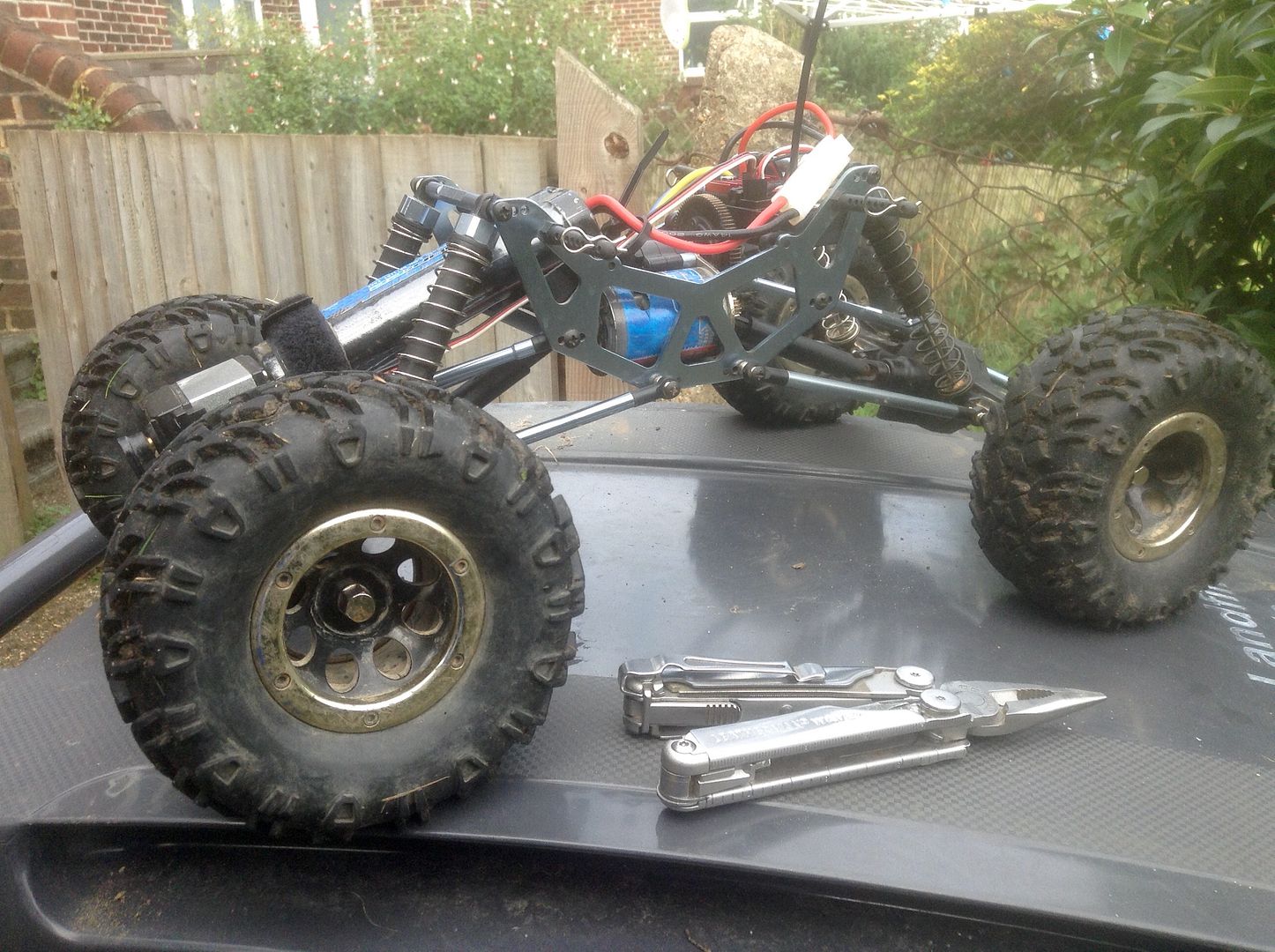

Additionally,I've had the wheels apart to dry out the sponges,and to add weight to the wheels. I've been using self adhesive lead strip used for adding weight to golf clubs. Basically,I didn't have enough,having weighted the Landfreeder and the FTX. I've more on order as we speak.
...which I've now corrected. The big eight mil bolt heads might be a giveaway

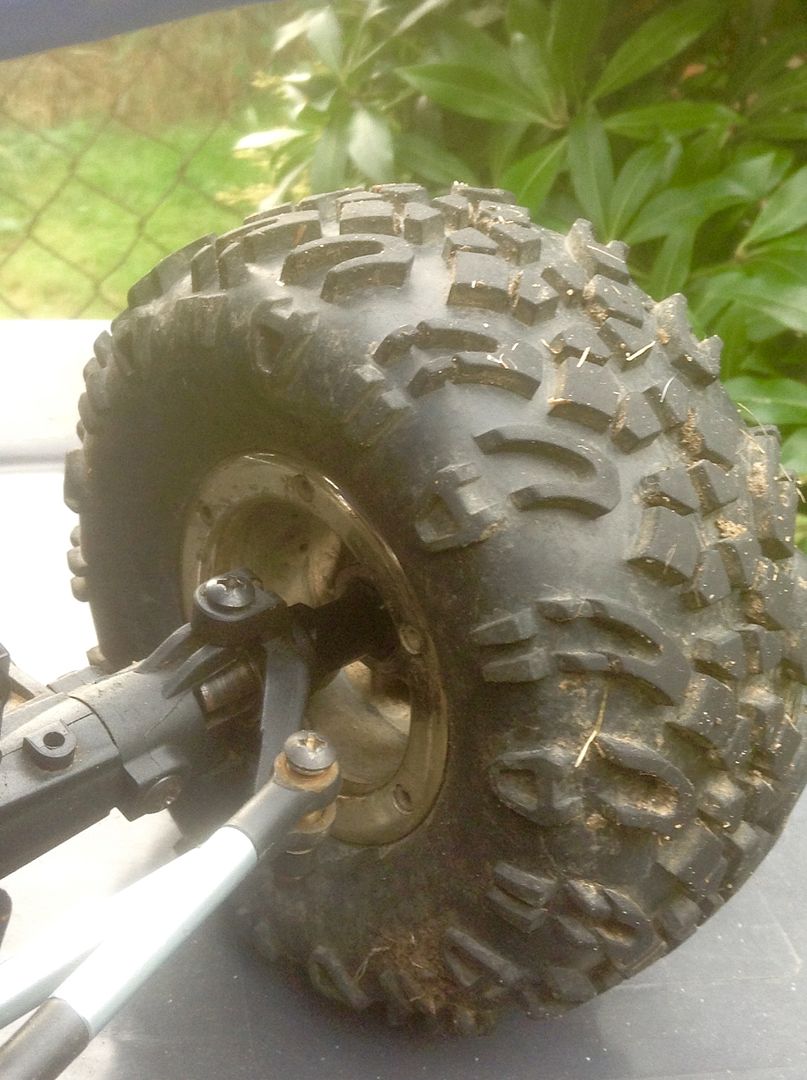

Yes,axle extenders. I'd bought these off eBay for another project,but set them onto the Scout,hoping that widening the track might help some of the issues

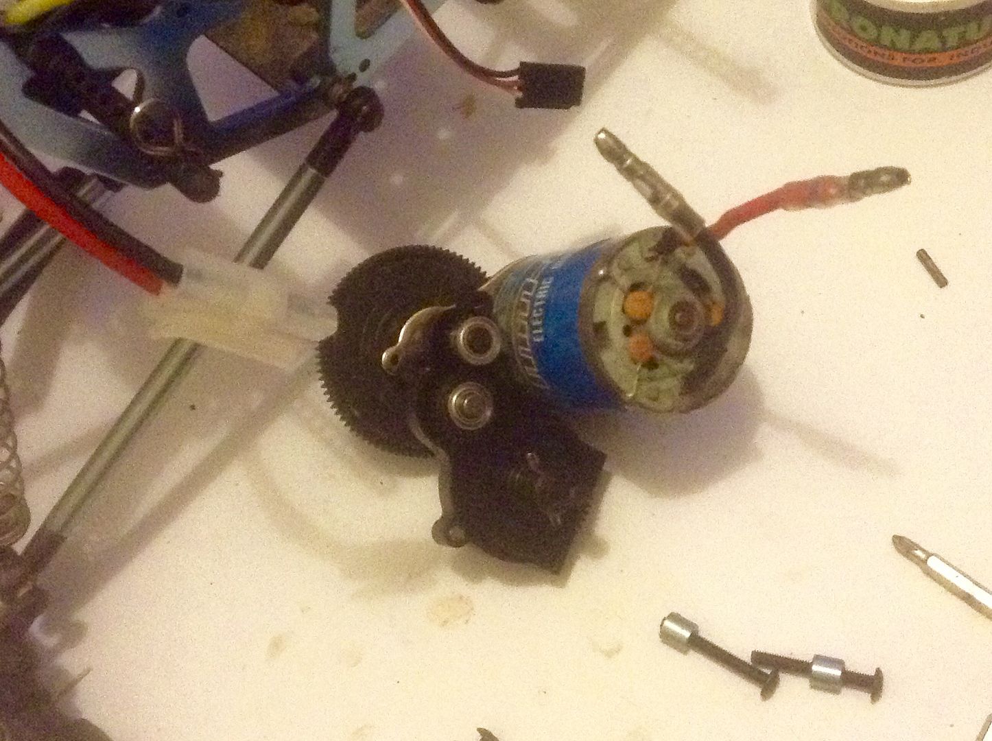

Given that my Scout was bought second,and that the original owner didn't just drive to church on Sunday,the big thing was cleaning and greasing.

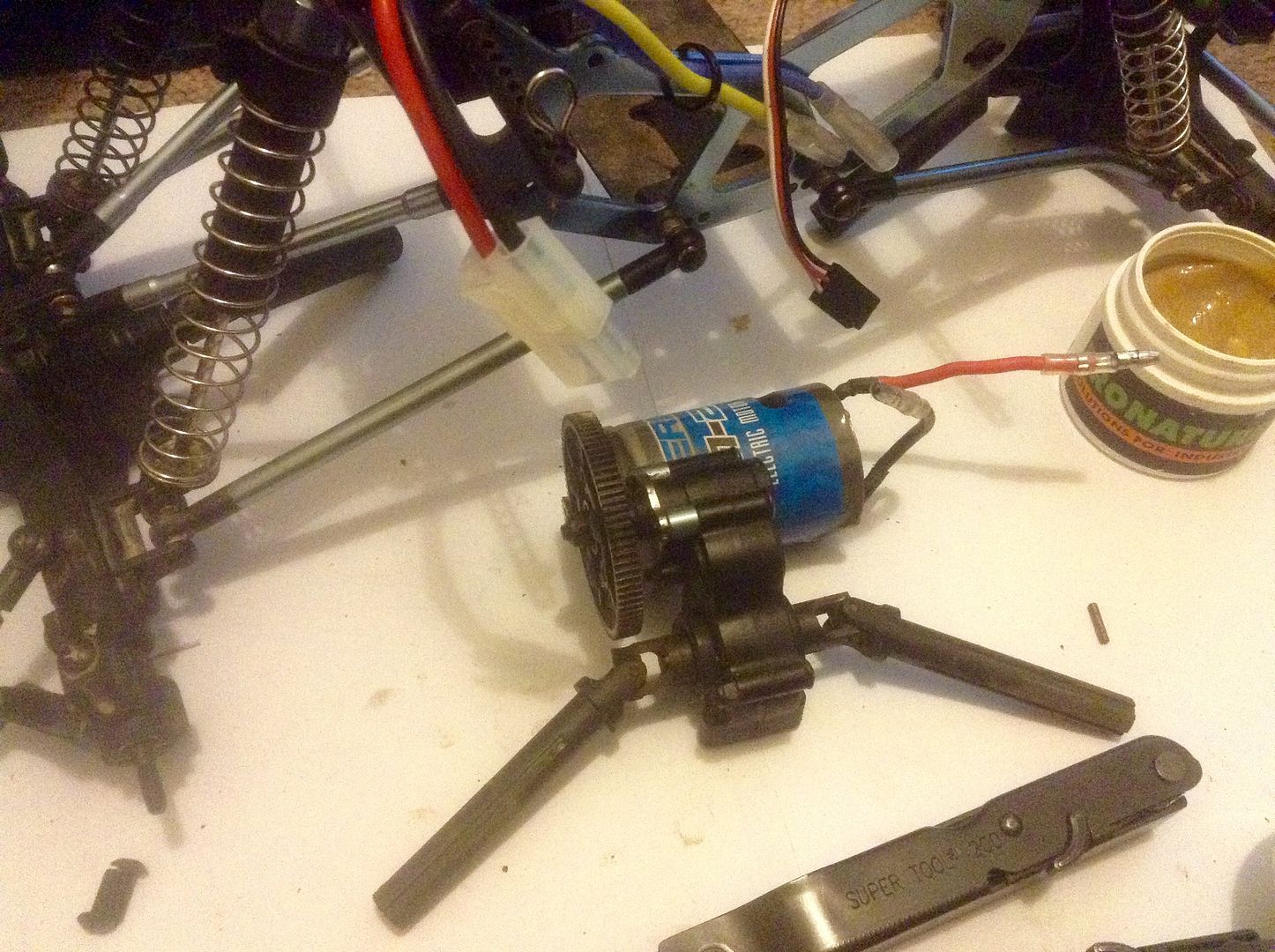

Its a well known fact that the Scout diffs and tranny arn't lubed,so that was done. Bearings were cleaned and greased too
Axle striped down

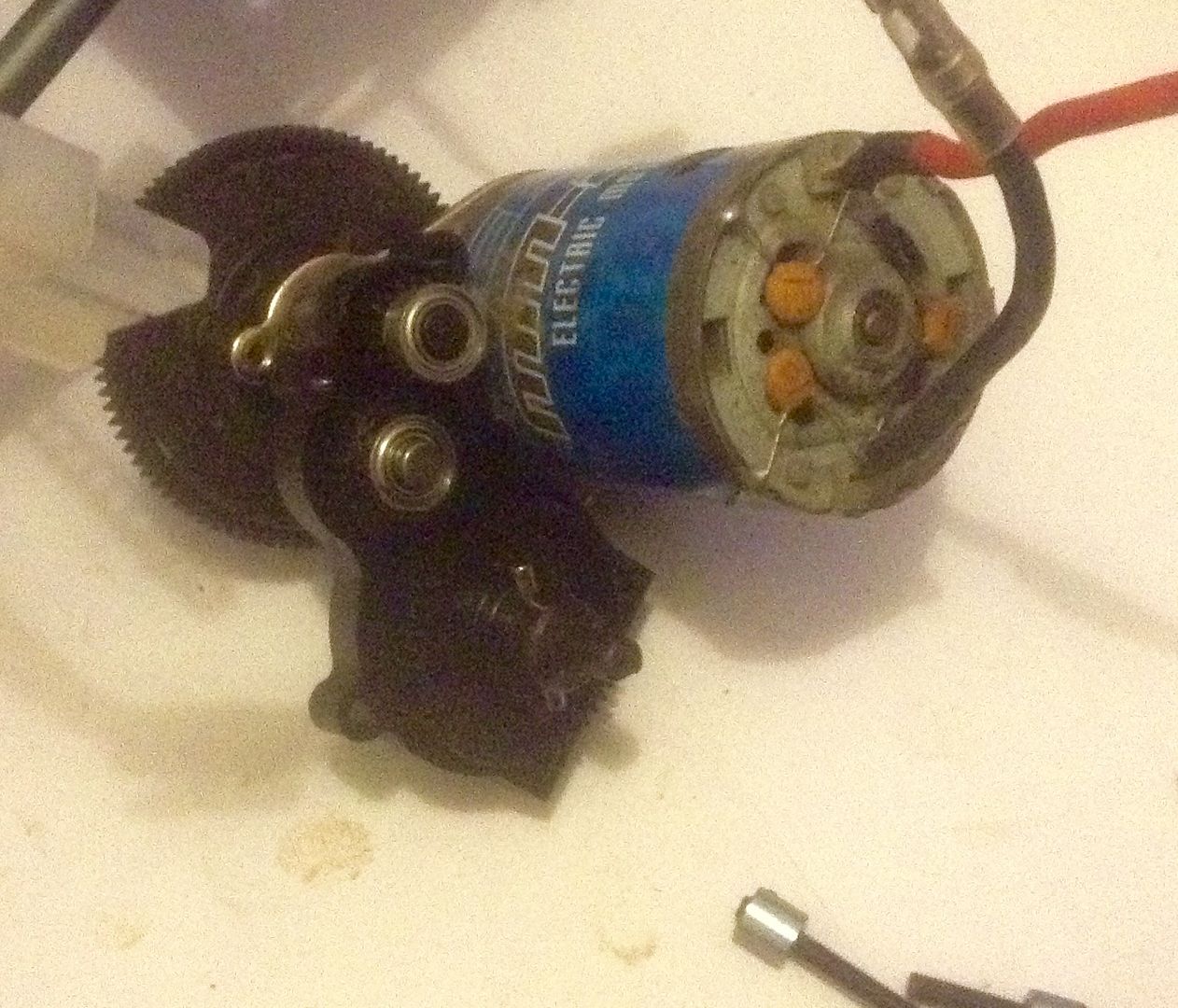

Motor and gearbox removed
And striped
Once it was reassembled,I'm not sure it was that much quieter,but it moved a lot more freely! I started wondering how much of the tractor noise was coming from the motor can itself. I resorted to an old slot car trick(also good for model railways too😉) and sprayed Servisol super 19 switch cleaner into the gubbings.

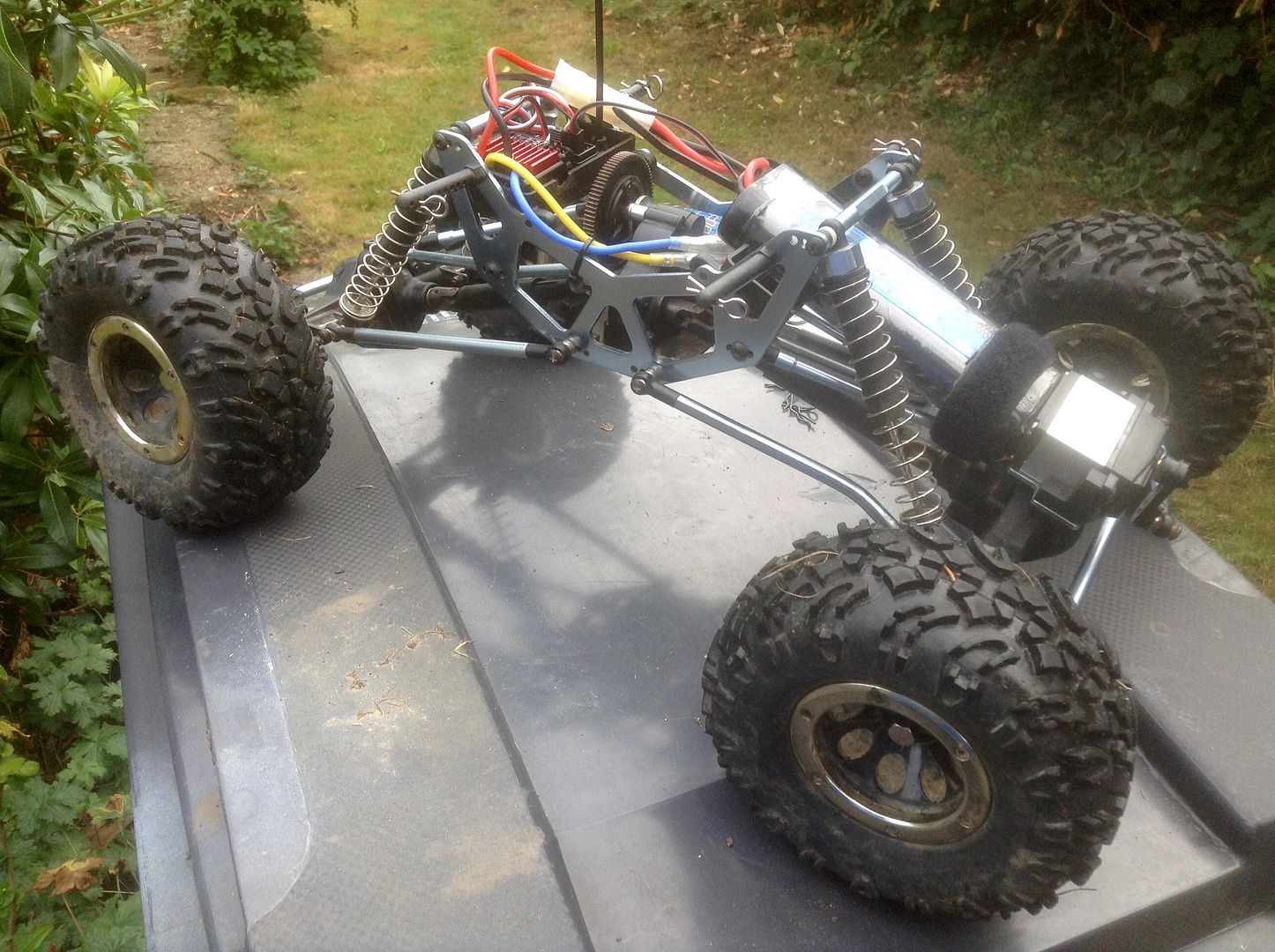

Sunday's test drive was a major improvement,but a lack of articulation  really hampered the run,leading to car falling into the river. It wasn't articulation that caused me to fall in myself a bit later,that was just stupidity🙄
The dip in the river didn't slow the Scout down(thankfully),but it's was looking like back to the drawing board,and possibly stripping the shocks.
Just before bed,I was sitting looking at the Scout scratching my head when I saw it,and promptly kicked myself very hard!
It's a well documented Scout trick,to fit a wide spacer to the left back shock(the black one😉) to counter the torque roll. Well,my scout had spacers on all four shocks,robbing them of about six mil of movement,and adding horrible amounts of preload. I popped them off,and woohoo!

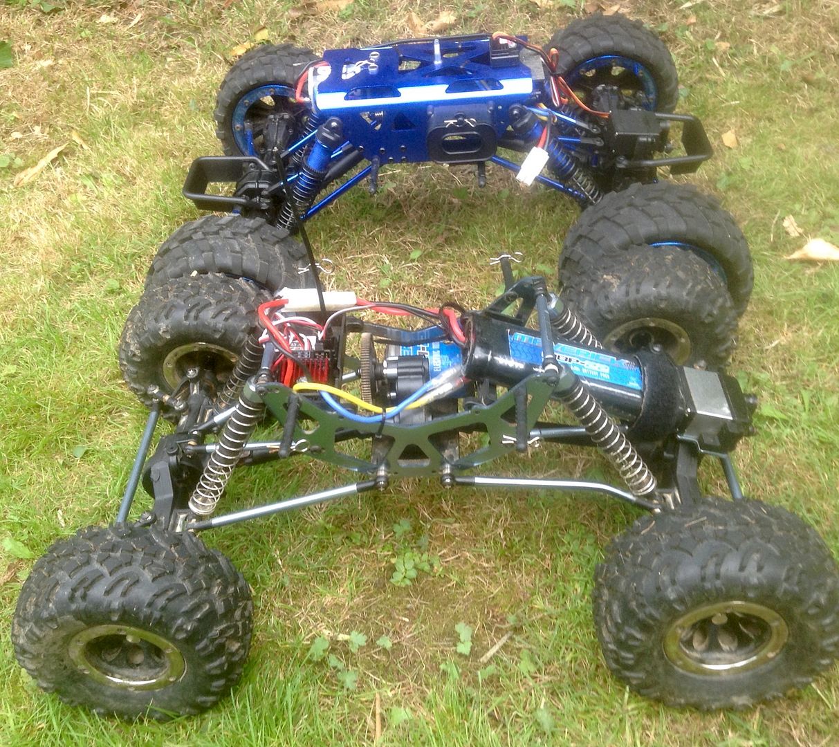

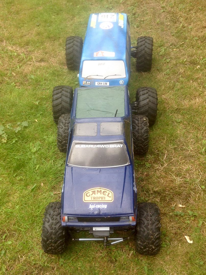

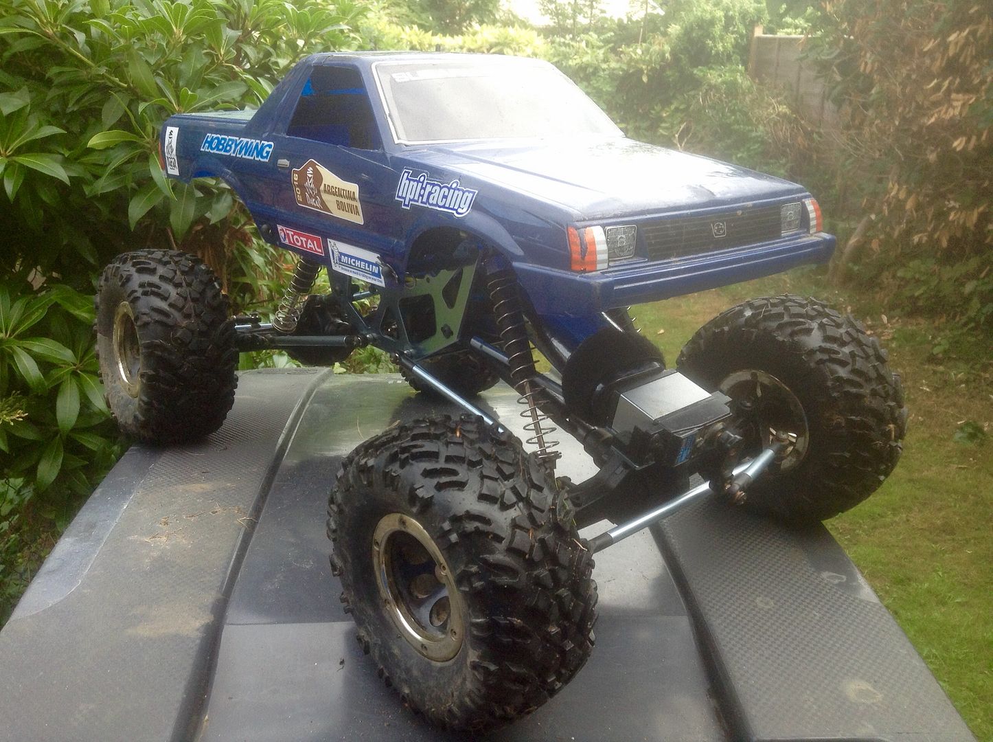

To round off the opening leg of this thread,here's a few pics comparing the Scout to the Spyder. I hadn't realised just how much wider the Spyder is!
Could you use a strip of velcro tape on the battery itself, then flip over the velcro strap so that it not only ties down the battery, but also prevents any longitudinal movement?
Hmmmm🤔
I like that...let me have a think😉
