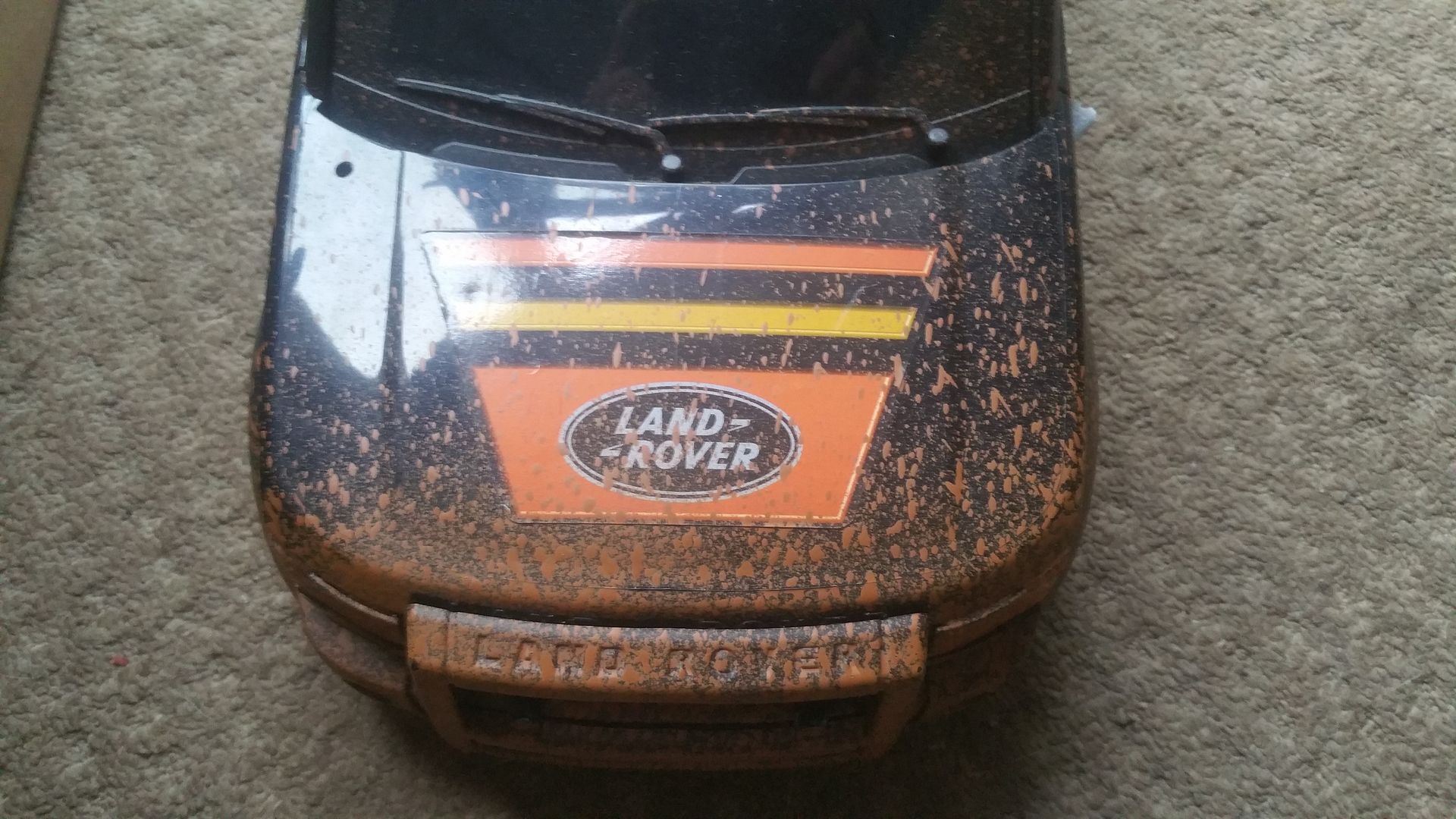

Shell arrived in great nick, only flaw is the fake mud splatter.
took all the bits off the shell to prep for painting, few ways to remove the mud but couldn't get hold of the best product so good old fashioned wet and dry to smooth the body down, primered and ready for painting at the weekend

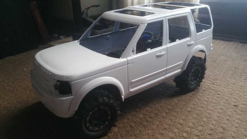

test fit on chassis
This is my 3rd disco build so I know a few bits I definitely need to do, one is wheel arches will need a trim to allow suspension to fully flex
I'm also thinking of removing black windscreen and front windows to replace with clear lexan so I can add an interior...... Maybe:D

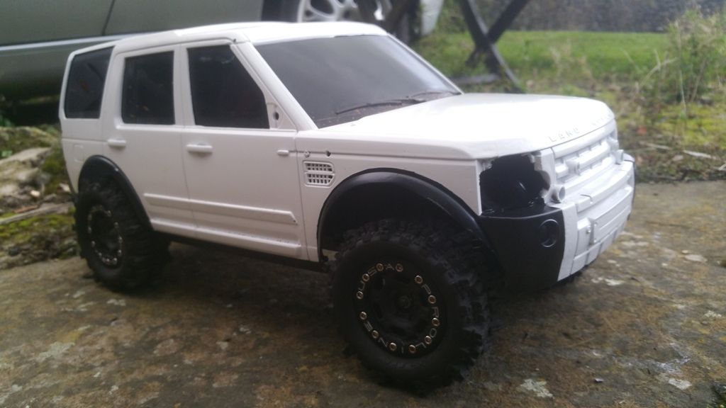

Masked shell up and sprayed black bits
tried to clean the headlights but completely shot and beyond repair so going to attempt to make some new ones. Never done it before but everyday is a schoolday :D

Made some new headlight lenses from a clear plastic drinks bottle (cheaper than lexan!!) Plastic lamp guards beyond repair, practicing a few ideas but for now, made a surround from trusty bottle and edged in black :D
grill sprayed black, nudge bar added and fitted rear light clusters

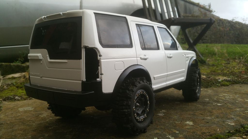

Busy with work and haven't had much free time lately to progress things. Also the paint I used to spray the shell white was from the bargain shop and was terrible so took the details off and resprayed a slightly different white..not that you can notice!! :)
The black wheels were borrowed from my other disco so sourced some 5 spoke and painted them silver.
