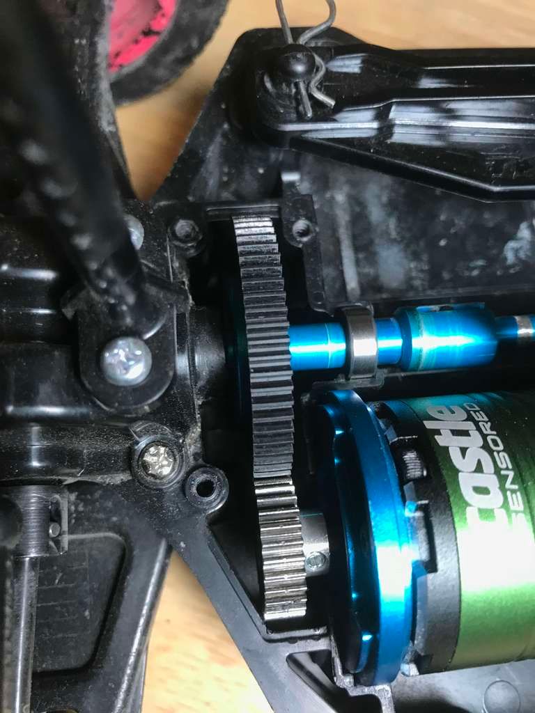

The motor is a Castle Creations 1406 series.  4600kv 100,000 rpm.  The esc is the Castle Sidewinder 3.  Waterproof brushless unsensored.  Odd since the motor is sensored and the ESC that is bundled with it is not.  Guess that's to keep the price down.  It was $109 for the combo at the LHS.  If you have a TT02 Series Tamiya in any version B,D,T(not that anyone wants a truck with that FDR) or plain, it takes $20 worth of parts to make it a 70kph+ RC.  All of these parts fit in the stock Tamiya Chassis with no modifications.  That does not guarantee the rest of the car will hold together but these parts give it the capacity for that speed.  These are TamiyaUSA prices. I found most of them cheaper elsewhere.
High Speed Gear Set - https://www.tamiyausa.com/items/radio-control-parts-70/hop-up-parts-72000/rc-tt02-high-speed-gear-set-54500 allows the use of any sedan style spur gear.
64t Spur Gear - https://www.tamiyausa.com/items/radio-control-parts-70/r-c-spare-parts-71000/rc-tb03-06-spur-gear-(64t)-51356  I chose this as I was attempting to stay full Tamiya for my build.
29t Pinion - https://www.tamiyausa.com/items/radio-control-parts-70/hop-up-parts-72000/rc-ff03-06-module-pinion-gear-54229 This drops the Gear ratio down to 5.74 according to the chart that came with the high speed gear set
I will have to run the numbers for a theoretical top speed formula when I get time.

Dude what's the lowest spur and highest pinion combo that will fit the TT02 with the High Speed gear set.
I see the high speed gear set comes with a 68t spur but you are dropping down even further with a 64t spur and using a 29t pinion... you got the adjustable motor mount too?

In my quest for staying as true to Tamiya as possible a 29 tooth is the largest they make that will fit. It even has mounting holes in the stock motor mount for that pinion. I have read a 31t will fit but I don't see how without shaving a tiny bit out of the gear box cover. I used the Yeah Racing adjustable motor mount in case I decided to abandon my mission to use Tamiya gears.
Just checked my TT02 and it's got the stock plastic motor mount and 22t pinion, my high speed gear set arrived today.

The high speed gear set has instructions for which holes to use. It's broke down in a chart for the 64t, 68t, and 70t spur. Then depending the size pinion which holes to use in the stock mount.  It shows from 16t-29t. Everything else requires the YR motor mount.  Then you just slide the motor over in the mount and manually align it to the spur.

The motor mount still has room for a bigger pinion but yeah it'll catch the gearbox unless you shave some off.
