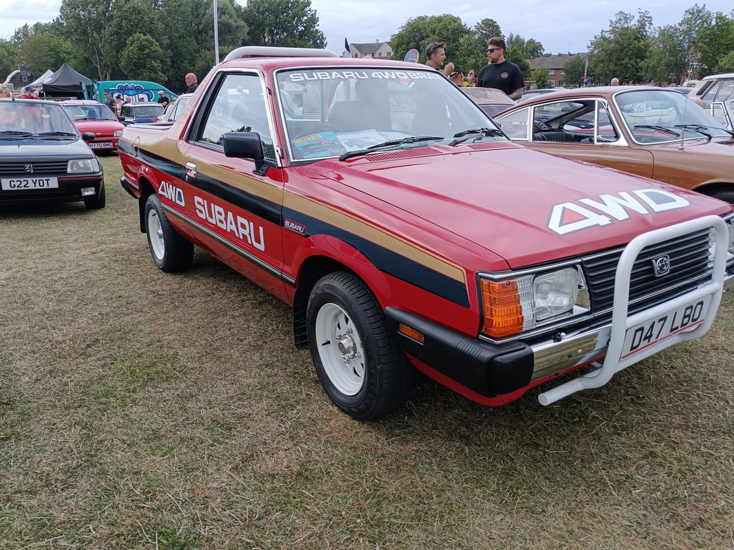

spacer.pngWell as a quick update, I still own the pick up. Coming on 13 years. Not done many miles though and it's still less than  38k from new. new updates include front a bar finished and painted, rear roll bar fitted. Brand new old stock front and rear bumpers fitted. If any Australia or US TC fans can help, i need the rear steps for the side body (os is fake, ns is a fold out step) and a pair of RHD power steering pipes in either usable condition or good enough to be copied. Thanks all
