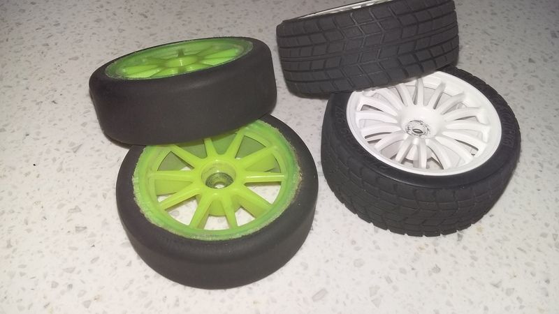

The best thing i've come up with is the GB01 Fox wheels, which are 20mm wide in front and look very similar to an 037 wheel, but I haven't a clue what diameter they are:

Back 15-20 years ago there was some touring car wheels and tyres made that were thinner, approx 18-20mm wide. I have some but I don't think there is a brand name on them, so that probably won't help with your search. I will go look for them..
8 hours ago, berman said:
They are the fluro ones, white ones are standard tamiya.
Very interesting.  I will continue my search.  Thanks for posting.
Tamiya Team Hahn Euro Racing truck (#58632) tires (Dia. 70mm) will fit the GB01 rear wheels. In order to make them fit the GB01 front wheels you need to narrow the tire a bit (EDIT: I have reasons to believe front and rear wheels are the diameter).
How to make the wheels fit 12mm hex, I for one do not know.
Hope it helps?
