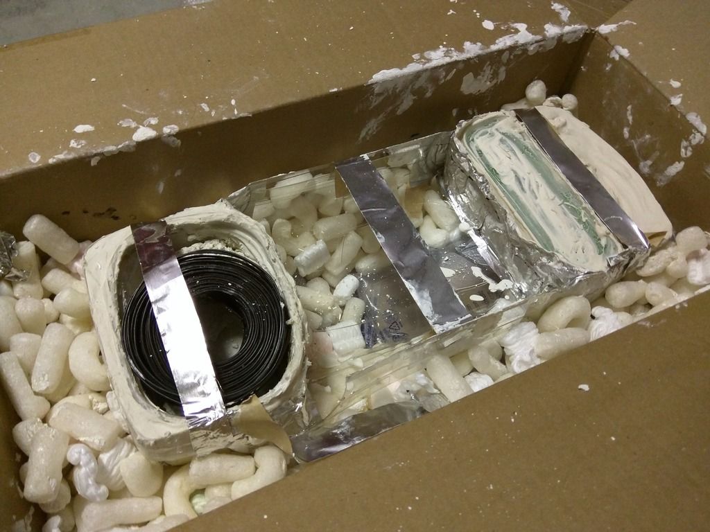

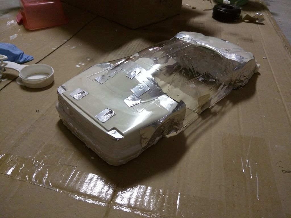

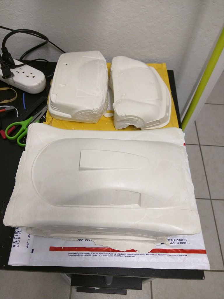

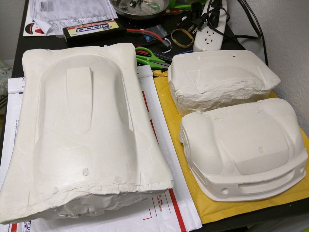

I just wanted to share some photos from earlier this year.   I think that some of the greatest Tamiya bodyshells won't ever see a re-release, which is a shame because they are simply a wear item if you run your car.  I started with the CLK GTR TGX body (because it already has lots of body post holes and it's cut out, more challenging).   It looks like a simple 3 part mold allows for undercuts and elaborate front and rear clips.  I tried the same thing with the 911 GT1 a few years back, but tried to do it from a single mold, it didn't work.
And FWIW, if you have an uncut CLK GTR body, I'd like one.  Filling the wheel arches proves problematic.
*note: i have no intention of making anything but a runner copy.
Inserts to fill volume, make the mold not so wasteful.
Also note the body shape tries to expand, another reason to seek out an uncut body.
thats an awesome attempt there. I've done similar and used wet river sand to support the body, it packs in to hold the entire body and holds firm very well. That likes look plaster you are using, which I initially used, but I might switch to hydrostone for bodies I want to last longer. I've found the plaster is very prone to getting damaged easily.
