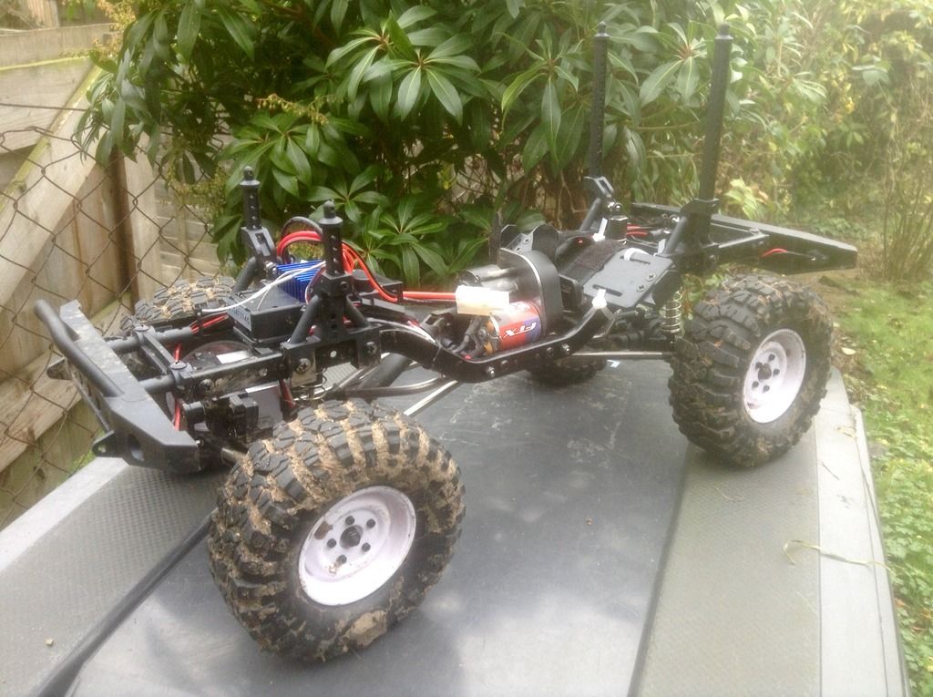

The Treka comes with a slim line 1500mAh NiMH battery (bit like in a Tamtech,with a mini Tamiya connector)running a 370 type motor,rather than the high turn 540 we usually see in crawlers.

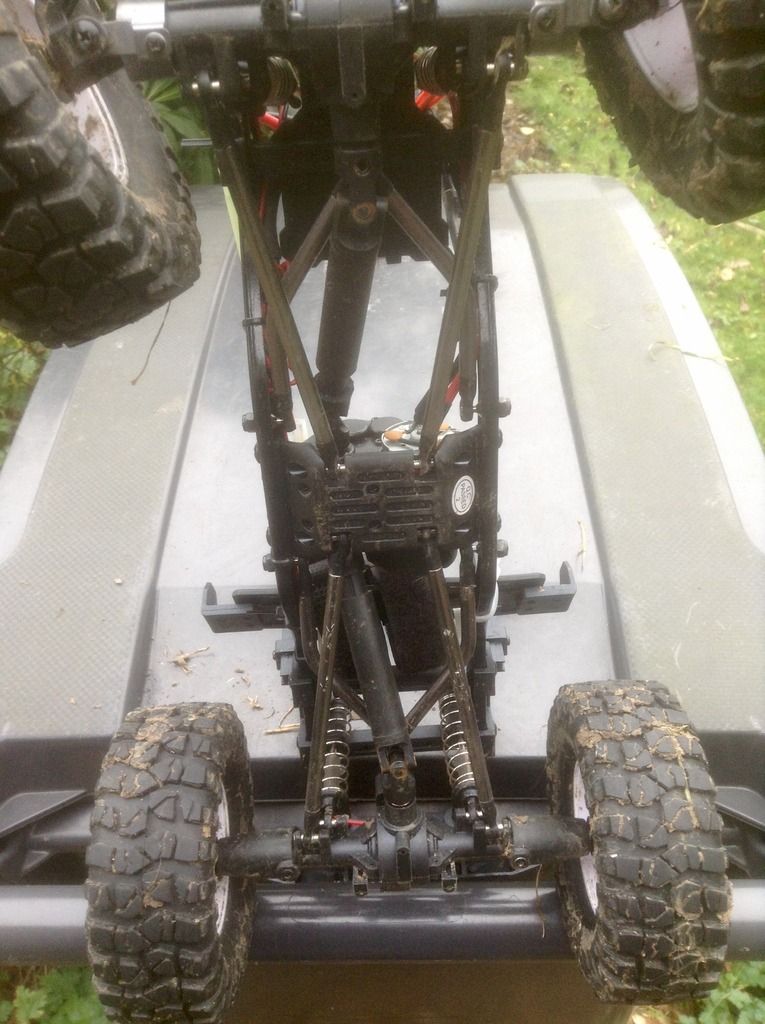

The battery tray sits between the rear suspension uprights. The reciever and speed controller are a combo unit,with an extra port for LEDs,or a winch. You also have option of running on LiPos.

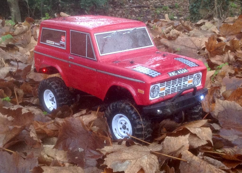

As you can see from the first photo,there's LEDs built into the front bumper,and red LEDs in the back bumper. Tyres are soft and very grippy.

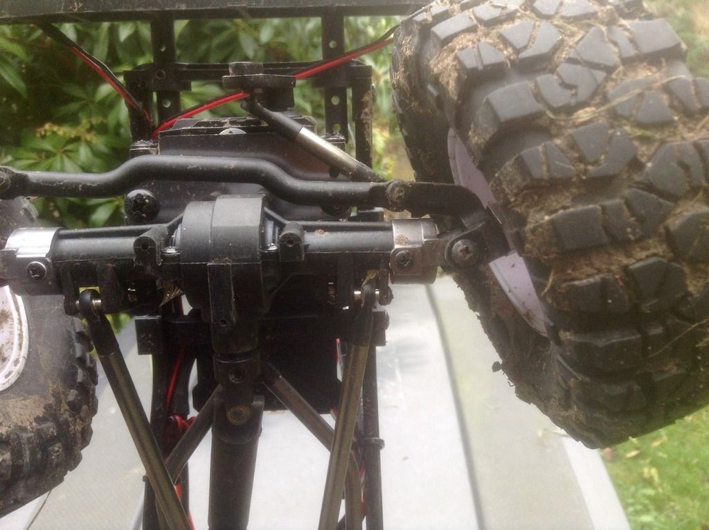

Both diffs are locked as you'd expect. Steering lock is pretty good,but as the pic will show,there's potential for more travel by trimming back the tab,just as you would with a Maverick Scout.
I trimmed the tabs after taking this photo,and the turning circle becomes much tighter.

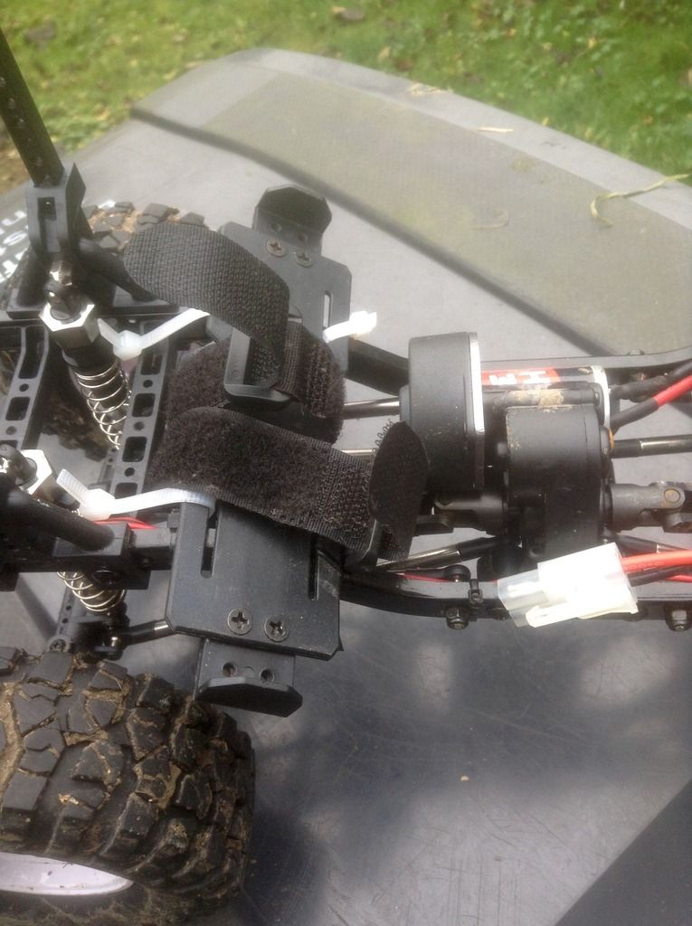

As you may have noticed,the battery tray isn't between the rear suspension mounts😉 The stays on the tray can be set to hold either the Tamtech style battery,or for the usual 6cell 7.2v stick. I didn't much want to use the smaller battery(apparently it'll give 30 minute run times),so I relocated the tray to a lateral position. No great feat of engineering,but as long as you've got cable ties to hand,it's quick and cheep to do.
The other thing I'd wanted was the try move the battery weight a little lower in the chassis. There's space to mount it over the front axel,in front of the electronics,which might be a better choice.

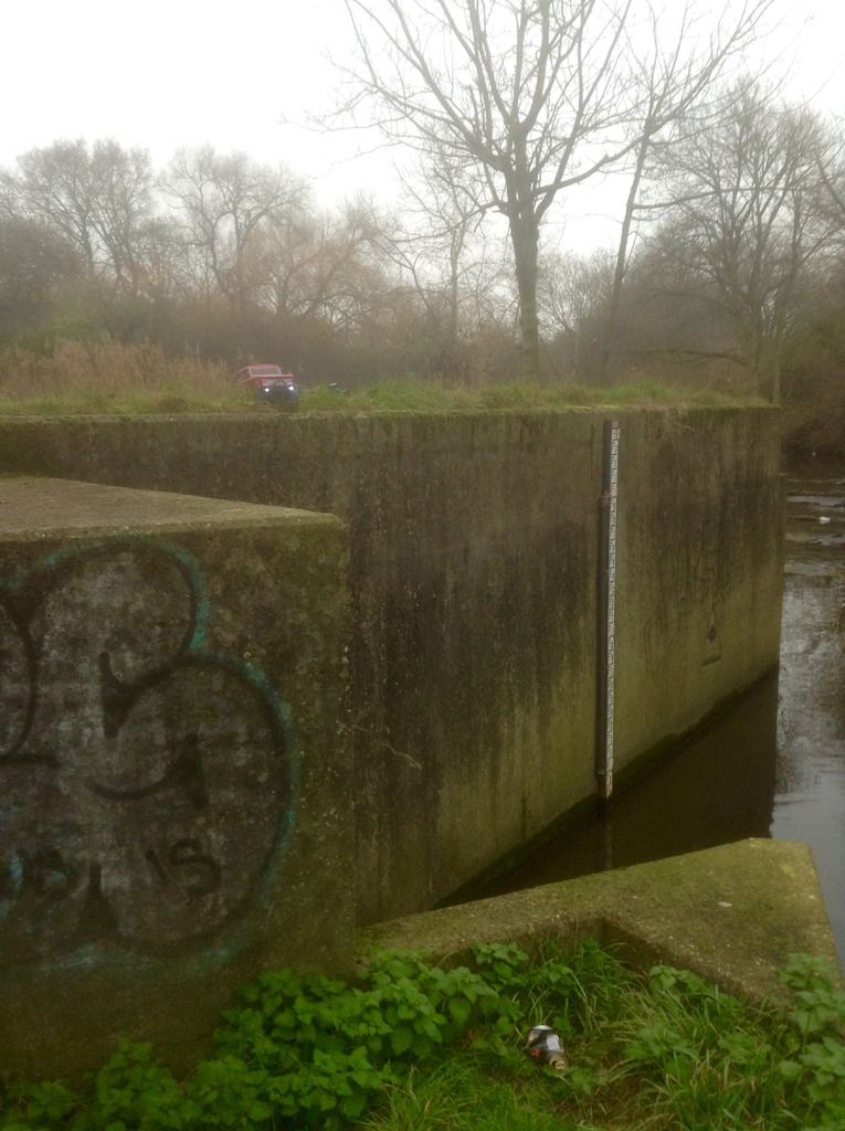

Being the idiot I am,I'd reversed the Treka clean off the edge of this culvert,trying to set the iPad up for a video. I'd had to wade in to recover it(there's a reason I wear wellies😉) The drop,and spending ten minutes underwater didn't hurt the Treka at all! Gotta be impressed aft

Well,we've done a bit of work since the last post. The steering mod I'd made had improved the turning circle,but introduced a glitch in centrering the steering after full lock to the right. I've cured that by fileing out 3mm from the servo mounting plate.
