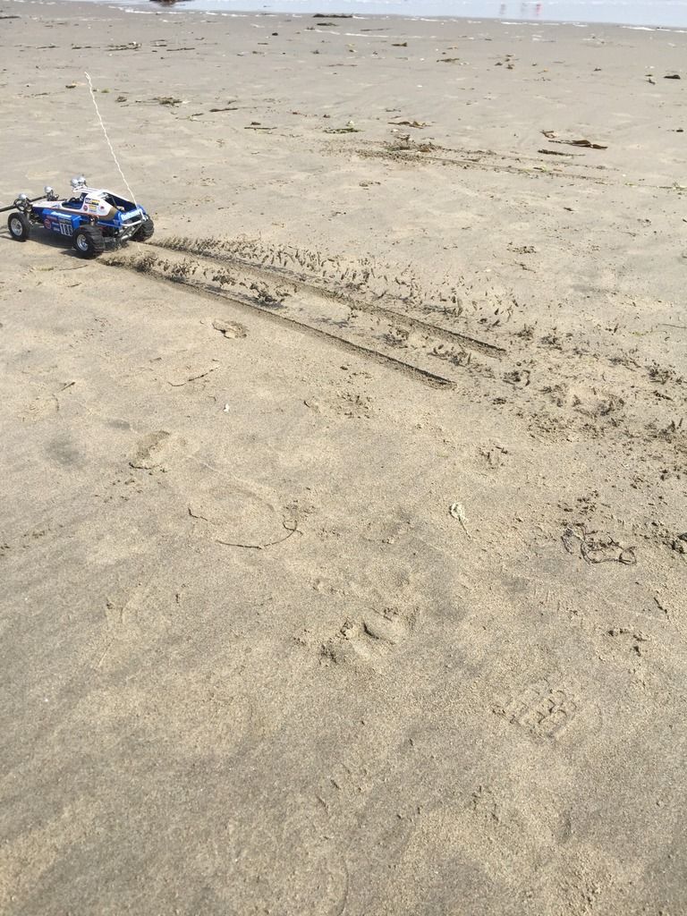

Here is a burn out to inspire you to get your scorcher to the beach
05935EC0-370E-4BF2-9042-333CF50131CF_zps

Yes Matt.
Unfortunately  it wasn't as successful as I hoped.
The electric's failed. Haven't gone through it but either the Quickrun or motor let go. The small 3S battery is a suspect too.
Apart from that it was not bad on the beach at all.
