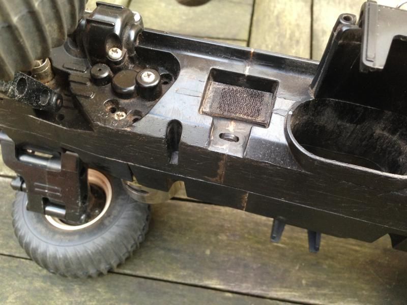

Here's the join where I shortened the chassis.
27C4D5B6-85D9-40E6-9B16-18EDF6E96E5E_zps
Wow. That's one neat, clean & tidy looking join. I tried shortening one of my TL01's and tried to be as tidy as that... but I got impatient while cutting and ballsed it up. :D It didn't look too bad but, in the end, that project got shelved.

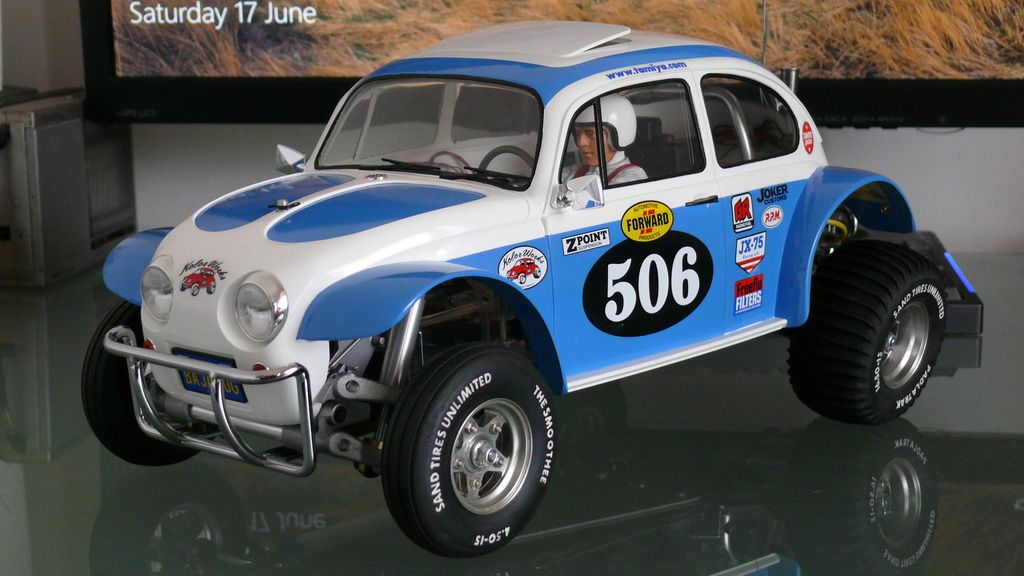

I've painted the body shell, but wasn't very happy with the outcome. Yes, the paint went on nicely, but it just wasn't really what I wanted it to be. When I pulled off the masking tape for the two-tone effect it pulled patches of paint along with it, and the masking tape itself had leaked in various places.
@Fuijo came up with a great solution to tidy up the lines a bit; which is to put a small, thin tapeline in between both colors. This turned out to be a very good solution (thanks! :D ) and it really helped the body shell move along again, after being stalled and parked in the 'someday' corner of my desk.
So of course I got all inspired and made this:
This is:
- Tape line separating white and grey.
- Door handles and window frames colored in with a detailing pen (this is far less messy than painting it, and creates a similar finish and effect)
- Black line tape around the bottom step.
- Various details like the fuel filler flap and air vent slots on the rear deck highlighted.
- Shut lines marked out with black detailing pen.
