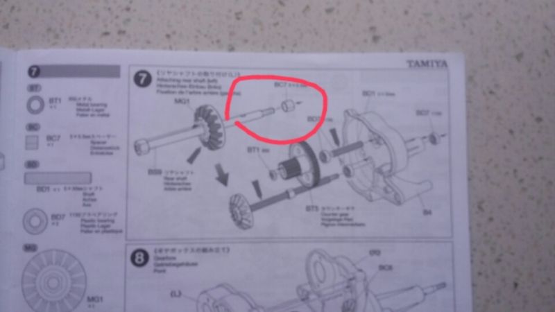

There is a little spacer that goes over the axle shaft on one side before you put it through the gearbox, have you made sure it is on there? Otherwise the diff bevel tries to move away and rubs against the counter gear causing it to slip.

Also make sure the diff carrier pin is there:
Took it all apart and found two things. One, that diff carrier pin IS missing.  And I found one of my rear axle holders was broken at one of the screw points.. this lunchie is giving me fits!
